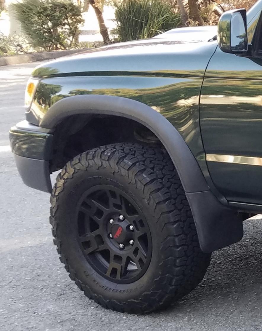

Here's how mine currently is. 3D printed short caps, Rally Armor universal mud flaps (normal size, but I'd like the 'long' size they used to make):
-Charlie
