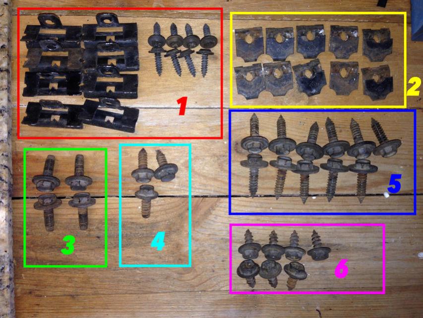

Here's the hardware for the SR5 flares, I found this on an old thread when helping out a friend get a set mounted up. The door clips/screws are in box #1. The clips fit over edge of door, providing screw holes for flares to be mounted. Boxes #2 and 5 are for rear flares, but machine screws/nuts can also be used.

Damn, now that is some extremely detailed information and is extremely helpful. Thanks for that, now I know what to look for if I can ever find a set of flares.
I promise this will be my last question in this thread. In the photo above, does anybody know what the little eclipse are in box number 5? Where do they go? I actually saw a set of these flares in the junkyard, and there weren't any of those clips on the rear flares and it didn't look like they had ever been removed previously.
I have 2 trucks with these flares, both used different mounting hardware. Depending on what your truck came with originally you might need to use alternative mounting hardware, like I had to on my SR5 base model.
I used these for the rear flares since the "stock bolts" were much bigger than the grommet inserts in my fenders
Amazon.com: Mtsooning 20 Pcs/Set Universal Car Auto 4.8x19mm Self-Tapping Screws Captive Loose Washer 8mm Hex Head Black Hot C45 : Industrial & Scientific
I wanted something with a large, captive washer that would fit snugly into the plastic grommets, and they worked great!
