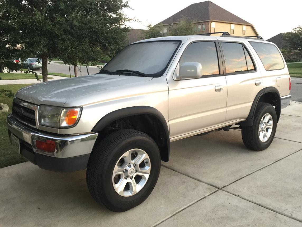

To answer the op.
The answer to this is anything is possible but would not be easy. The Limited flares body cladding is attached with plastic clips that are attached with Squares and rectangles in the metal body of the fenders and doors. These are about 1/2inch each and would need to be patched/welded and would be quite a job+repainting.
Long story short look for a SR-5 model with these flares. They just un-bolt and can be taken off.

So it came with those thin plastic and crome fenders, and I whant to replace those with the ones in the picture posted by Kram 1976, does anybody have some for sale or parts numbers so I could search for them ?
