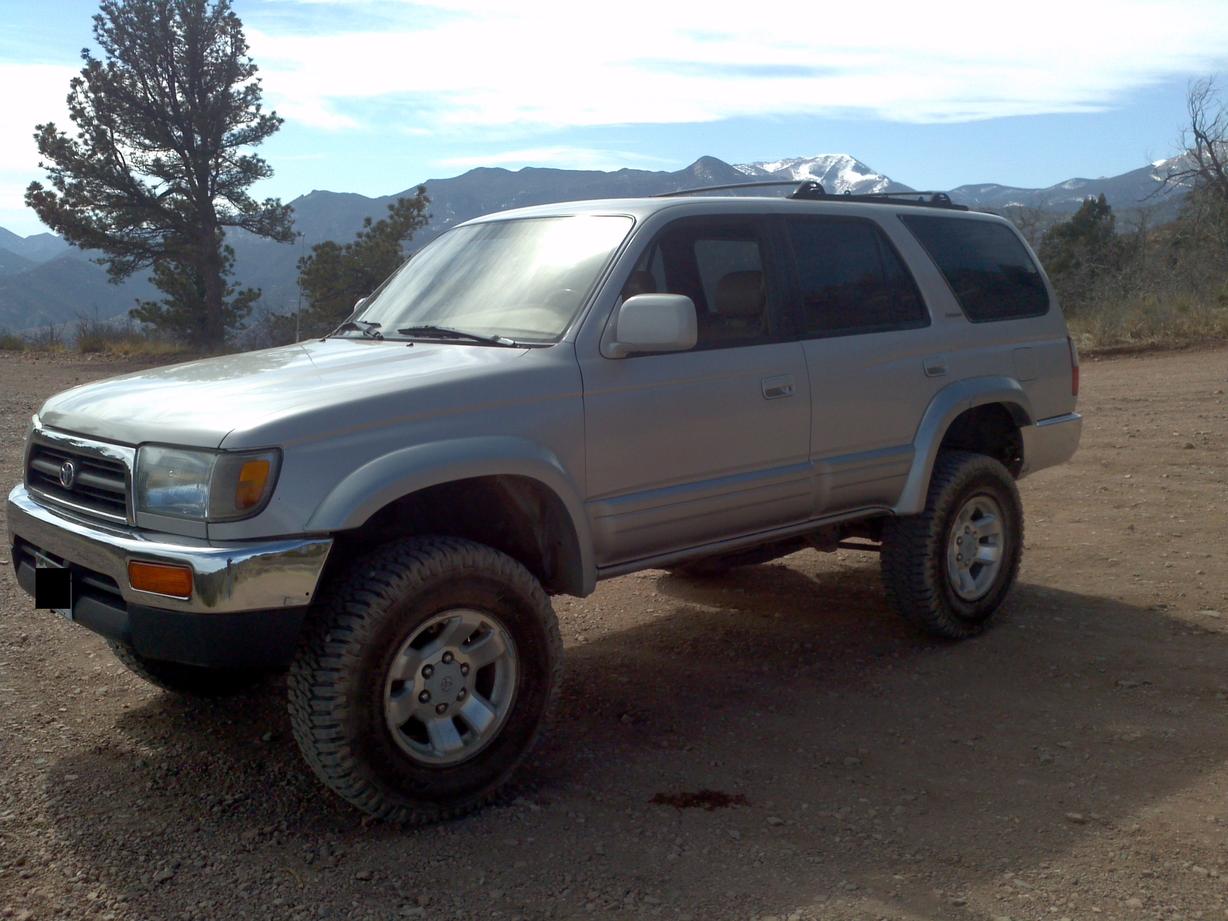

dont want this
I just see them getting destroyed really fast and don't like the look of them
Do they really look that terrible? That truck above looks pretty good to me. If the owner ditched the running boards, ditched the "fat-lip" 99 style bumper for a 97 style or ARB, and finally he added a $1000 COIL lift kit, I think it would look awesome.

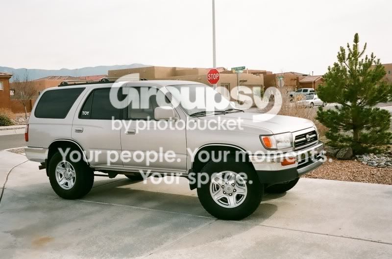

The ones on your truck are SR5? I always thought those were Limited flares for a 99-01 model.
757ce172.jpg~original
I guess I learn something new every day. I prefer the doors to be bare as well but I like the flares around the wheel well.
BFAD,
Yep. Mine is an SR5... Sport Edition. The 99-01 Limiteds have flares just like yours, and the ones in the picture that the OP put up.

Just to clarify: SR5's were available with 3 different types of fender flares....
Chrome Strips
mine.jpg~original
Skinny Blacks (Brian2Sun's Rig)
0906101810a.jpg~original
SR5 Wides
All three of the above options could be referred to as "SR5" flares. The Limiteds, and the Limiteds ONLY, have the flares that include the door cladding. You will never see door cladding on an SR5 unless it was installed after the fact by the owner.

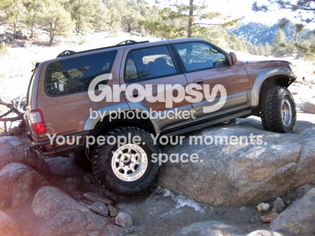

In my opinion if you don't like the flares, don't buy a Limited. Once you ditch the running boards and the front bumper it does look better though. Personally I like the flares, they keep the 4Runner cleaner. If I do bump something on the trail, it's cheaper to buy a fender flare and have it painted than to buy an entire fender (same with the doors and rear 1/4 panel). The paint on my 4Runner is spotless, but the flares/door cladding have multiple little blemishes and door dings; if anything they protect the vehicle.
