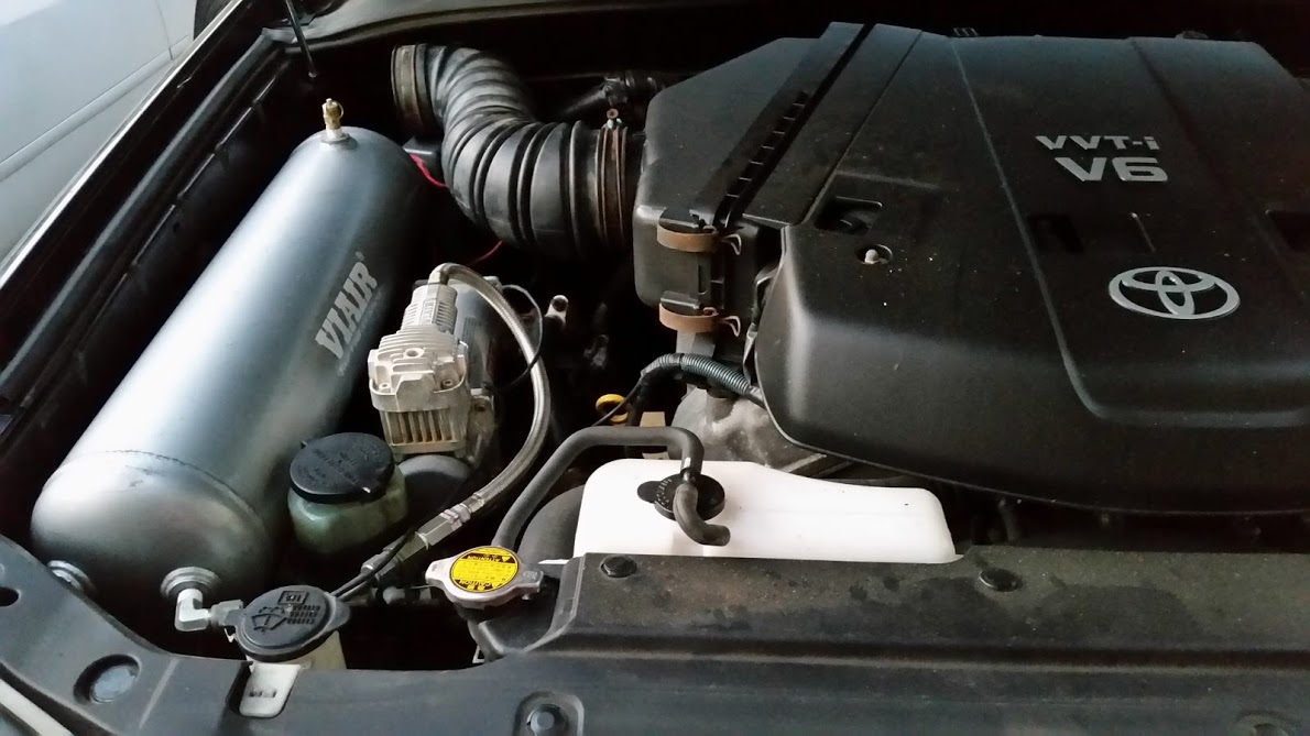

If you want to remove the inner fenders but are worried about getting water and mud in the air intake, you could place it where I did in the attached pic. I just rotated it 180 degrees from the factory location so that I could fit my Viar setup. Doing so places the intake opening in the engine compartment.

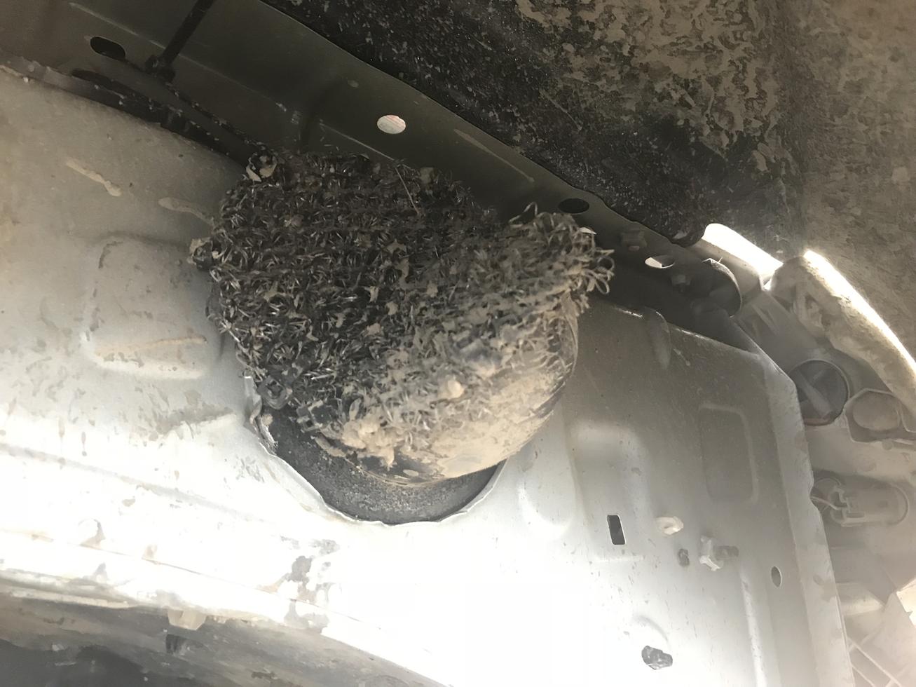

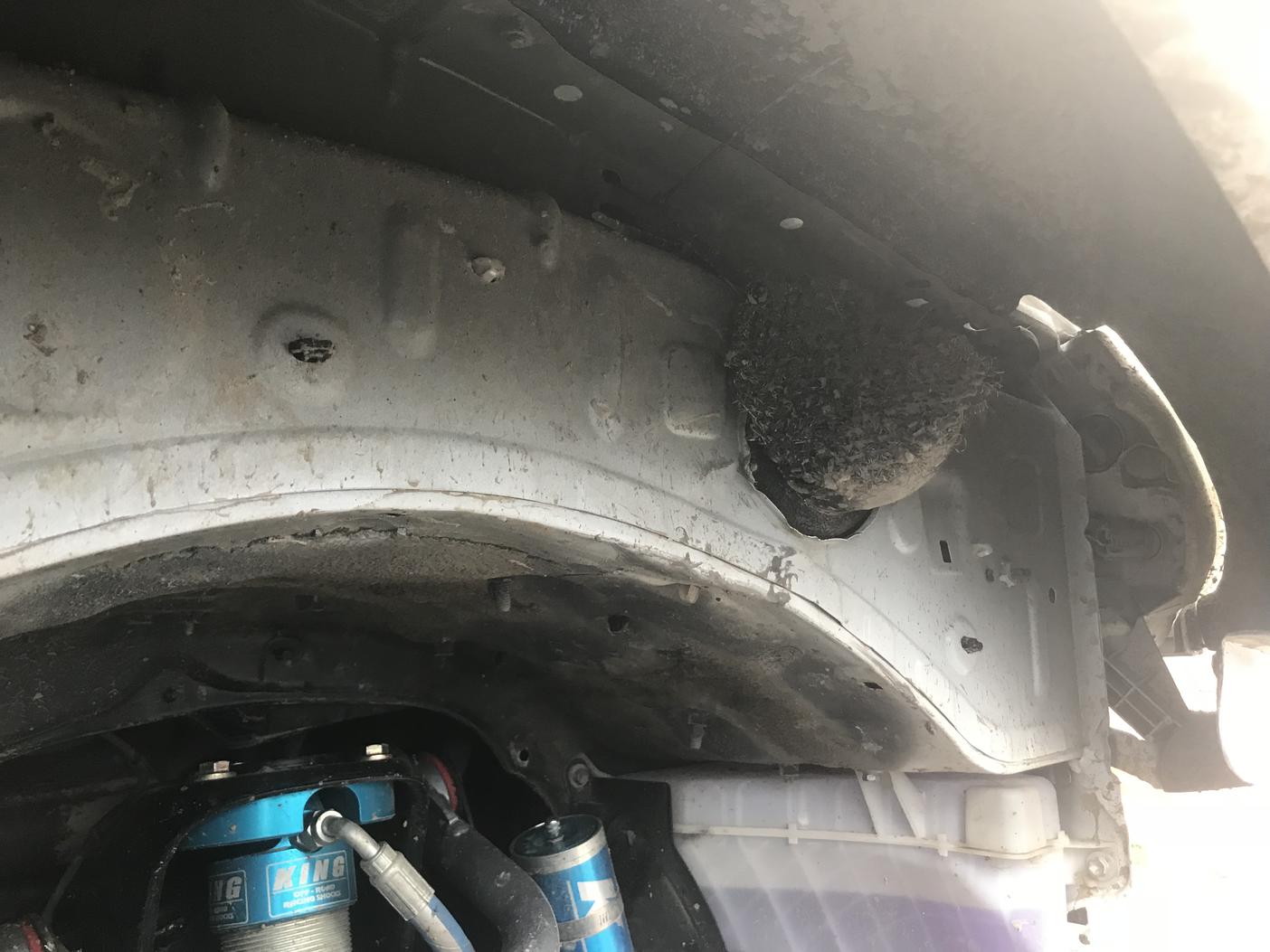

I have fiberglass fenders on the truck. I made a mold of the inlet with sone mesh grill and sandwich a stainless steel scrubber and set it in place. Seems to keep larger clobs of snow and mud out
That’s a good idea. Do you have a pic of that?
Heres a few pics, bit dirty..
