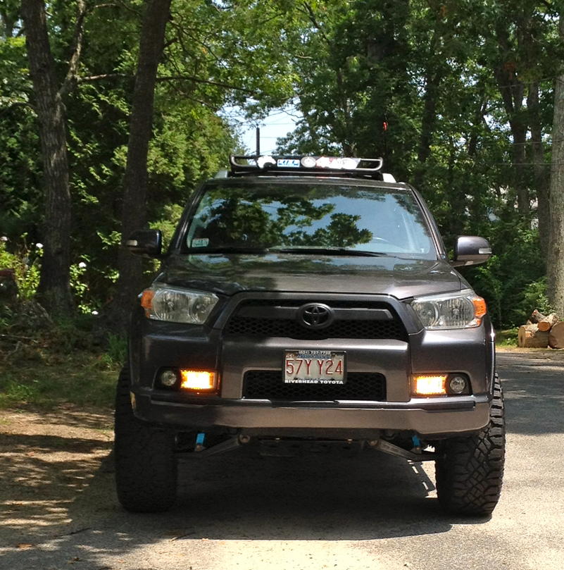

No one that I'm aware of has gone full 3.5" LT and big tires. In fact, the only 5th generation 4Runner that I know of that has done the full 3.5LT was Fox's SEMA Truck from last year, and that was on 285/70s.
The 2" would actually be perfect. I'm trying to imagine the 3.5" without having to fab up the rear for more travel. Thanks Fish, nice to see someone who has already done it. That looks real clean with the stock fenders, glad to know the tires won't stick out TOO far.

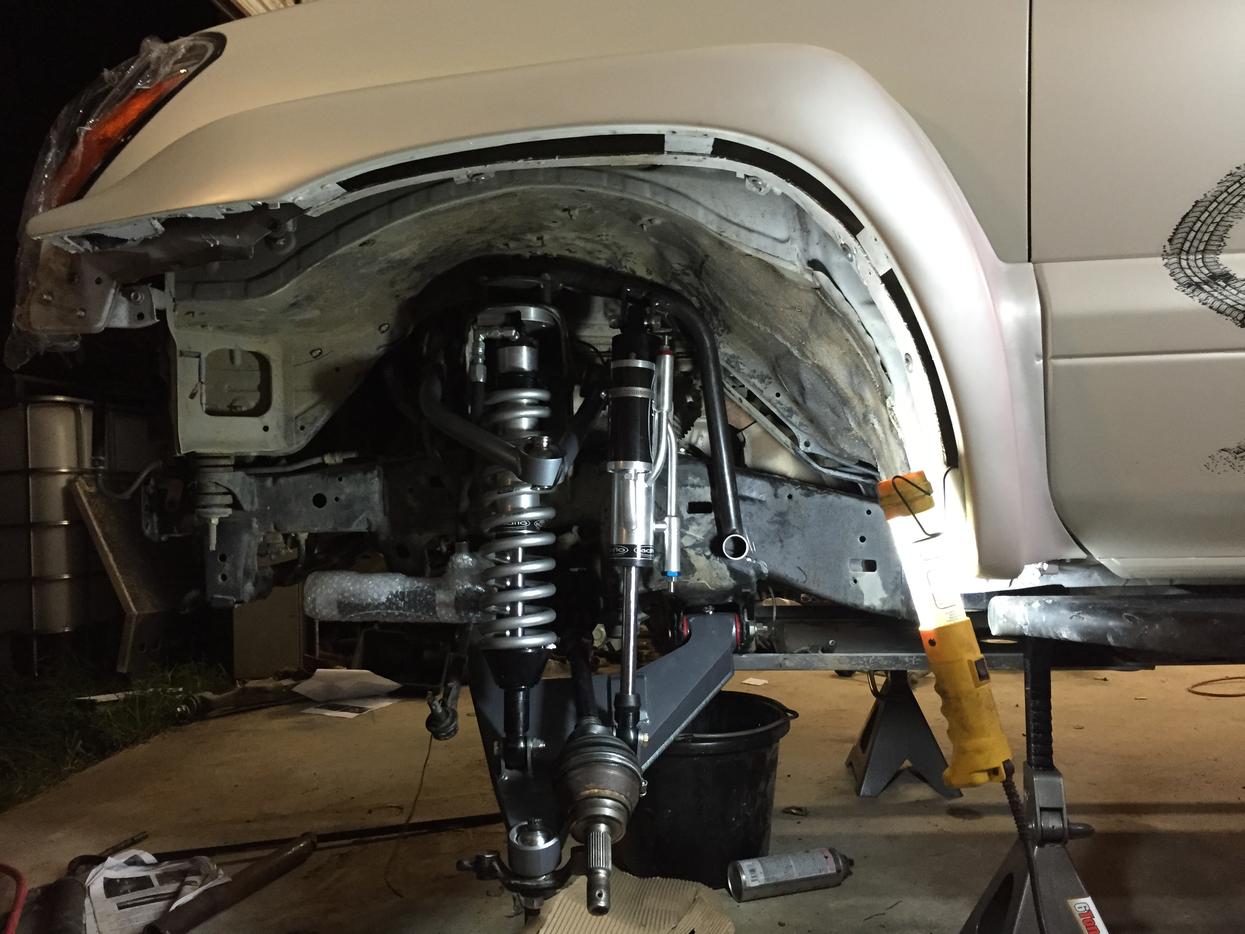

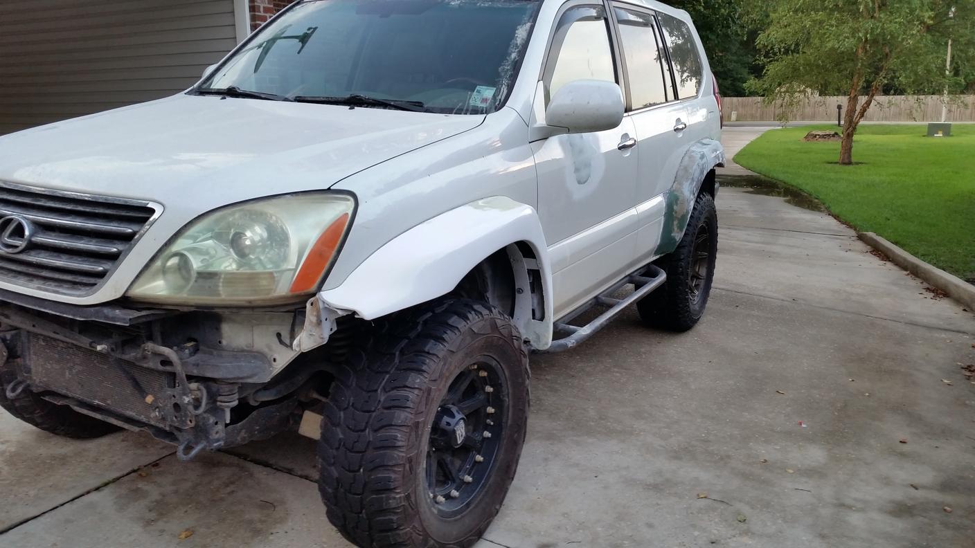

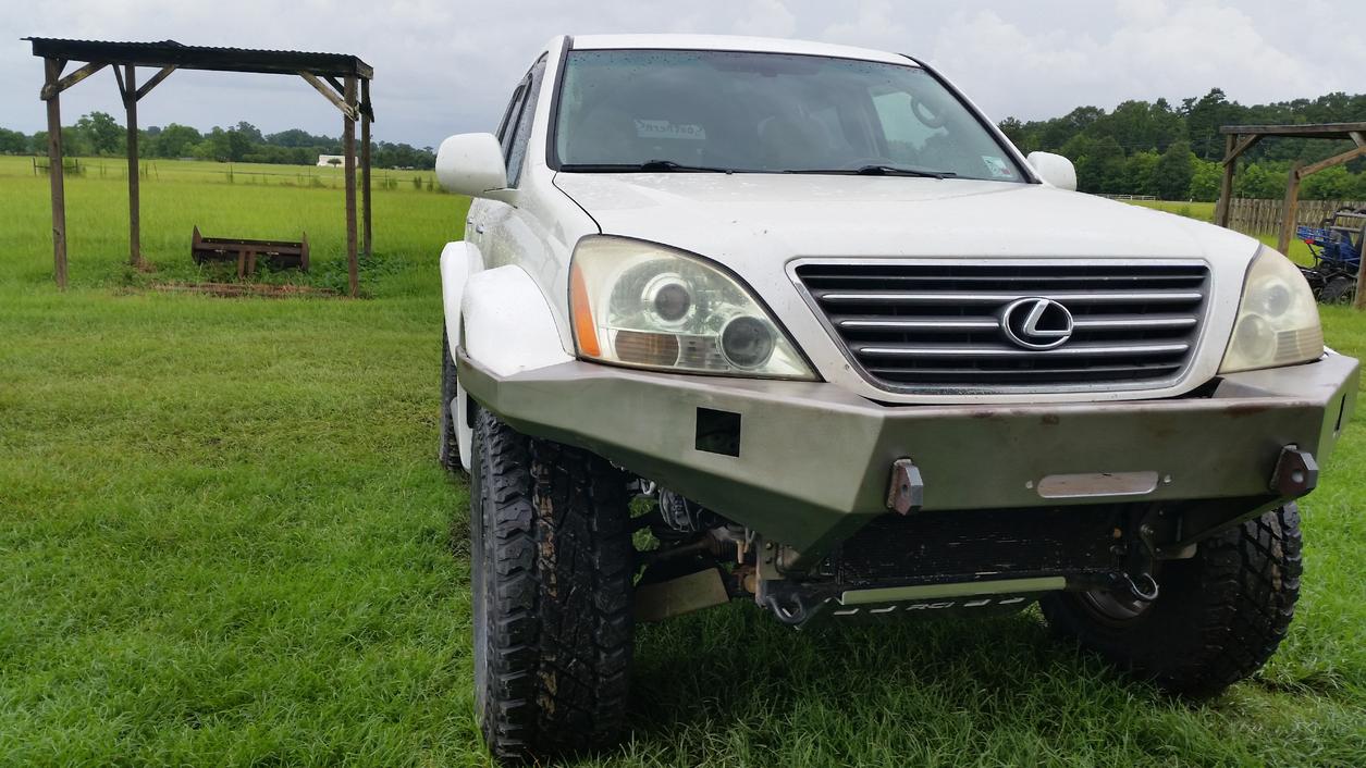

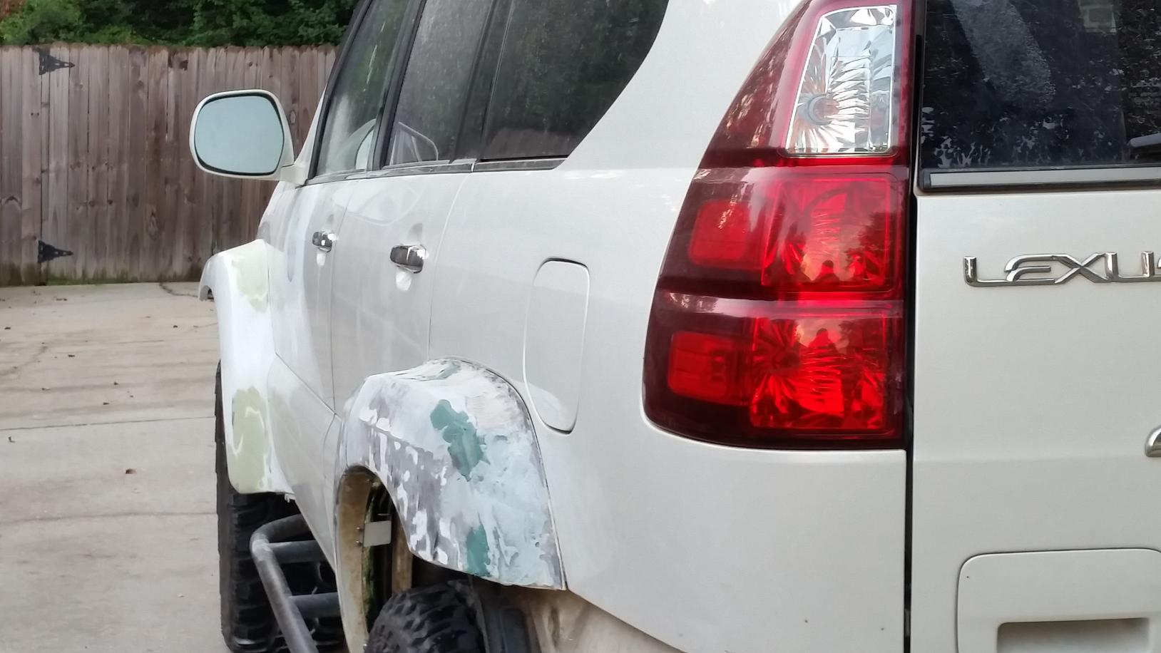

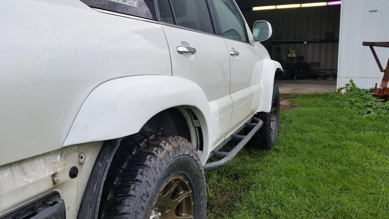

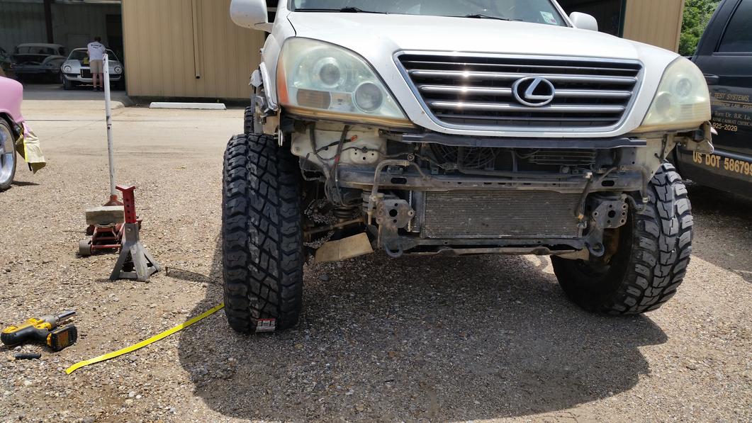

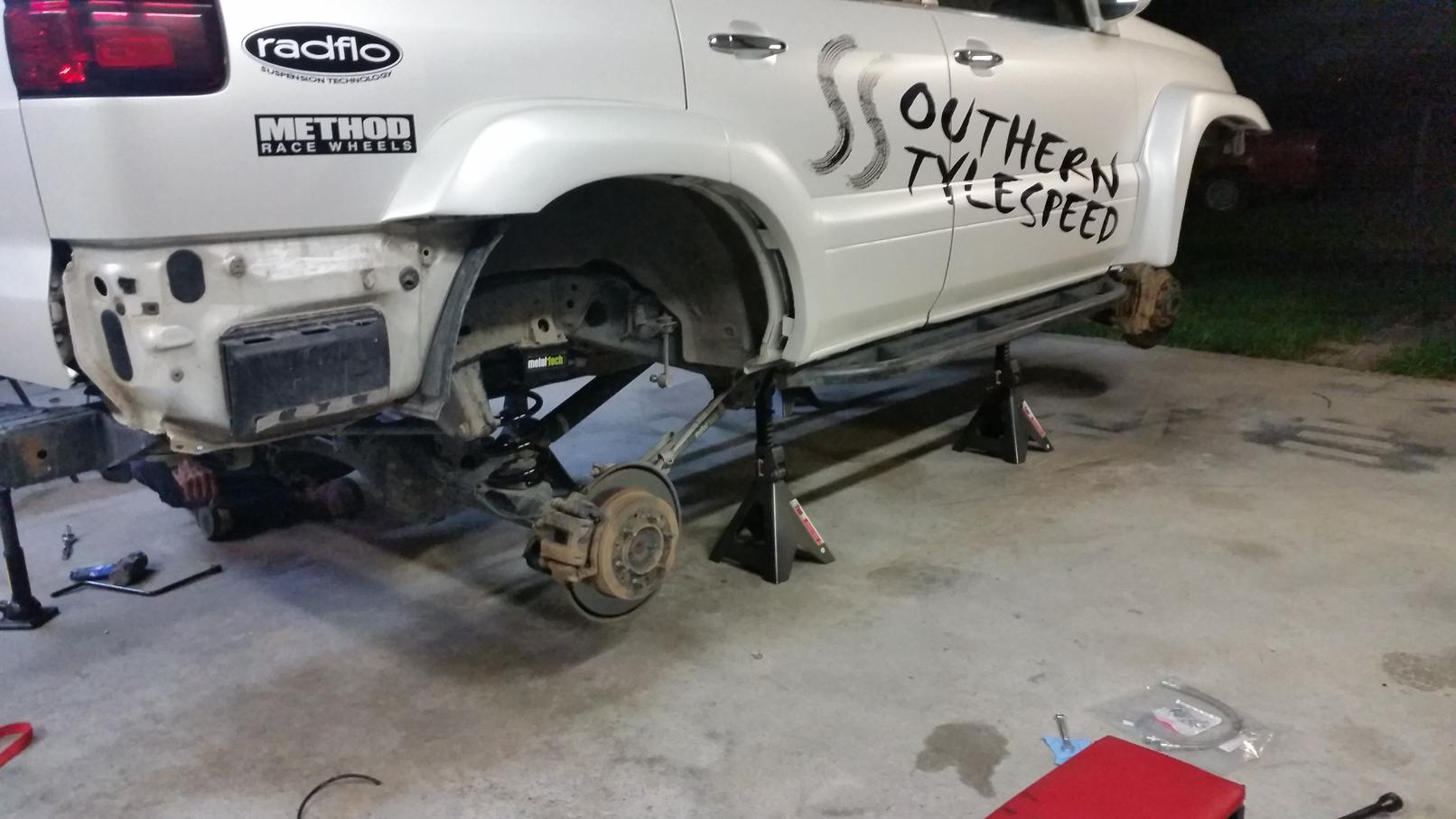

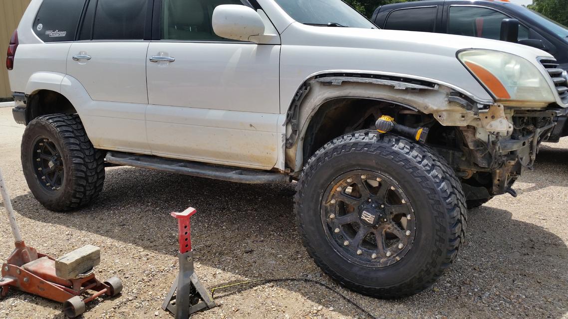

i Just finished up a long travel setup on my GX and I can tell you it costs ALOT for custom fenders. Also, if you dont plan on doing the welding and installation yourself, be prepared to chalk up at least $1,500 in labor. At least, thats what I'd think about charging.
Talk about a luxury rig! Diggin the Lexus man!
I'll be doing the install myself, and have a buddy fab up any gussets/skids.
