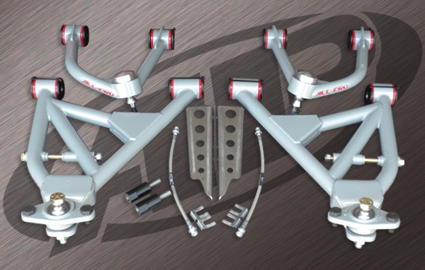

From what I remember on TacomaWorld, the AllPro LT wasn't nearly as common as the competition. Not saying it's sub-par, but I noticed it wasn't as popular. Not sure if it was because of AllPro's tubular LCA's vs the Boxed, the inability to run a secondary, or the accredidation of the company due to them being "younger" than that of TotalChaos, Camburg, ect.
