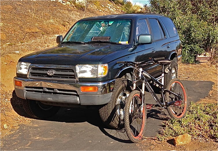

My Runner
Solar Panel to keep my battery charged!
