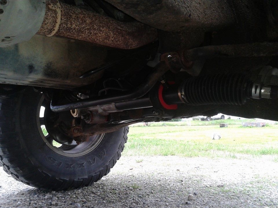

HA HA! Another non-salt belt guy... lol! Alright... here's the scoop... that's not all rust... ;)
Alot of that is years of oil and grease which I have applied over the course of the 10years of ownership. The orange looking stuff is rust... the rest is a thick coat of grease covered in sand and other road debris.
It looks disgusting.... but it's the only way to keep the truck from deteriorating too badly. There hasn't been a single bolt or not that I haven't been able to remove and re-use on this truck, unless it was part of the exhaust. ;)

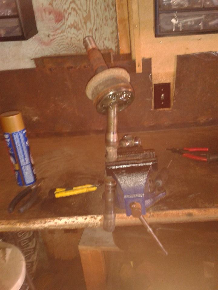

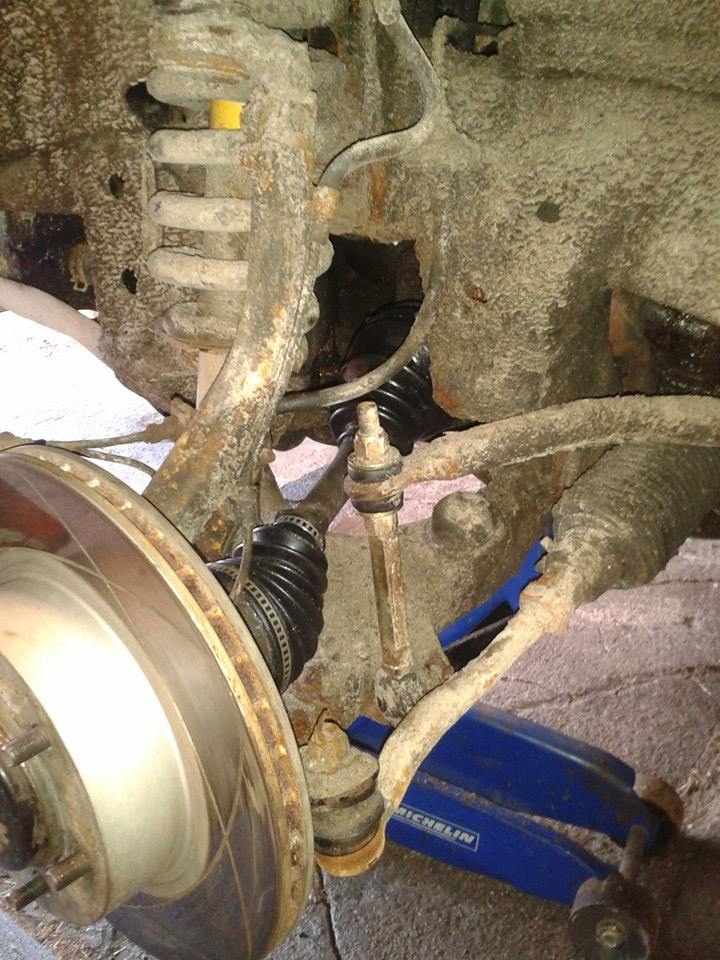

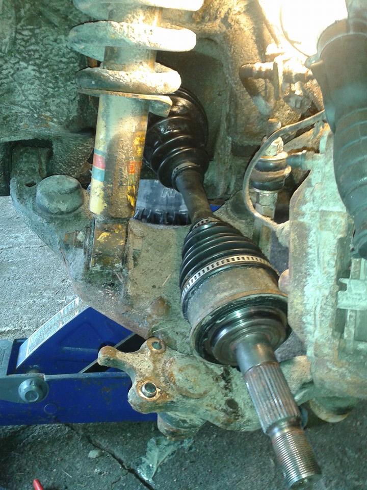

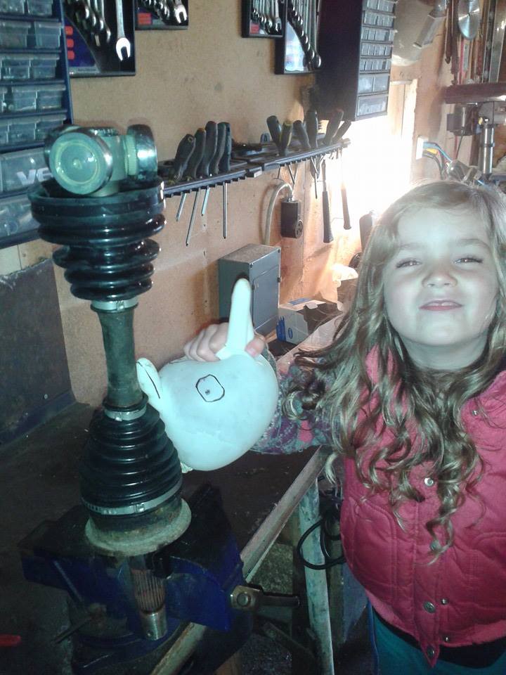

Well, while putting on those stabilizer links a couple of weeks ago, I noticed my driver side inner CV boot was torn, like my passenger side one was a month before.. :/
I ordered some new inner and outer boots, and decided to install them today. The process was the same, only when I bought a 30mm socket to take the large nut off the axle, it turns out it doesn't fit.... because this side was 35mm?? My best guess.... the passenger side was replaced prior to my owning it, which is why the nut was 30mm, rather than 35mm like everybody else's.
Anyway.... after I managed to get a socket from a neighbor... the job went smoothly.... and all is well in Mean Green Land... ;)

A new axle? I didn't do that for 2 reasons....
1) 2 boots is cheaper than an axle...
2) I figure, the axle isn't making any noises, all looked good internally, and Toyota axles have to be stronger than aftermarket. :D
As for the nose... yeah... she definitely needed a tissue... but that's what kids are known for.... being snotty! lol!

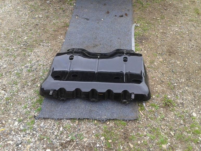

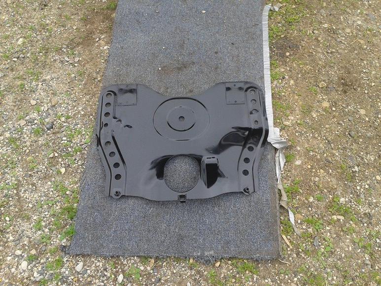

Painted the 4Runner Skidplates...
