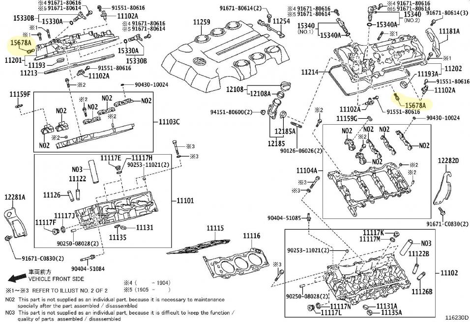

Hello all,
Locals (LC79 crowd - same engine as the 4Runner) are replacing these small VVT oil control filters as part of the maintenance regimen..
Found similar threads on Tacoma forums and the T4R 4th gen:
4.0L V6 VVT Oil Control Valves
Some guys on Tiktok with replacement video showing how bad they looked:
TikTok
Anyone have experience replacing these? Looking to add it to my maintenance list.
2016 Toyota 4Runner Filter. Oil control valve; oil control valve, left; oil control valve - 1567846020 - Genuine Toyota Part

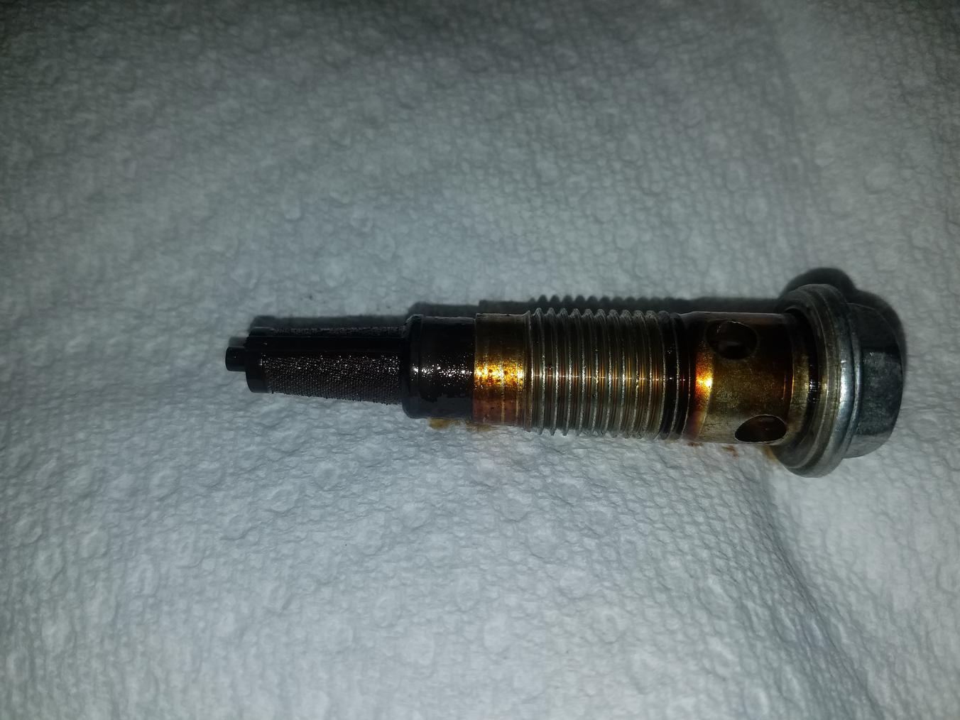

I have checked and cleaned mine several times. Many many miles ago, I threw a code that led me to look at the OCV. I found the screens clogged with sludge. I believe my issue was long idling periods in hot weather with a failed PCV valve. I cleaned them with gumout and put them back in, no issues since, been ~150k, and I check every once in a while.
I would not think they would need to be replaced unless the screens had holes in them. Let me know if you have questions. Here is a pic when very dirty. The cone shaped screen piece pulls off of the hollow bolt making it easy to clean.

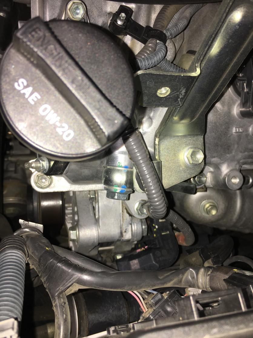

If you could post some pic's showing the location of these I would be very grateful.

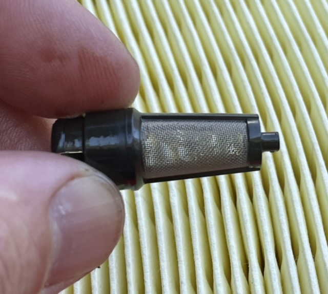

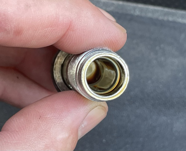

Thanks for this thread. It prompted me to check my filters as I have 216,000 miles on my 10.
They looks great!
Actually they don't. They're full of scale - see your second pic. I sure hope you sprayed them down with brake cleaner before reinstalling.
That was just some oil on the screen. I washed it off with brakekleen and reinstalled.

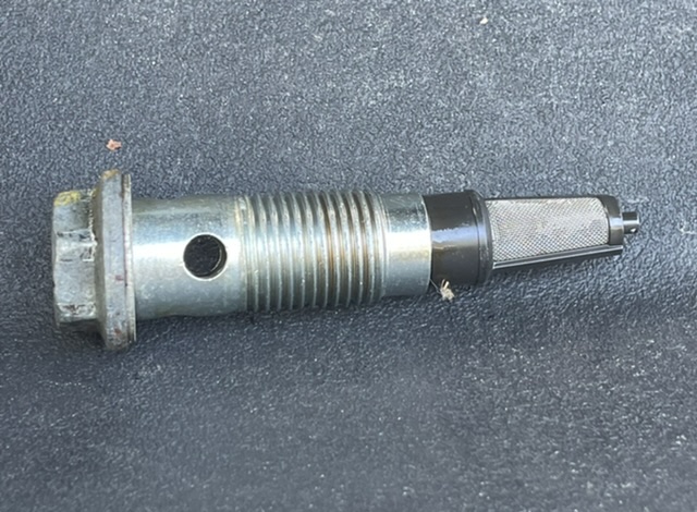

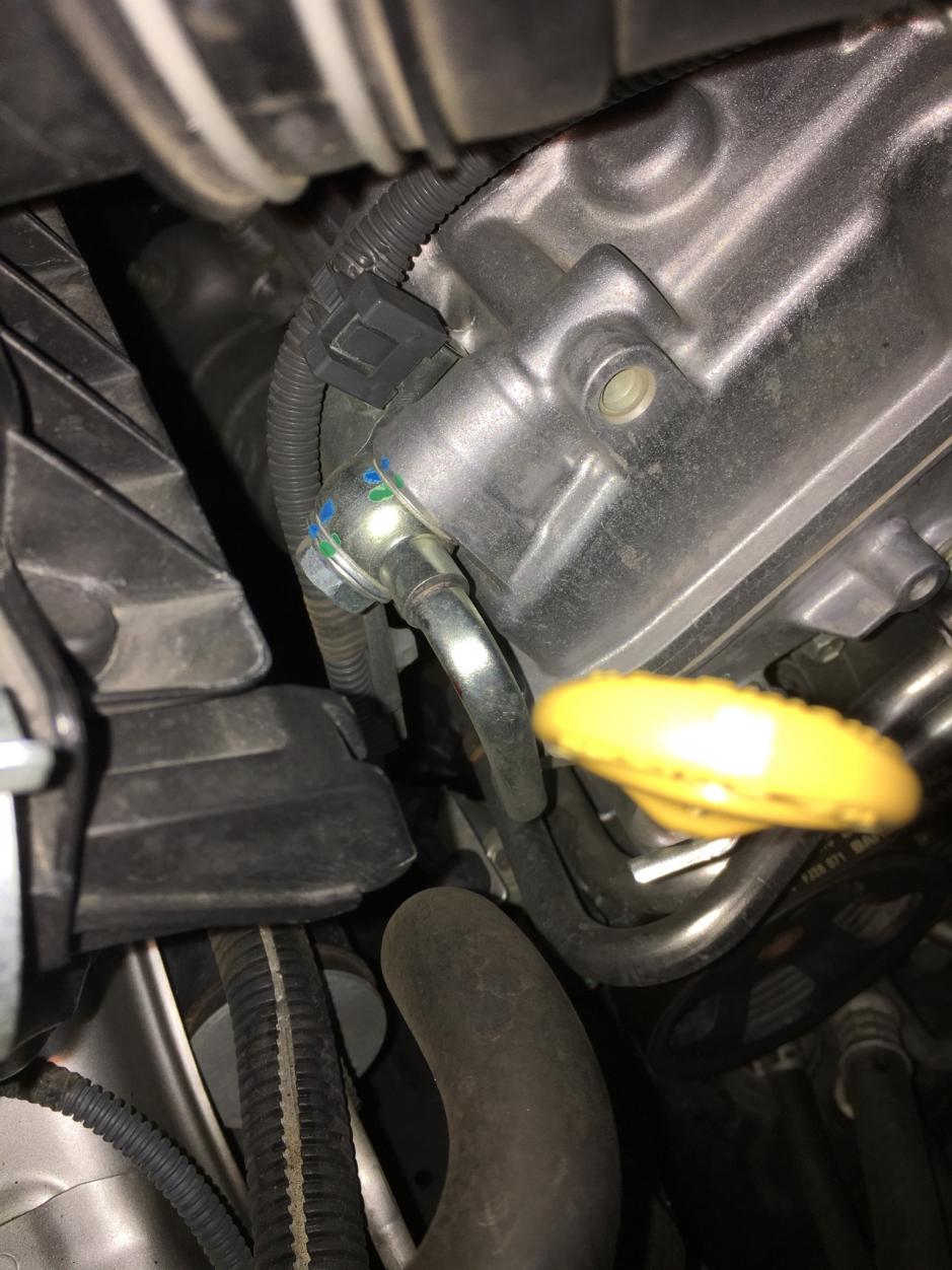

I’m assuming these are thems. Probably good to replace the washers if you’re into that sort of thing.
Anyone know if those have crush washers?
Yes, it has two actually, one on either side of the oil pipe. I've checked mine a bunch of times and never replaced the washer and had no leaks. I always make sure to torque it back.
