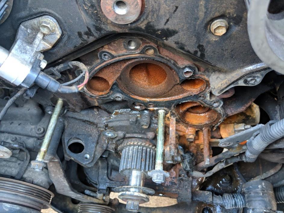

Let me see if I can find some pictures of what I had going on.
Does your sludge looking anything like this?

Color is the same, but the stuff in yours looks like it chips off in flakes. Mine looks like light surface rust. It looked like that under the radiator cap at first, but now I'm starting to see the metal again.
I'm thinking once it start's you're kinda effed. I think yearly drain/fills with coolant would keep it at bay once I get it somewhat clear.
Yup.
I think my brother didn't do a good enough job flushing out the tranny fluid which turned into the sludge. Over time, it hardens and looks like my picture.
