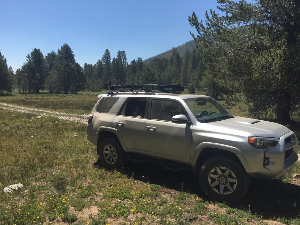

As another reference for those that follow, my lift ended up being Bilstein 6112 at 2.5" in front with Bilstein 5100 rear shocks. Used the Icon 2" Rear springs. Combined with KO2s 275/70R17, ended up with a 3.5" front lift and a 2.25" rear lift. With the 2" factory rake, leveled out nice.
Toured the Monache Jeep Trail this weekend with no problems fully loaded with gear.

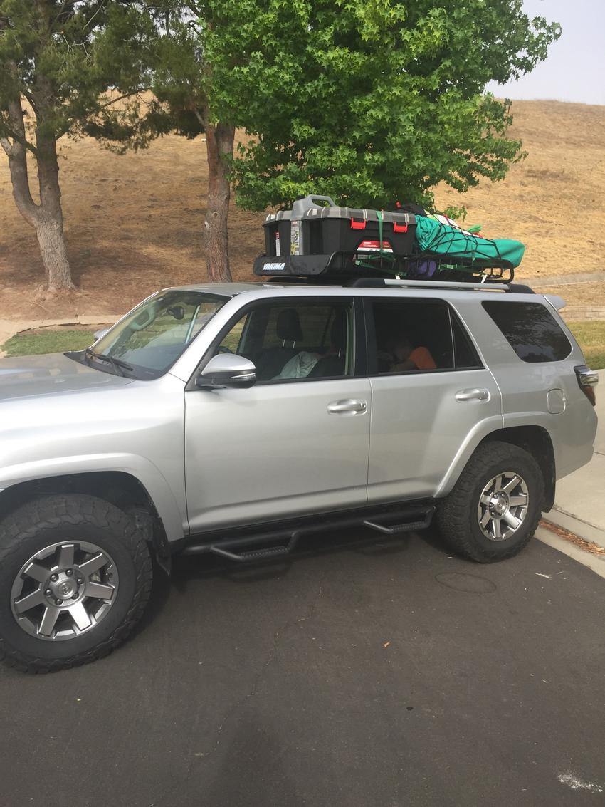

Here is a pic fully loaded with gear. A slight rear sag but I have the back and roof overloaded. The family must take everything.
