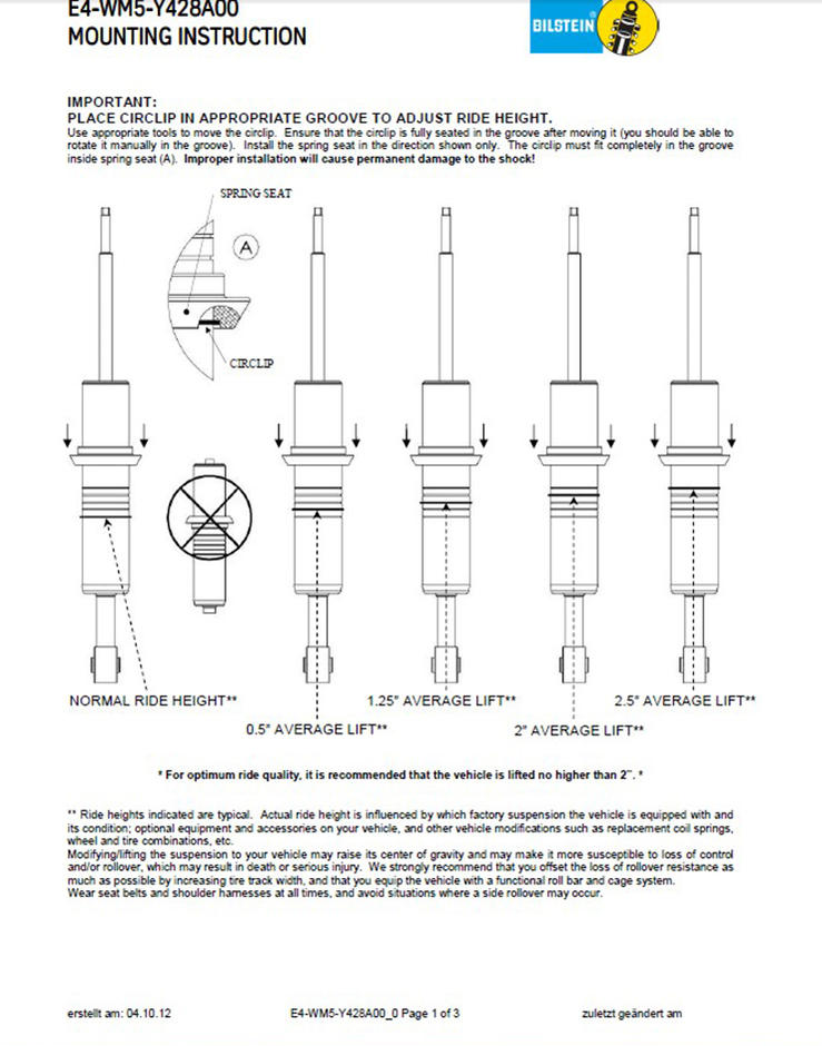

So if you go to the +2 clip on the 6112 (labeled as 1.25" lift) you will get about 2" lift and be essentially perfectly level front to back assuming you keep the stock springs in the rear. If you added the superflex springs in the rear you should maintain the same amount of rake as stock (assuming those lift you 2" in the rear). I ended up adding a 1" spacer to the stock springs in the rear to give me a little rake back. I did not need aftermarket UCA's for this setting and it aligned alright. I am not running the diff drop or any modified bump stops and I have no issues. I am still running stock size tires so I can't comment on that.
Generally what I have seen on here is 2" to 2.5" lift in front is about the max you can do on the stock UCA's and still have caster come in decent on alignment. Also from what I have seen the diff drop is not necessary until you get up to 3" lift in front.

1. To get a level vehicle front to back, what is the likely setting I need on the 6112s? Per Toytec's site I was thinking the 2.5 inch setting would be about right, but there is some conflicting information on threads here regarding the settings on those C/Os.
If you leave the rear at stock height, I think 2.5 is way too high for the front if you are keeping the rear coils stock. As stated above, the conflicting information is that the notch settings give you a higher lift in reality because of the angle of the shock mount points compared to where most people take measurements (ground to fender). There is a post on here somewhere that explains the Trigonometry. I set my 6112 at 2" and added 1.5" rear coils and I have a slight forward rake. That way when I have cargo, I am not drooping in the rear.
BTW the 6112 can only be set at 2.5" at their highest setting.
2. If I have Toytec pre-set the 6112s to a specific height setting, how hard is it to change that setting once they are on the vehicle?
Repeat from an answer you got above - you have to disassemble and move the retaining clip. You can not adjust like some others using just a shock spanner.

I set my 6112 to 2" so I have that last setting at 2.5" for when I get something heavier for the front. If you know you will get a heavy front bumper and winch, you may want to consider a stiffer spring up front and go with a different setup. Again you say you have a daily driver so do you think you will get a heavier bumper and winch soon?. You can always get a stiffer spring later if you really are going to get all that stuff.

7. Are the Toytec bump stops useful for my application?
Unneeded in this setup, but not a bad extra to add.
8. If I go with the 2.5 inch setting should I be able to run the BFG AT KO2s in the 285/70R17 size without rubbing or should I consider 275/70R17s to be on the safe side?
Yes, 285s will work. Stock wheels?
9. If I add a heavier front bumper, and possibly a winch, in the future, is it as simple as then notching up the coilovers to the highest setting? Or will I need to change out the actual springs to a heavier spring?
For every 200# we suggest upping the spring rate 50#. You can make minor adjustments with the preload.
Thanks in advance for any help. I am particularly interested in insights from others who are running the same or a similar setup.
Total Automotive Performance has these in stock - we did a lot of the development and introduced the 6112 to the market so we can answer any questions you may still have.
If we can be of any assistance, please give us a call at 702.979.1577 or email us at [email protected]
I am considering the same setup but called Bilstein about the 6112 for a 2016 trail and they indicated that the product only fits 2015 and earlier. I did not think there was any change in 2016?
Also, would the 5125 be ok vs the 5160 to avoid reservoir install? Any impact to ride height?
I see the 5125 has different lengths. I will be setting the 6112 at the 2" setting using the sway away 1.5" rear coil.
Thanks
Thanks
I have 6112's and 5160's on my '16 Trail. No ah problemos.
Talk to the guys @totalautomotive, they'll take good care of you!
TotalAutomotiveLV; [B said:
3. Are the Toytec Superflex coils for the rear a good choice with the 5160s as far as lift height and ride quality? If not, what is a better choice?[/B]
ICON coils ride a little better than the Toytec, but both are great options.
[/B]
I agree. I haven't experienced the Toytech but have the icon.
I first installed the 6112's on the 4th notch with OEM rear coils. Reverse rake and the truck just didn't feel right. Hated driving the rig for like two weeks until I installed Icon 2" rear coils.
After the install there was SUCH a noticeable difference. Ride was tight and sat properly. The springs on the c/o are fairly stiff (my opinion) vs stock. The Icon 2" rears match them well. Also, I like the idea of Eibach springs in the front and rear.
Thank you for the reply confirming compatibility on the 2016. After going to the local shop I ended up ordering the 6112 set at 2" for the front and the 5100 for the rear. Also went with the Icon 2" rear coil and the 1" front diff drop.
Based on the info I read I am hoping it will work out well. Also doing a new set of AT tires.
After a few years of family duty I will get to turn it into my dedicated adventure ride.
I don't understand the recommendation on the diff drop kit. It does not really drop the diff, just angles it. More potential problems than benefit IMHO.
The hybrid Toytec systems that come with the Eibach springs and Bilsteins give the best on-road ride.
I had sag issues with my front and and had to readjust them, and install a spacer to even things out.
