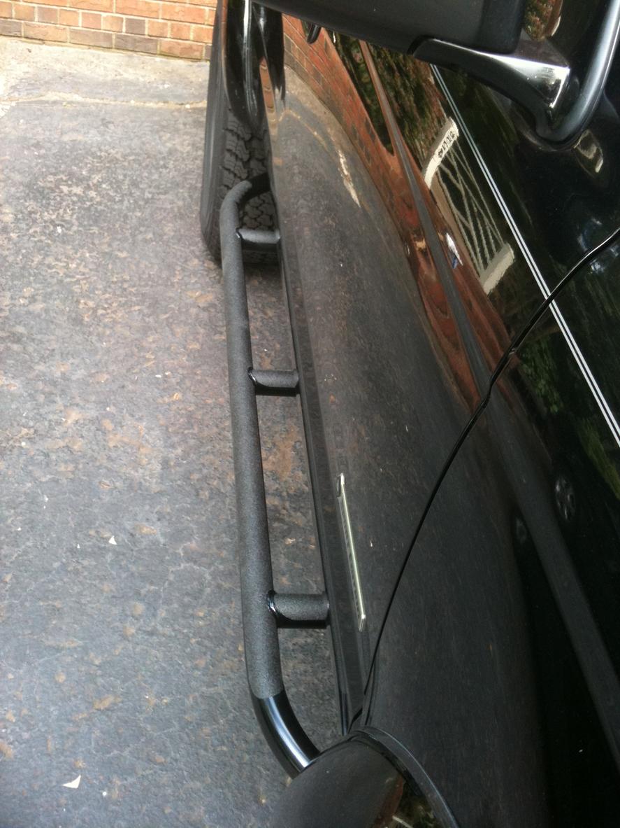

About the only thing I have had to do to mine since I got it was to add rock sliders so my wife can actually get into the truck.
I feel good pulling into parking spaces now with no worries about those 500lb 6 foot long Cadillac doors. They can wing those caddy doors just as hard as wide as they please now. Wont bother me a bit.

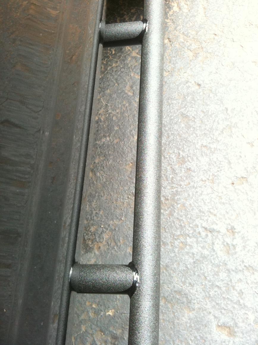

I got the Trail Gear 67" 1 3/4" X .120 1035 DOM tubing.
Painted them with the Rustoleum Professional High Performance Spray paint and Primer then cut some grip tape to fit.

The way you cutout the notches on the tape was a great idea. I was just going to slap some tape on. I'm totally going to steal that idea. Thanks!
Oh and the cuts look nice and clean. Did you use some sort of template? And if so, what did you use?
Thanks, it is the best way I could figure out how to put it on there to cover the area I wanted covered.
It is 2" wide grip tape, I measured a fat 1/2" on one side and drew a line all the way down one side then simply put the tape on top of the sliders holding it the whole time so it doesn't move then take a sharpie felt pen from underneath just make a mark right where the weld starts on each side of the tubes, then flip it over and draw a nice curve in between the 3 lines. Then I used a pair of scissors to cut it out.
Was really quite easy to do.
On the short pieces just cut to fit between welds then cut a nice curve on each end.
The grip tape is rather forgiving so doesn't have to be perfect to come out looking like it just get it close to the right curve around the welds and you are good to go.
Just make sure that when you put the tape on the slider that you just pull back enough to expose the first cut out, stick the center of the cut out right where it needs to be but stick only just a tiny little bit of it, just enough to hold it in place then pull back to the next cut out and do the same thing stick just enough to get it to barely hold then stretch the tape out to the next one and do the same thing.
Once you have just the 3 cut outs stuck then work slowly from there and it will all fall right into place.
