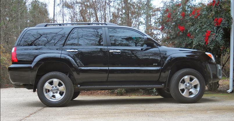

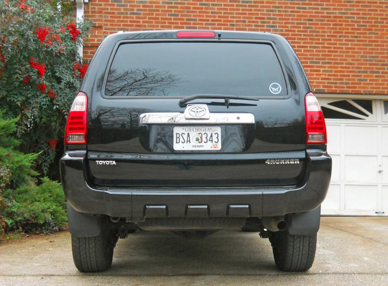

Well after getting my transmission completely rebuilt and getting a set of bilsteins put on with a daystar 1.5 rear spacer i finally got her back. To bad the transmission left me broke, I need new tires bad! Im thinking a set of bfg AT's?
*also there is a creaking noise now that sounds like it might be coming from the suspension. It only seems to happen when taking sharp turns and when coming to a stop sometimes. Any idea what it might be?

Depending on the noise, it could be the spring seats.
Not sure where that spacer goes but that could be it also.
is there anyway i can check to see if its the sway bar bushings?
Don't start scrambling just yet.
If you didn't have the squeaking before, then you put the suspension stuff on and now you have squeaking, that very simply tells me that the issue is within the components you just worked on. It may be as simple as a quick spray of lube to let things settle in or you may have to go in again, unload the suspension bits and let everything adjust itself.
