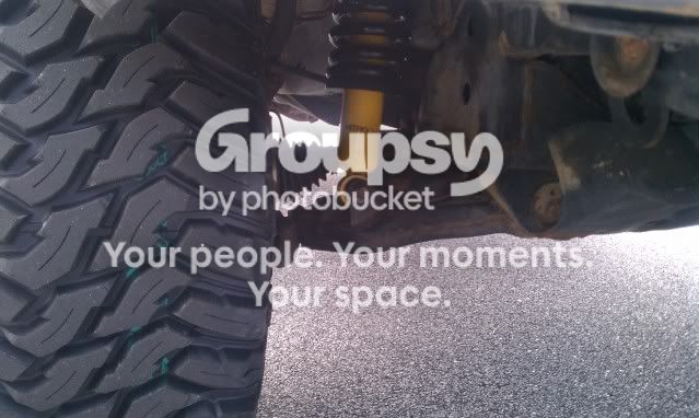

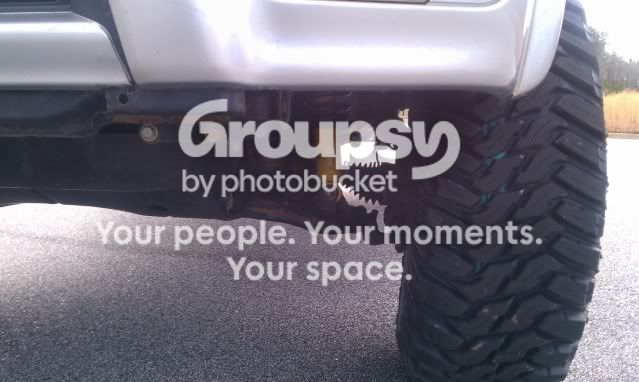

Here's the CV angles I promised as well. I am extremely happy I was able to maintain the almost exact same angle as they were stock. I had just one tiny rip that was at best a quarter inch long. It was clamped and everything else is perfectly fine. 70 miles have been put on it since the lift and zero problems or rubs.

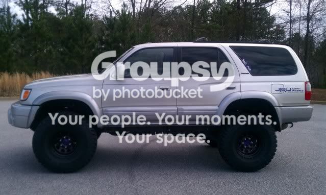

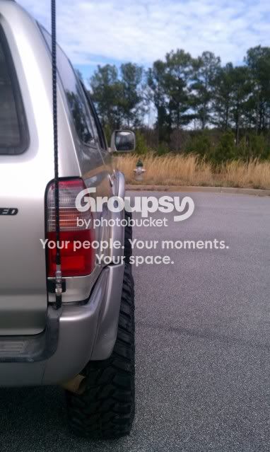

It's been a pretty on going process for me but it's finally sitting right. The Calipers didn't require as much grinding this time which was refreshing. This setup also required less cutting. It is completely street able with no rubbing. Off road Ill focus a little more into the pinch well area so I will be completely positive it wont rub fully flexed. I always rains or is no warmer than 20 degrees when we grind. This was the third that's been grinded at my house and the weather has changed in seconds.
The ride is WAY more planted. The suspension has stiffened up some also making it feel more responsive when turning. As far as acceleration I honestly dont feel any loss at all. The biggest difference is that it will down shift sooner on a hill to keep up speed. No more different that my last with 33x12.50.
The alignment is being done Monday to make sure they wear as even as possible. The speed also jumped 10 mph so instead of being five under I'm now 5 over. All info on the build I'll be updating in the build thread. Thanks everyone for providing information on making this possible. Yes, the search bar DOES work.
