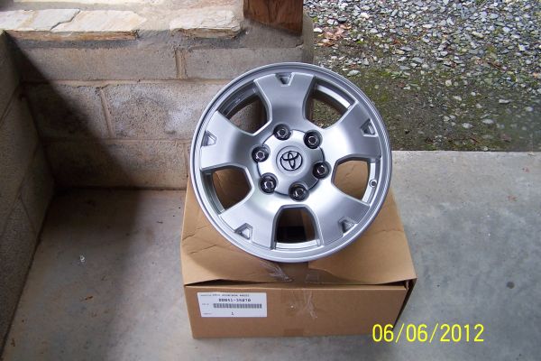

Rims and tires: upgrade the stock 15 inch Enkei's to 16's and put on some decent rubber. (For a 2WD) Suggestions: see options/pictures I am considering towards end of post
This will lead to:
TBU: Depending on the rim/tire combination will do either 199mm or 231mm. Suggestions welcome.
LSD :biggrin2: Limited Slip Differential: I have the Detroit TruTrac in mind. Remember, it is 2WD and I have no desire to spend ARB $, but will appreciate good road manners combined with
power going to the right places. My mechanic will install for $100.

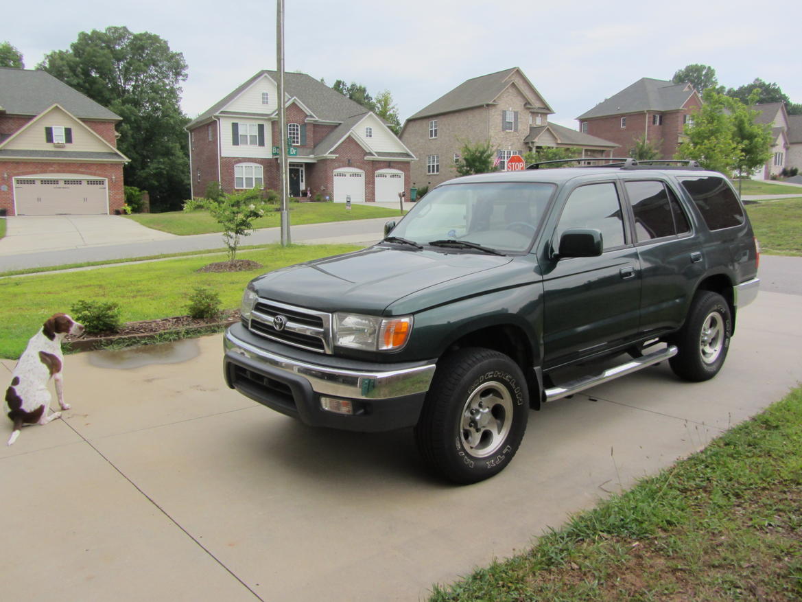

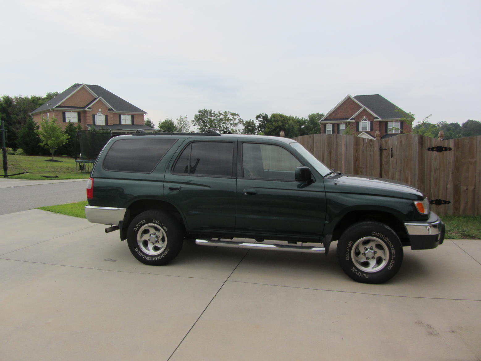

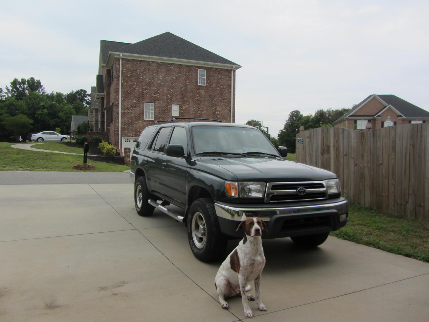

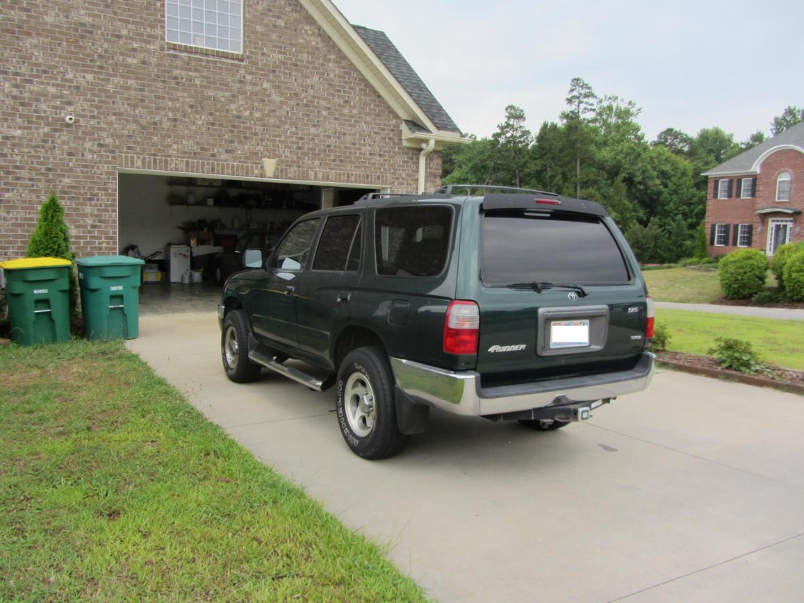

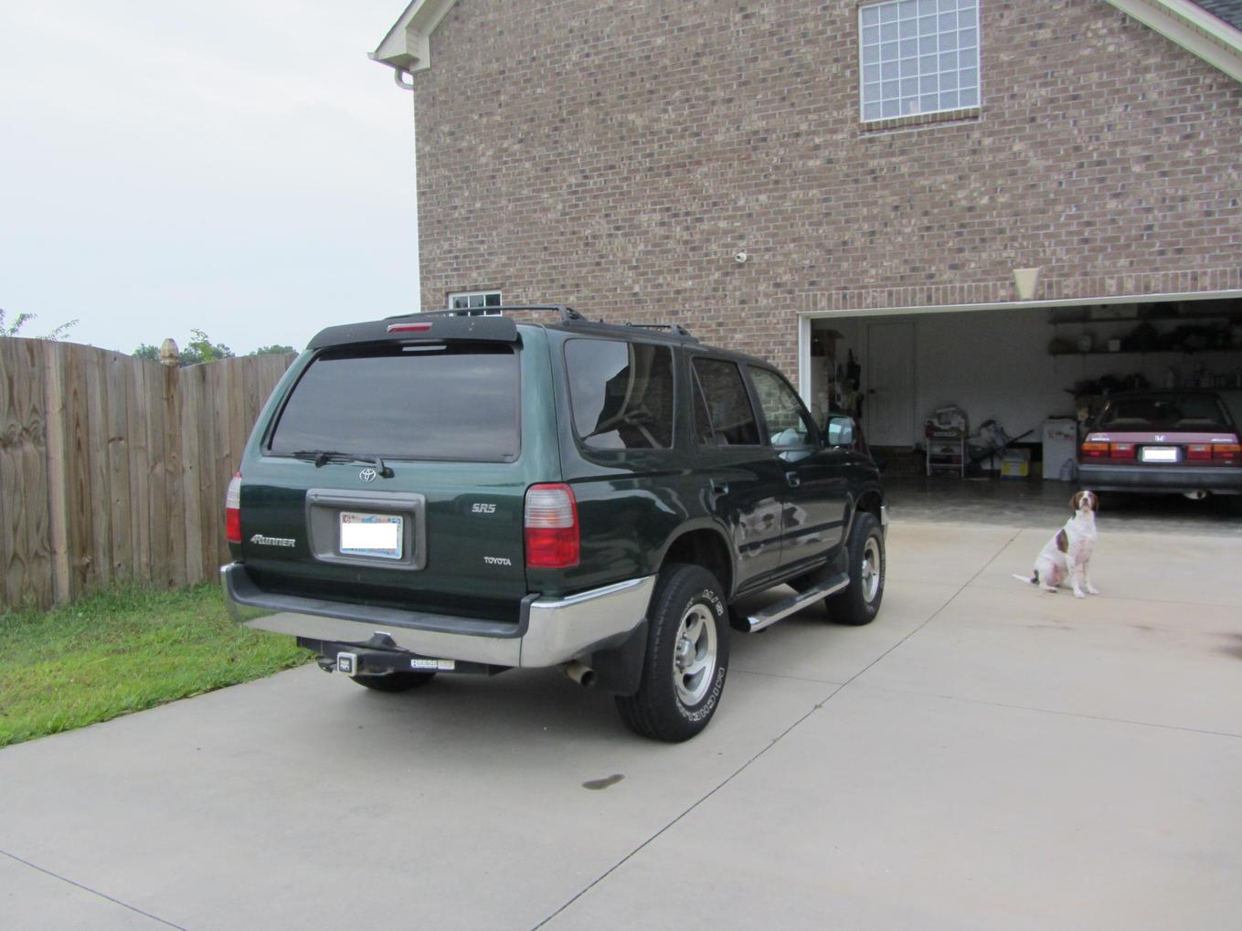

Pictures of the ride, and Cpt. Max, are below. Sorry, my folks did not wash it and it has been raining all week.

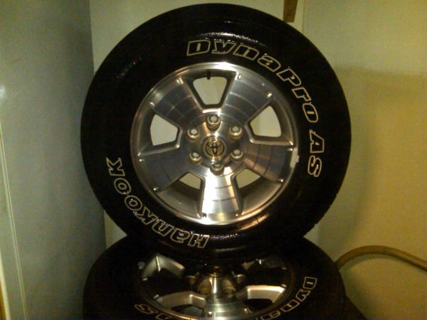

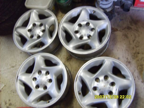

Pictures of the rims I am considering are also below. One thing I like about the rims on it is how the wheels stick out beyond the fenders. I know that Tundra/Tacoma wheels can sit
further in and I will not use spacers. Aside from that, the more functional questions: What is the truth about Hub Centric vs Lug Centric? Will I see a huge difference? Are all steel
OEM wheels lug centric? Feel free to elaborate.
Lastly, I am considering several tires. I have to keep a budget in mind, but i think I am over highway tires. I am leaning towards AT's and would appreciate input regarding longevity and
value. My budget, depending on the rims/wheels, will max out at ~ $150/tire to $165/tire. BF's, Goodyear, Mickey's, Firestone, Bridgestone, waddugot?

I like the first rim picture over the others for sure. Are you going to leave the step bars on? Maybe its just me but the chrome really jumps out, but I'm a big fan of black everything. Otherwise, super clean looking ride!
I will likely keep the step bars. We will use the roof a lot for camping, luggage, etc.
I like the first set of rims also. Problem is, I have read that they have less offset/backspacing and will make the "track" more narrow. I don't think it'll be that big of a deal because the truck doesn't have fender flares, but I definitely don't want to affect my caliper choice when it comes time to do the TBU.
Anyone know about 2012 Tacoma Wheels on 3rd gen. Specifically regarding TBU and/or sitting further "in"?
Thanks
Nice truck, cute dog. I vote for the rims in the first pic as well. Don't know much about wheels in general though, sorry.

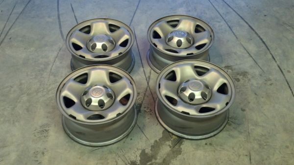

I found these on CL. Anyone know about fitment on 3rd gen? They are 17's from a Tacoma, should clear 231 calipers, right?
Thanks,
KG
