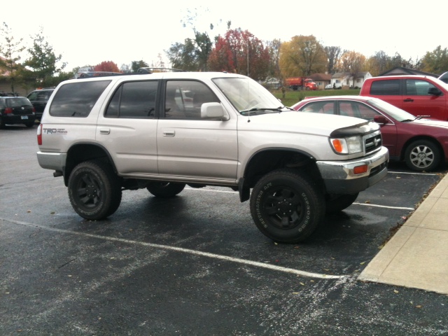

It doesn't look like I have any pictures of it when I bought it, so here's exactly what it looked like when I picked it up.

4) Next up was the lift. Didn't want a stiff ride, so I went all Bilstein and OEM Toyota springs.
-purchased TRD Tundra shocks/springs from a local junkyard and put them on in between one of my work trips. Looked like a pre-runner until the I got the LC springs and Bilstein 5125's(from Toytec) put on, then it became apparent that I needed a little more lift in the front to even it out. While there was nothing wrong with the TRD Tundra shocks, I didn't want to do a spacer lift. I ordered the Bilstein 5100 height adjustable shocks, also from Toytec. I set them on the middle setting and the truck sits dead even.

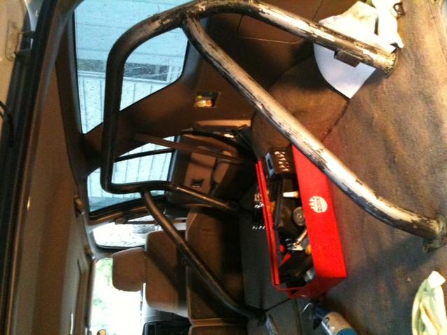

6) Was bored one day browsing the classifieds section on yota-tech(I rarely get on there), and came across an ad for a free 1st gen rollbar. Kicker was, he wasn't willing to ship. Lucky for me he was located here in Indianapolis.

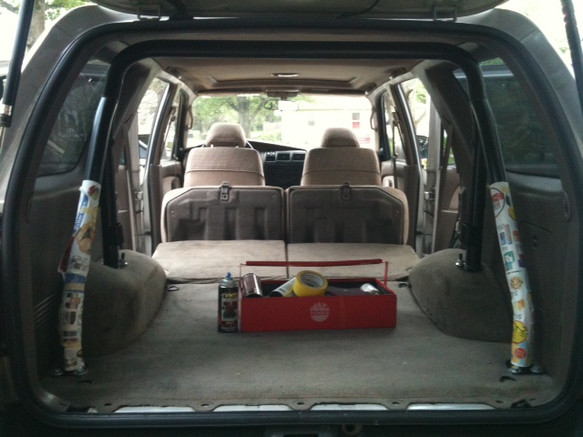

-Brought it home and did a quick sand/paint and sat it in the back of the 4Runner. Wasn't happy with it, but it ended up sitting at my work for a few weeks until I had time to do a thorough strip and paint.
-Put several coats of VHT rollcage paint. No primer, no clear coat.
-After I let the paint dry for a day(hey, I wanted to be completely sure it was done lol), I completely wrapped the rollbar in newspaper so it didn't scratch up the paint when putting it through the rear seats.

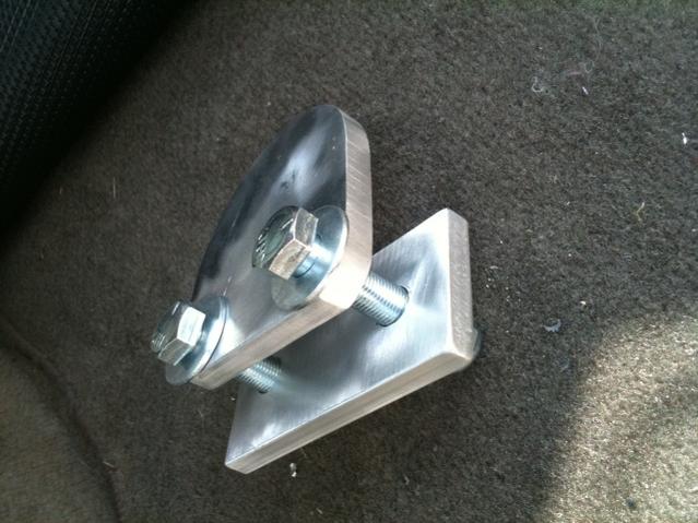

-Now that it was in, it was time to install it. The mounts obviously won't hold up in the unlikely event of a high speed rollover, but maybe if it were to tip at low speed, it will help....who knows. Made spacers for the rear legs, and backing plates for the bottom of all 4 posts.

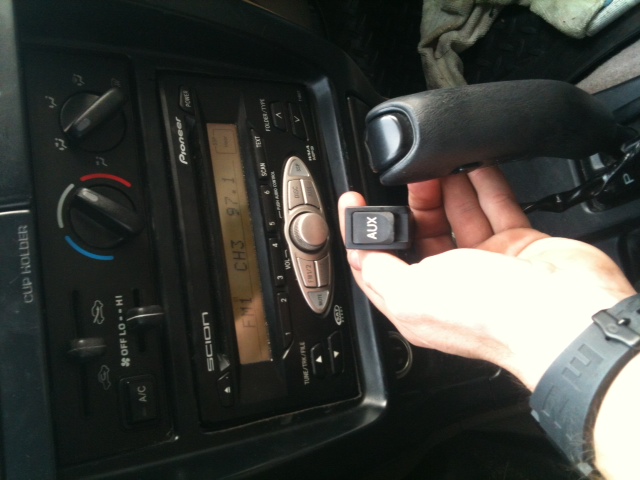

11) Last week, after driving this thing around for a year without an antennae or being able to use my Ipod, I finally had enough. I bought a Pioneer Scion head unit with Aux input option from a guy on craigslist. He couldn't sell the Aux adapter, so......I went down to a massive Import car/truck junkyard just outside of Indianapolis(Brickyard Imports).
-Pulled a non-power antennae assembly out of a Taco(the power antennae was broken and missing on mine).
-Browsing through the Toyota truck/suv section, I found a bug shield in perfect condition on a 3rd gen 4Runner. I have a small rust spot on the very front my my hood, so this will cover it up perectly lol.
-I figured while I was there I would go through the Scion section to find Aux harness that I needed. On the very last one, I found what I needed. I had just brought a 10mm socket, pliers, and reg/phillips screwdrivers, so it took a few mins to separate the aux input harness from the rest of the wires that it's bundled with going under the middle console, up near the dash, then over to the cd player. The harness has 8 wires I believe, but only 4 are needed for this install...I just snipped them, they were ran up into the dash.
I followed CO Flyfishers thread on installing the head unit, skipping the aux input deviation. I wish I would've followed it a little closer, as I slightly butchered the trim in the process. Hard to tell in the picture below, it's in the top right corner. The previous owner had super-glued an xm radio mount to the bottom of the trim piece, so it will need replaced either way. You live and you learn I guess :dammit:
I still haven't figured out where I want to mount the actual aux input, so for now it's still sitting under under the middle console, with the cable ran up through the e-brake opening. I think I'll end up mounting it up under the ash tray or in the arm rest compartment like it was originally mounted in the Scion TC.

Sweet build! Very good details. How'd you make the spacers and backing plates? lol Any interest in making another set?!
Thanks! for the spacers, just took some scrap aluminum at work, traced the rear feet onto them, and then cut them out on the bandsaw. Marked the holes for the bolts for the spacers and the backing plates. I may be able to do a set in the future when things slow down at work. It's nothing that you couldn't do at home though, in all honesty.
