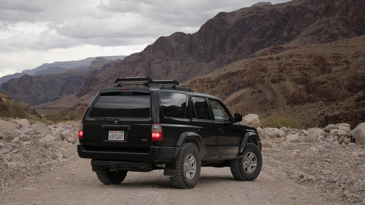

After 9 months of owning my 2000 4runner I finally ordered a lift, after a ton of research and saving I decided to go with the Toytec Boss Lift. As a college student I couldn't rationalize spending more than what I did on a lift, and I felt like it was my best option at this time. // I also ordered an All-Pro Apex front bumper. Both of these should be here within a few weeks and installed before summer ends. I just had a few questions.
Currently running 265/75 16 KO2's and was wondering if it was worth getting 285's. This is my daily but I do not use it to commute. MPG's are not that big of a deal, I'm more concerned about how they might fit the wheel well after the lift. // Should I take this opportunity to replace bushings in suspension, is there any suggestions on which ones to use. Are UCAs worth upgrading at the same time?
If I end up not replacing UCAs or tires, I was thinking about upgrading to some SRQ headlights or Rocky Mountain Racks. Any suggestions are always appreciated. Thank you!

your 4runner looks really good right now.
that lift will be a nice feel, especially if you still have the stock suspension.
tire size is really personnel preference but after the lift, your tires might look a little small. is that lift kit adjustable in the front???
I have 285/75/16 tires now and will be getting 255/85/16 next. (about an inch skinnier, but still 33"-ish in diameter.) for better MPG's more than anything, and I don't need to float over mud/sand very often.
have the Lower Ball Joints been replaced recently? definitely look at those, and only use OEM parts if you replace them.
unless you need to replace upper control arms due to cracking/damage then I would wait that out, would consider that a "nice to have" not a "need to have" item. but inspect the upper ball joints regardless.
Where was that picture taken? almost looks like death valley

It was taken on my way out of the grand canyon. I've kept up with maintenance since I bought the car but I think LBJs are on my list to do asap. I'll probably end up replacing those soon.
