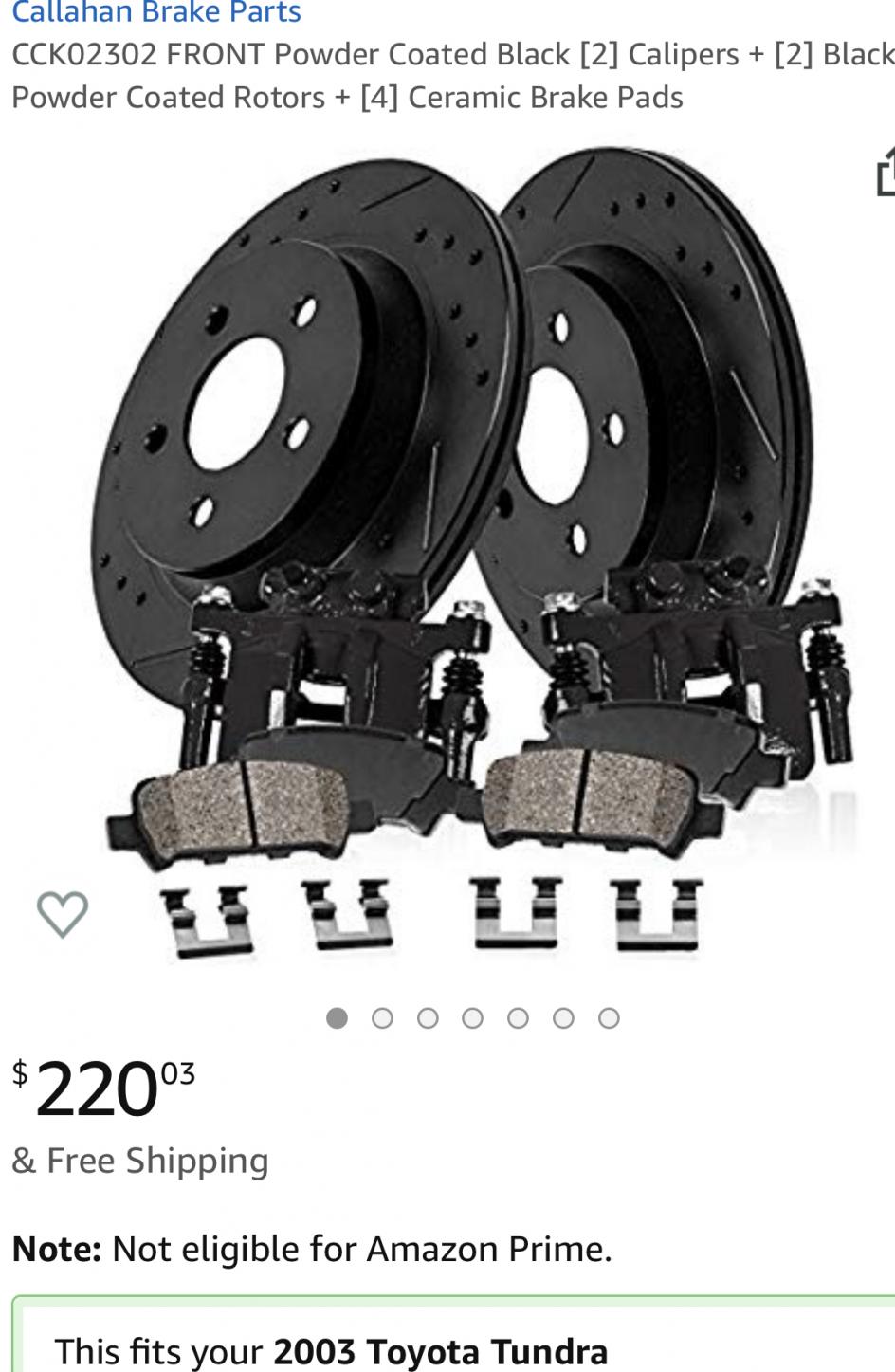

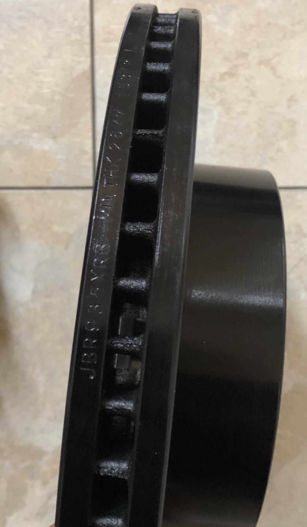

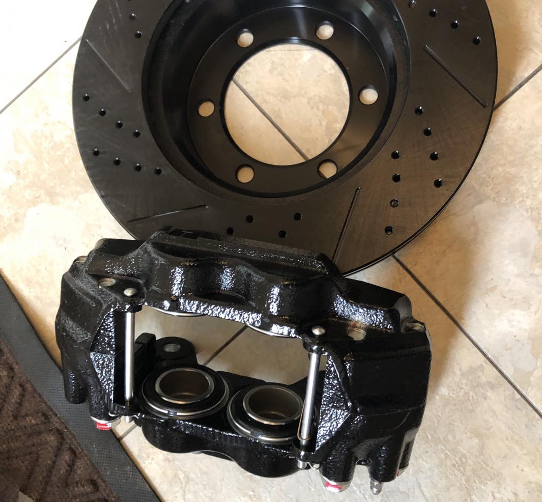

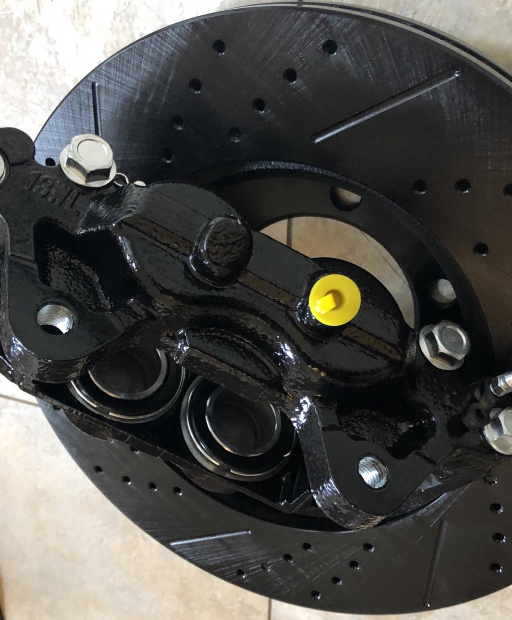

I just got my big brakes today
I got this set at amazon pretty good deal tho
