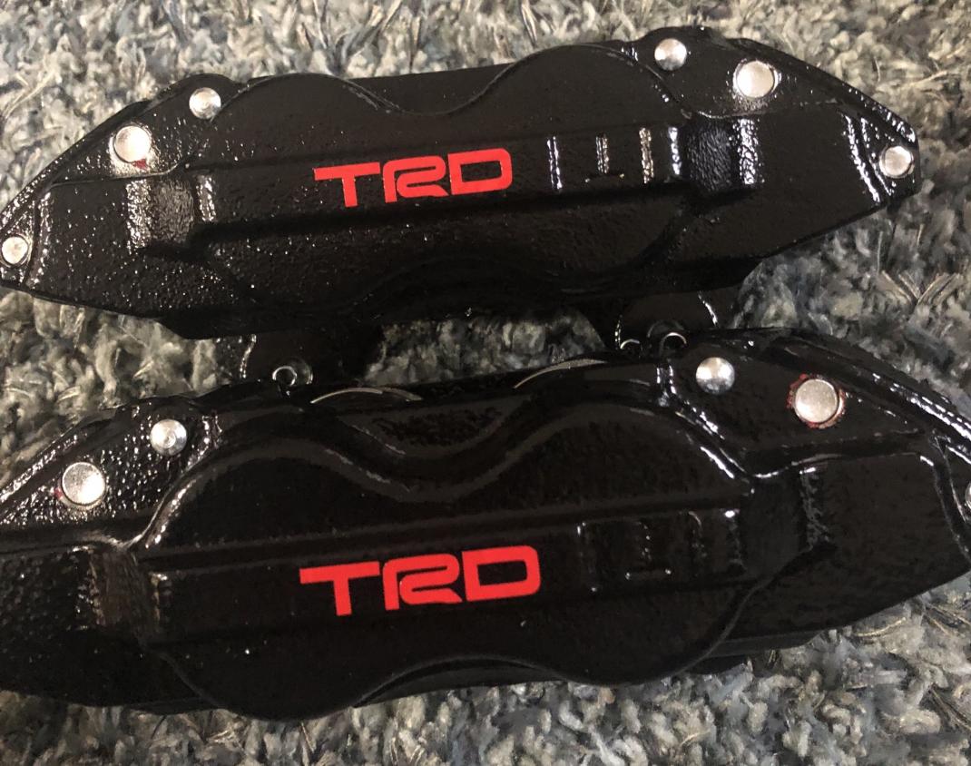

Wait...powder coated rotors? They can't be serious.

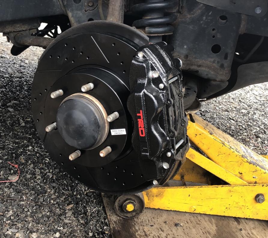

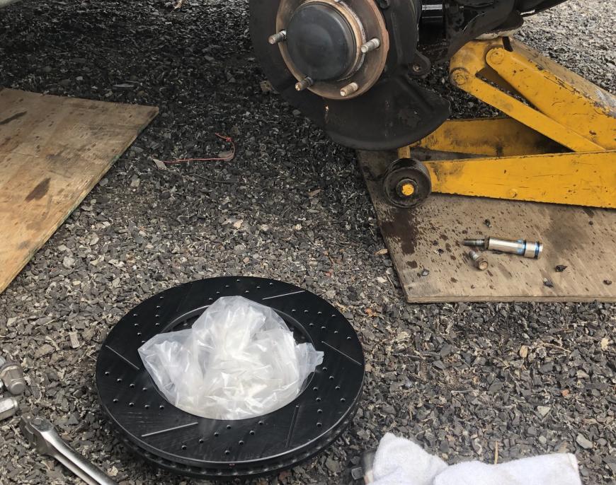

I installed them today went pretty good no issues .

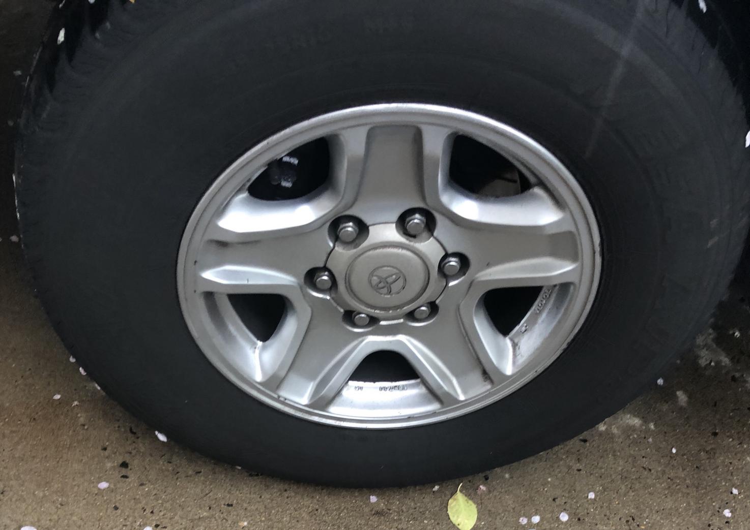

If you have these rims they will work with this upgrade not need to do anything special
Found this kit with red calipers

The 13WL calipers will fit under factory 16" wheels, or obviously 17s
