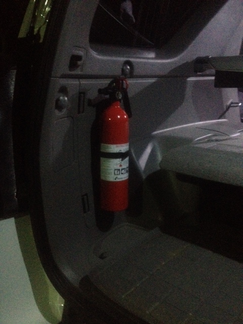

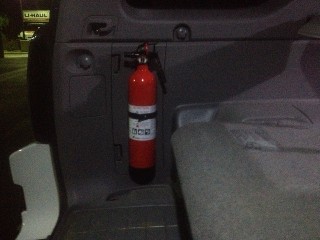

I mounted an extinguisher to the removable hatch which houses the tire jack. In addition I applied the fuzzy side of industrial Velcro for padding on the lower side. Initially I didn't' see the slight concave curve to the hatch. This resulted in not being able to fully seat the extinguisher to the mount. To correct this I added washers as spacers to the mount to push the extinguisher out. No issues with rattle or integrity.

I live in Texas also and have no problem. I would recommend that you get an extingusher with a metal head, not a plastic one. I have seen the plastic ones loose pressure over time. Mine is mounted in the rear cargo area just to the right of the deck lid. No fancy mount bracket, just a strip of velco thru the tie down hook and around the ext.

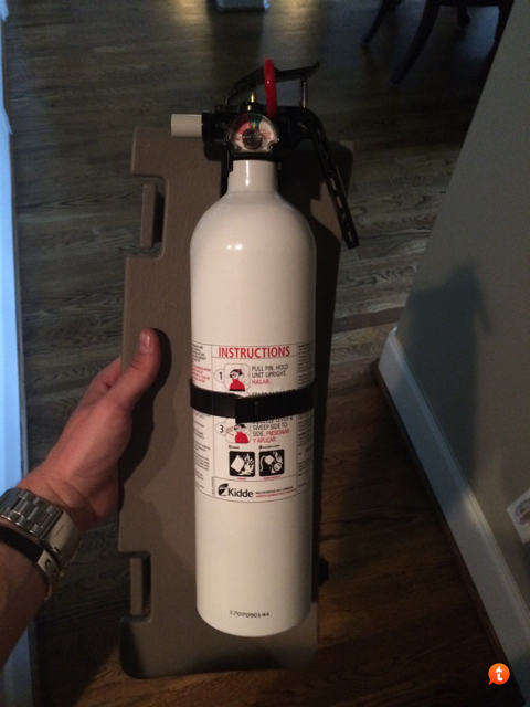

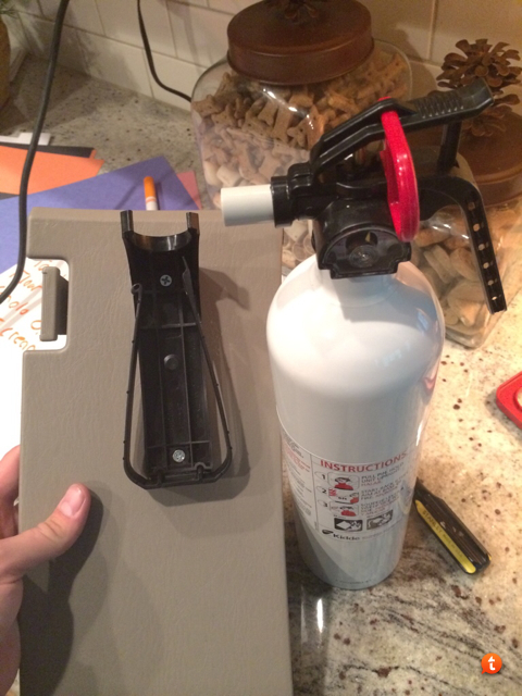

So I went to Walmart and bought a Car/Marine extinguisher by Kiddle. I thought I it would suit my needs appropriately and it was a dollar cheaper so what the hell why not.

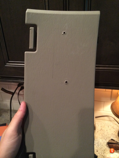

I decided to mount it on the removable part that holds the jack in the rear cargo area.

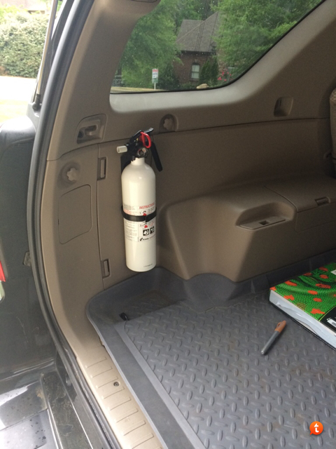

I started by lining he holes up and marking them with a pencil. After that I double checked those holes cause I don't want to mess this up and have holes in the panel. Then I drilled.

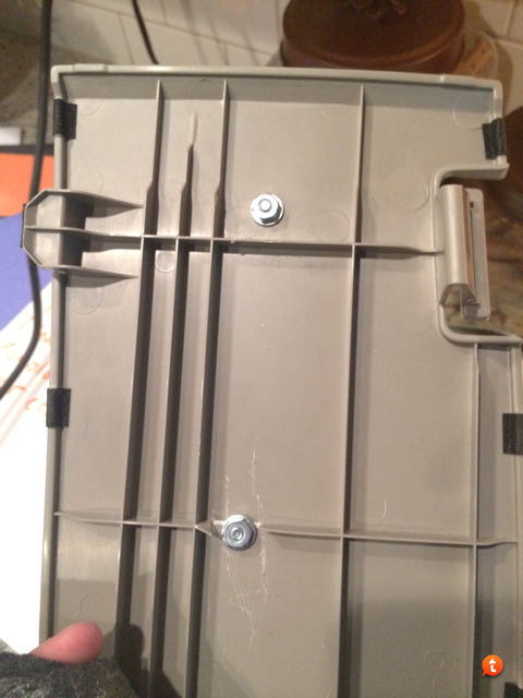

Once I did this I immediately ran into a problem. I just wasn't really thinking right and drilled right under the lines that run across the back. The screw would fit but the washer and nut wouldn't. No problem though, I just took a steak knife to the back of it and made an area for it to fit.
I put the screws in and boom it fit,
After that I used a screw driver to screw in the panel that would hold the extinguisher
After that was done and it fit snug and tight I put the extinguisher on. It looks crooked I know, but it's straight when inside the car. I made sure of that before doing anything cause I'm OCD about that.
Finished product
Really happy with it, easy affordable and might come in handy in the future. My friends are giving me shit saying it was a waste of money and stupid, but it's better to have than to not!
Anyways thanks everyone for the help!
Is that really secure though? I feel like that panel isn't on there very tight, would suck to get in a crash and be clocked by the fire extinguisher. lol
Don't get me wrong here, love the idea and installed one myself. Better safe than sorry and have one.
Next, test if you do go off roading, and more towards the extreme side of REALLY bouncing around. See if the door panel will stay put with that extra weight attached.

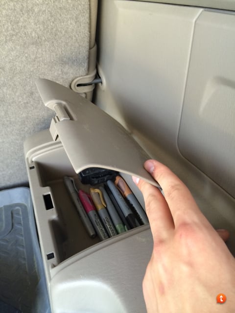

I'm considering mounting it into this piece. I know I wouldn't be able to open it then, but I don't really have a need for it anyways and at least that way I don't have to worry about it falling off or anything.. Just a thought not sure yet.

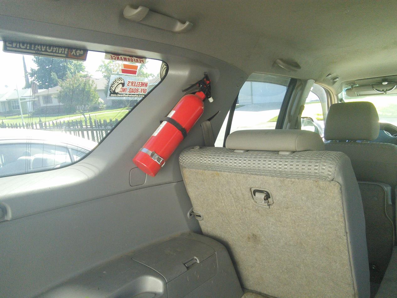

It works for me and is out of the way of heads and all the stuff I put into the back to the roof.
I used much larger fender washers on the inside of the panel. And have been on EXTREME trail runs, no problem.
Edit... If your considering the wheel well area, you might consider the other side as there isn't a wall compartment your blocking on that side.
