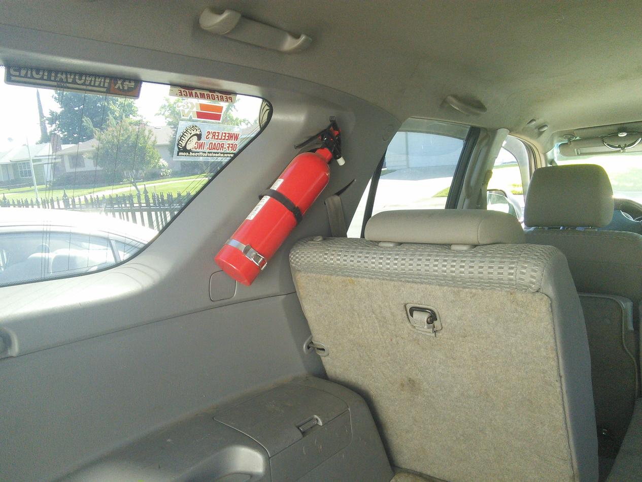

So, I guess putting it in a place like here is out of the question, HAHA.
It works for me and is out of the way of heads and all the stuff I put into the back to the roof.
I used much larger fender washers on the inside of the panel. And have been on EXTREME trail runs, no problem.
Edit... If your considering the wheel well area, you might consider the other side as there isn't a wall compartment your blocking on that side.
How did you out that on? Would I need to remove the panel and drill? Seems difficult to do...
Ancient Chinese secret grasshopper...
The access panel below the extinisher and on mine, srs badge upper right of it, inside, remove the bolts. Rear door jam, remove enough of the door rubber seal trim. I do believe there where press in plastic clips, pop them out of the metal wall. Will give me just enough room for my hand to slide in, yes, I got scratches doing this, it's tight.
I looked inside before marking and drilling for location and enough room for nuts while putting back together. There is insulation behind there.
Plastic piece, large contoured head screw type bolt, large 1.5" flat fender washer and self locking nut, 2 each.
Metal bracket has a small flat washer between the bracket and panel, repeat on the washer and nut with this.
Edit... I would have put it on the pillar, but, the seat belt assembly is in the way by the driver.
I think you'll be fine. I've always had one in my truck and never had any problems and it gets up over 130 in the dark cars here in the summer.
Agreed with above. Can't get too much hotter than here in AZ. Never have had any problems. Just have to replace the old ones every year or two. That's why I spent the extra money for the refillable ones with the gauge.
