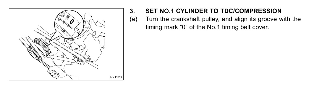

To get TDC just align the marks on the harmonic balancer.
