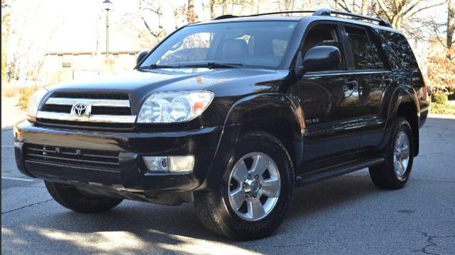

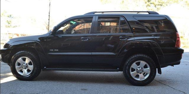

Got my first car today, and Im happy to say that I am now a T4R owner.
Im fairly new to cars, and wanted to know what my options are for lifting my 4runner. I'm gonna off-road a few times a month ,but not too often. I didn't know if I should go with spacers or a actual suspension lift. I am leaning towards a actual lift, but I have no idea what brand seems to be the best. I have heard good things about Toytec, OME and some others. Im was looking at maybe a 2" to 3" lift.

Beautiful runner. What other mods are you looking to do to it? I'm the one to help with lift but your car would look good if you plasti dipped or painted the rims and get rid of all the chrome. But that's my opinion and $0.02. But congratulations on the buy and hope to see it lifted soon
