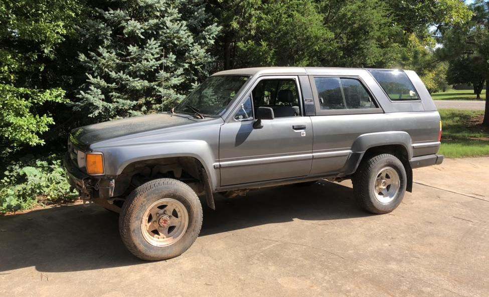

One of my parents’ neighbors had just sold their house, and they had this ‘88 sitting next to their barn out back. It hadn’t been run in several years, and at first I wasn’t totally interested in it. I wasn’t really looking for a project, and had just spent a large amount of money on other things for my cruiser so I wasn’t exactly trying to spend more money as I am really only able to do stuff when I’m not in class. They rolled it over to my parents house and basically said, if you can get it running and don’t want to buy it, we will pay you for getting it running. Needless to say, I got it running and after a drive around the neighborhood a huge grin showed up on my face. I’ve been wanting a manual for awhile and have really been itching to find an FJ40, but the prices on those are just unobtanium for me. Despite how slow people say these are, this thing felt like a Rzr to me compared to my Land Cruiser.
$500 later and it is now mine.

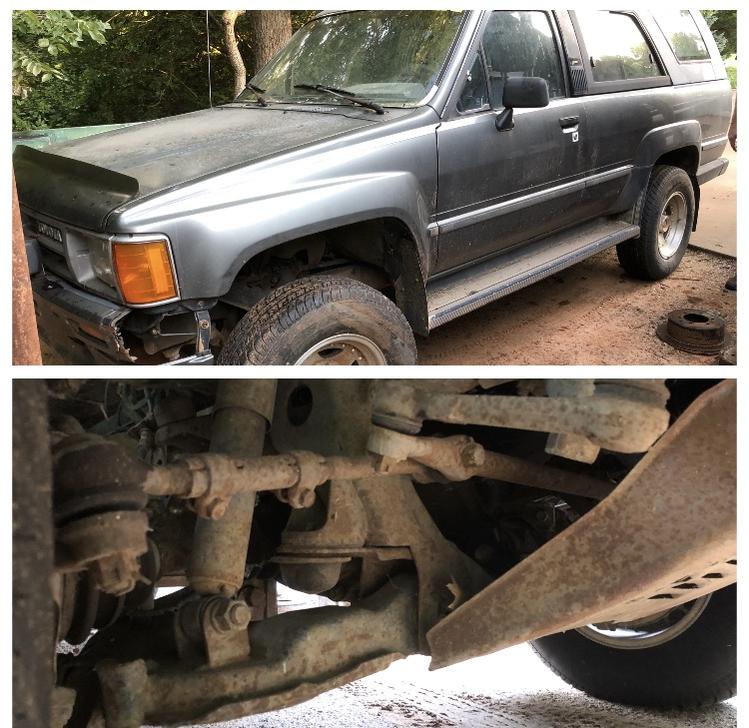

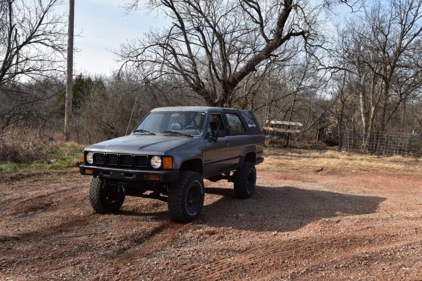

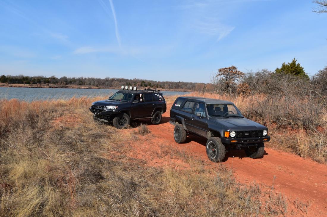

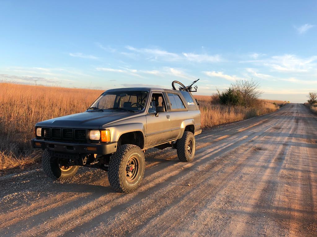

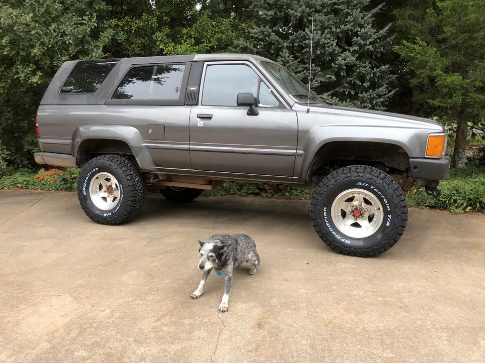

Here’s a few pics of my 4Runner and one of my ‘92 80 Series.
looks like you got the T4R for a bit of a steal!
Nice 80.... we had a 93 triple locked that we sold a little over a year ago, literally just sold our never ending "project" FJ40, and we have a 100 series....
Yeah I like to think I got a good deal on it, but it really needs just about everything and the passenger side is definitely not as nice. Putting together a spreadsheet for everything it needs is downright sad. I know I don’t want to dump a ton of time and money into it since they’re values don’t seem to justify what they bring. Then again that’s really any modified vehicle. This one is definitely going to be interesting. Out of the 10 or so bolts I’ve removed, 75% have broken off.

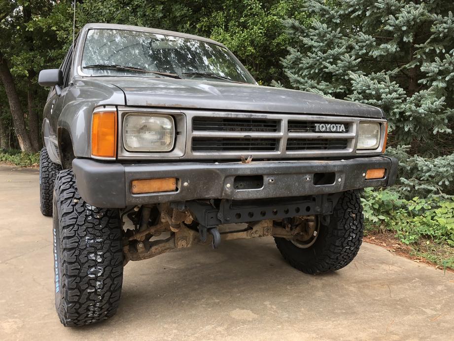

Why early mini truck grill and lights? And how you'll make them fit?
Thanks!
Aesthetically, the “dodge” looking front end has always been the biggest thing I dislike on 1st gens. I nearly bought an older pick up awhile back and have always loved the front end on them especially with the round headlights. After a bit of googling, I did find a guy who put one on the front of his 4runner, but it seems like he didn’t trim out the headlights. I’ll be sure to document it when I do it. I went ahead and ordered a cheapo replacement grille that had good reviews for ~$30 shipped today. I also ordered 1.5” BJ spacers and Moog 81043 coils for the Zuk mod. I might buy a set of 31x10.5r15 KO2s as I found that I can get 4 through Sam’s club for $520 with supposedly a $30 install. Coincidencentally, I just sold an old set of 35s from my cruiser for $550 so that seems to be a logical choice. I’m gonna put in some good work next weekend on this thing and hopefully get a bunch of stuff knocked out so I can enjoy it this fall for some biking trips.

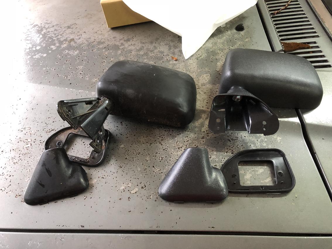

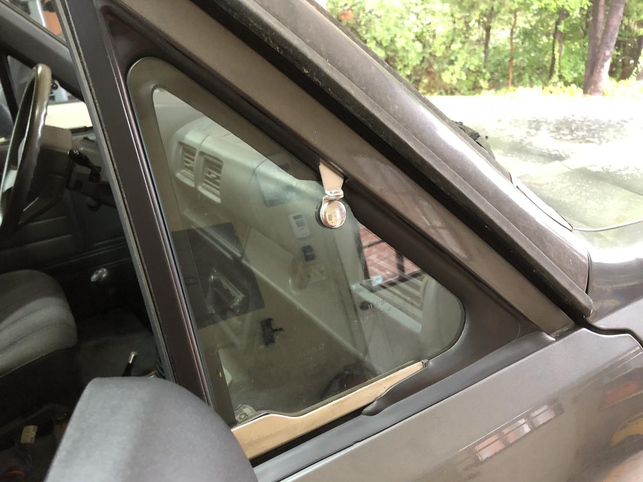

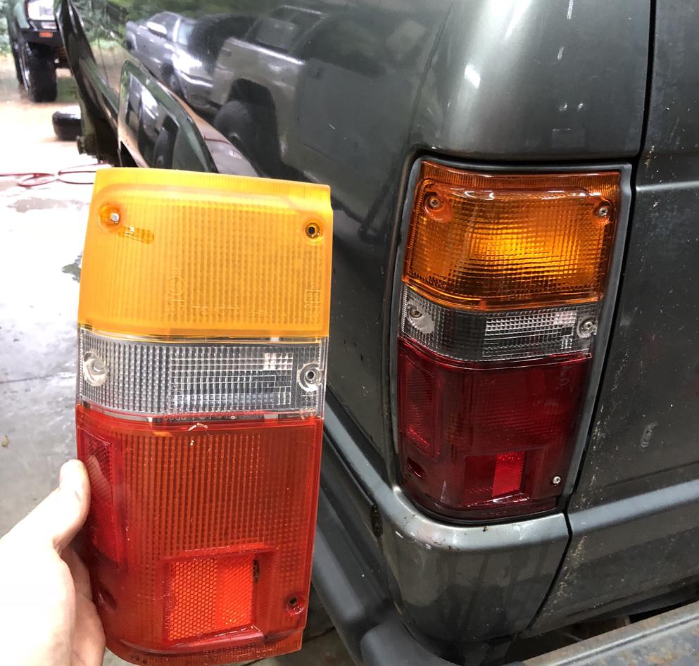

Fun day so far. New side view mirrors, tail light lenses, interior dome light cover, and bumper corners. I also cleaned the rubber around the fold out front windows, and worked on getting the front passenger door handle working. For whatever reason, my rear window, that had started working has stopped working which is annoying. I’ve started on the front ball joint spacers but I’ve never struggled so much getting the ball joint to separate. Penetrant, large brass hammers to sledge hammers, and heat to no avail. Hopefully this cooperate soon and then I’ll move onto the Zuk mod rear. Tires are in. Just need to go pick them up.
I’m also planning to fix the seat cables as soon as I can get the glass to lower. I’m also hoping I can just swap seat bottoms from side to side. That should tide me over until I’m ready to redo all of the upholstery.

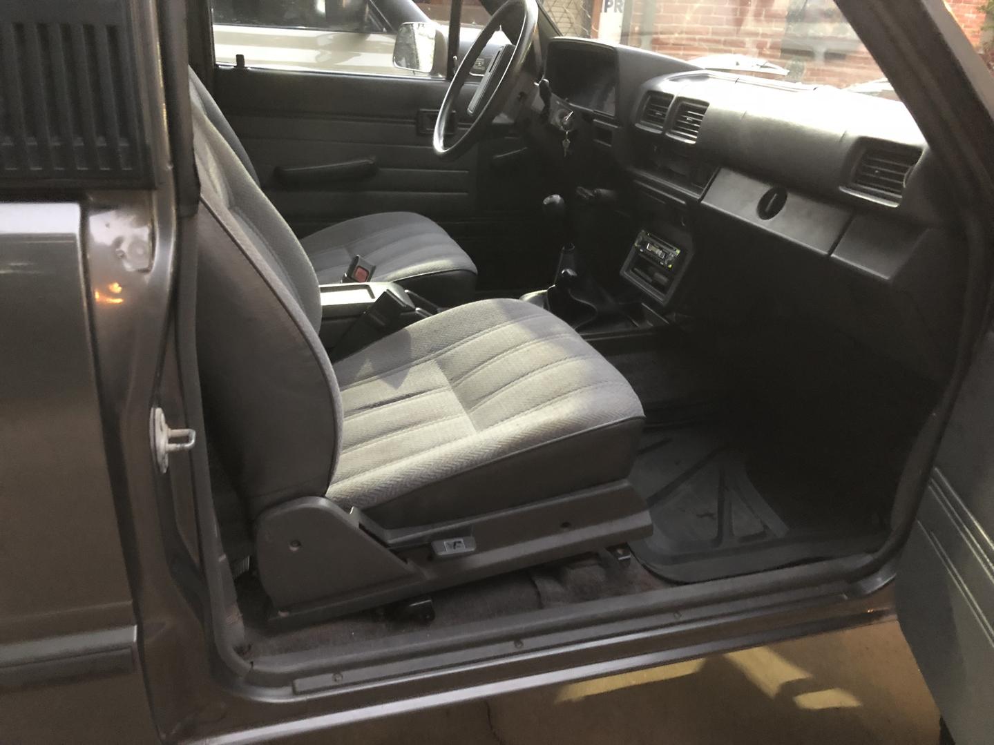

Side question:
Did 1st gens come stock in some configurations with black interiors? I’ve seen that gray and red are pretty common but a buddy sent me a pick of a black steering wheel in one. It seems fairly common that people use SEM to paint the parts black, but I wouldn’t paint a steering wheel. I’m interested in going that route and would rather have an OEM black steering wheel than going with an aftermarket wheel.

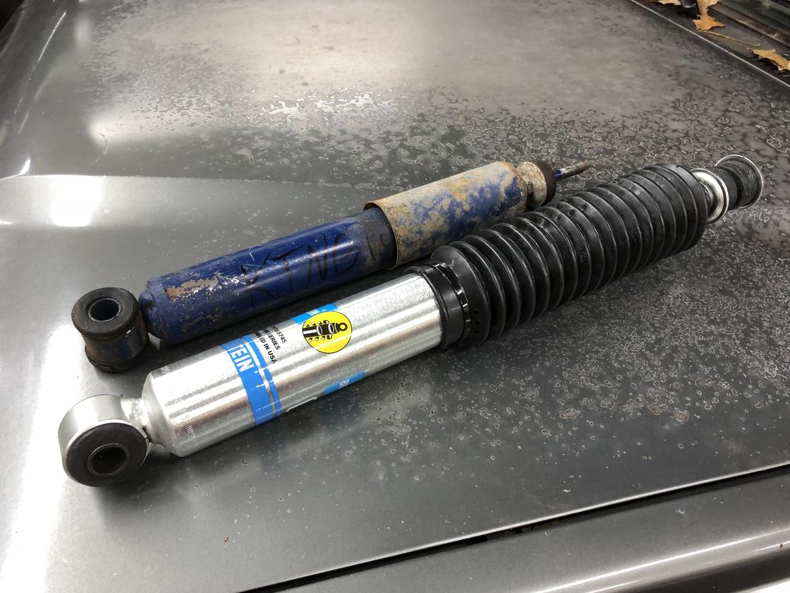

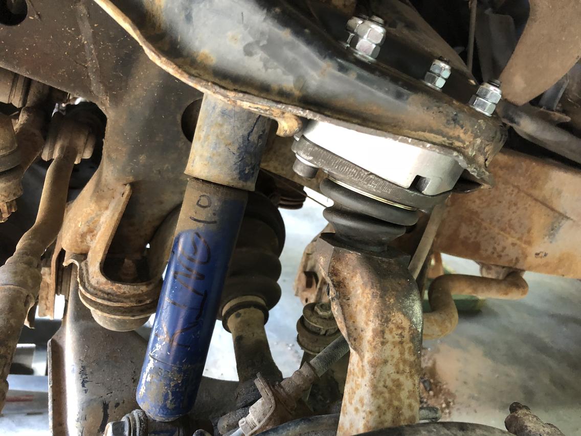

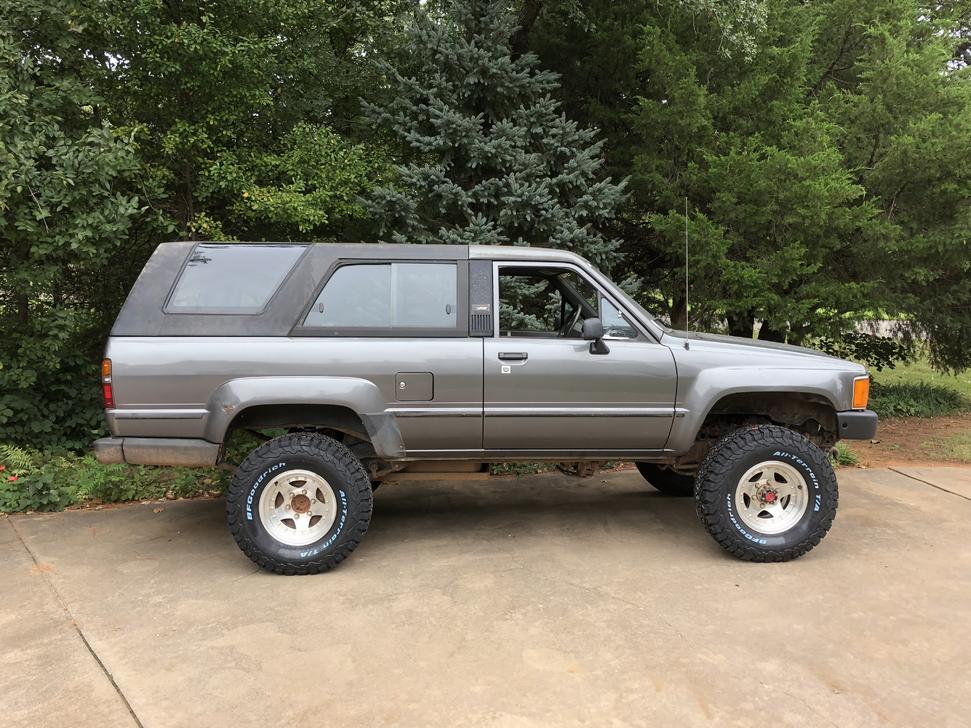

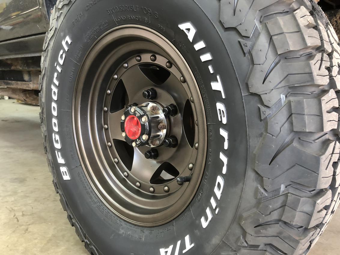

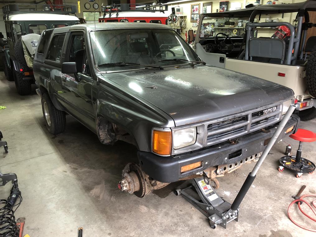

Managed to knock out the “Zuk mod” with MOOG 81043 coils yesterday as well as the front 1.5” BJ spacers. I went for new greasible upper ball joints. Installing the ball joint spacers ended up taking a lot longer than expected. None of the “tricks” to slide it all together were working for me. After using a bottle jack, I had enough clearance but the CVs were binding up. A buddy suggested using a floor jack to raise up the lower arm with the bottle jack still pushing on the upper. It was a little sketch but worked out. Only things I still need to do: shim the front shocks and install the new rear shock as one had an eyelet literally fall off. I tried playing with the torsion bars but the nut and bolt are kind of rusted together so I’ve been treating them with penetrant oil. The rear seems to sit slightly higher, but I did remove the spare tire and wanted it to sit slightly higher for when I’m hauling bikes. If I can eventually bring the front down a tad, I’ll probably chop a little bit off the coils to bring the rear down.
I was at Sam’s Club this morning before they opened to get the 31x10.5r15 KO2s mounted. I had them balance the wheels without putting weights on the outside so refinishing them shouldn’t be too bad.
Then I scored an unknown soft top and frame for $50. It was originally blue and leaked so the PO had spray painted it in a hurry. I may end up just using it as a template for a new soft top. I would kind of like to see if I can source the material used for RTT covers (1000D PVC) and use that for a new top as it has been very durable (rubbing trees and plenty of exposure to the sun).
Now the short list has been shortened to:
Shim front shocks
Install rear shock
Paint wheels
Replace muffler (any suggestions for a quiet one?)
Burn through the remaining bad gas and run a tank of 91 with fuel injection cleaner. Hopefully solve CEL code 51/52

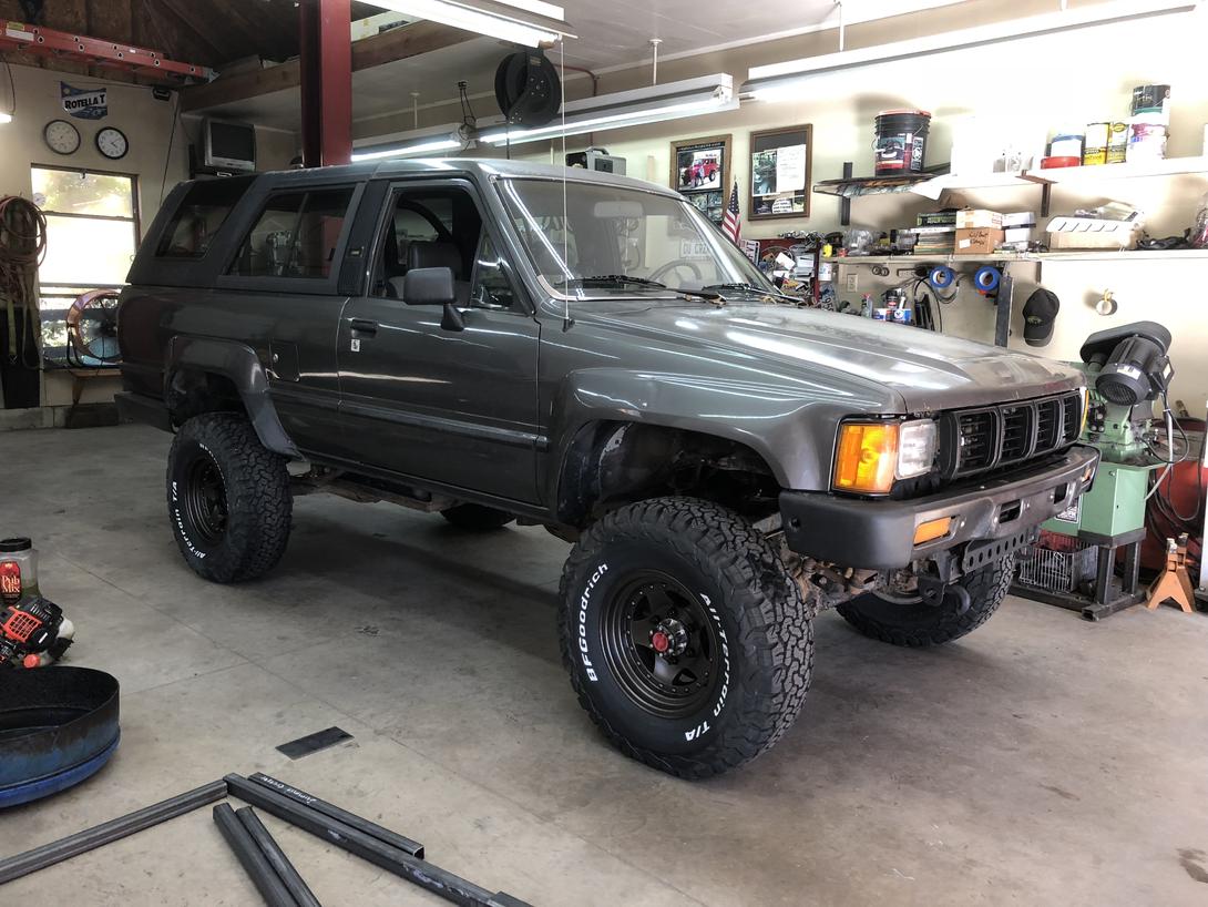

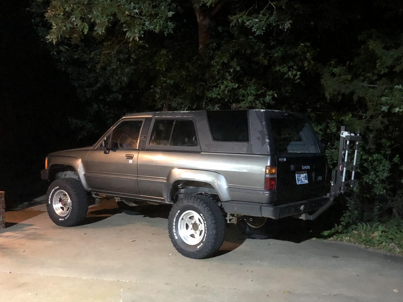

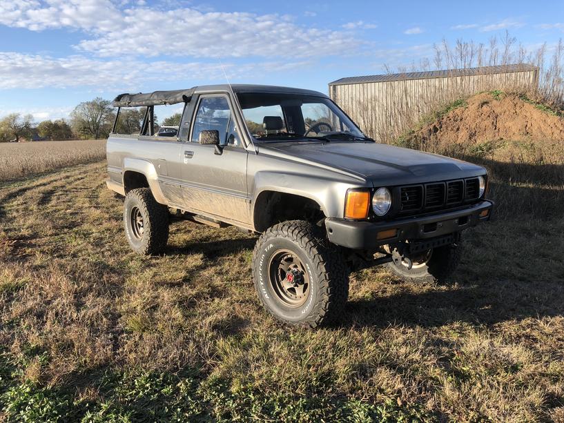

Good day today with a pretty good amount of progress.

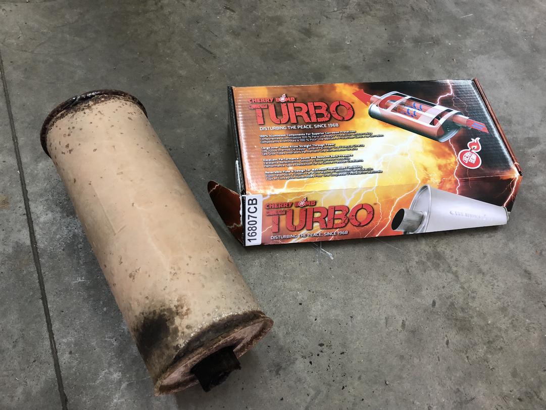

Welded on a new muffler.
Washed it.
Cleaned all the door jambs.
My dad fixed the dented in and rubbing gas gap lid. It’s now perfectly clearanced and flush all the way around.
He also put on new wipers, and stripped and repainted all of the arms.
Broke the top shock nuts loose on the front.
Started gutting all non “essential” accessory wiring. Now the stereo is the only thing wired in with wire nuts and who knows what else.
Allso started soaking the cam bolts so I can adjust the camber.
Diagnosed my inoperable rear window to the tailgate switch. I grounded it by putting a paper clip between the green and blue wires on the plug. The best it has worked yet.

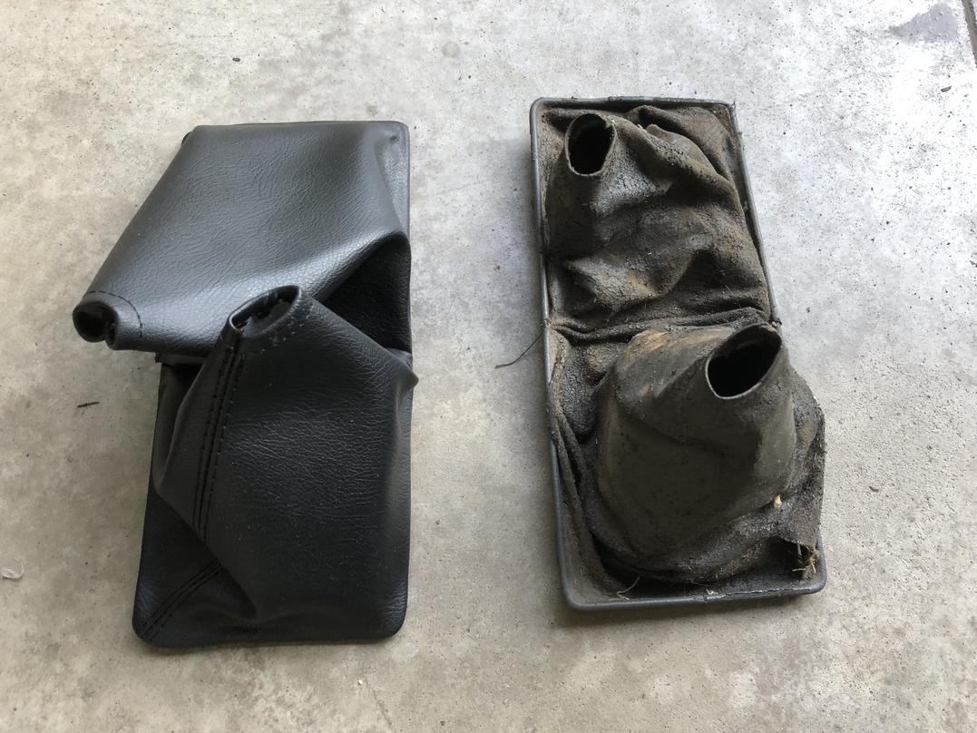

Cleaned up interior parts and put it back together with a fresh shifter boot.
Found the transfer case shift knob cover and glued it back on.
I cleaned the rear window switch and scraped the contacts etc. I plugged it back in and it made a slight sound of operation but then nothing. I took it apart again and scraped every surface perfectly shiney and nothing. So I’m not sure what’s going on there but it still works perfectly from the hatch.
Welded up the hole in the passenger quarter panel to stop water ingress.
Welded on a new nut to hold the rear outside passenger seat bolt.
Swapped seat bottoms from side to side and taped over the ripped one. It’s now pretty much hidden behind the console and should be fine until I can redo the entire interior.
Seat cable fix with cable Knarps. It would slide and tilt, but now just tilts. Probably going to have to mess with the cable tension to really dial it in and maybe solder the end so it can’t become slack.
Took off the drivers rear cargo panel. That plastic is seriously bad all around. I don’t even think I’m gonna put it back on. I also found the first signs of rust in the quarter panel so I’m going to address that.
I also sorted through the mountain of plastic in the back of the truck. Ended up finding the kick panels and installed them.

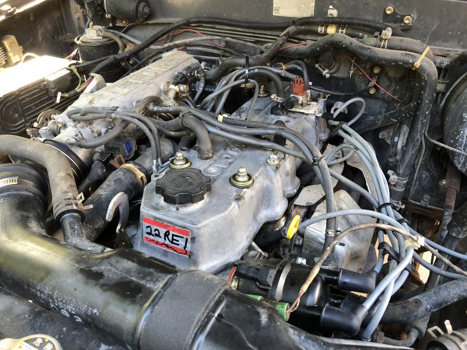

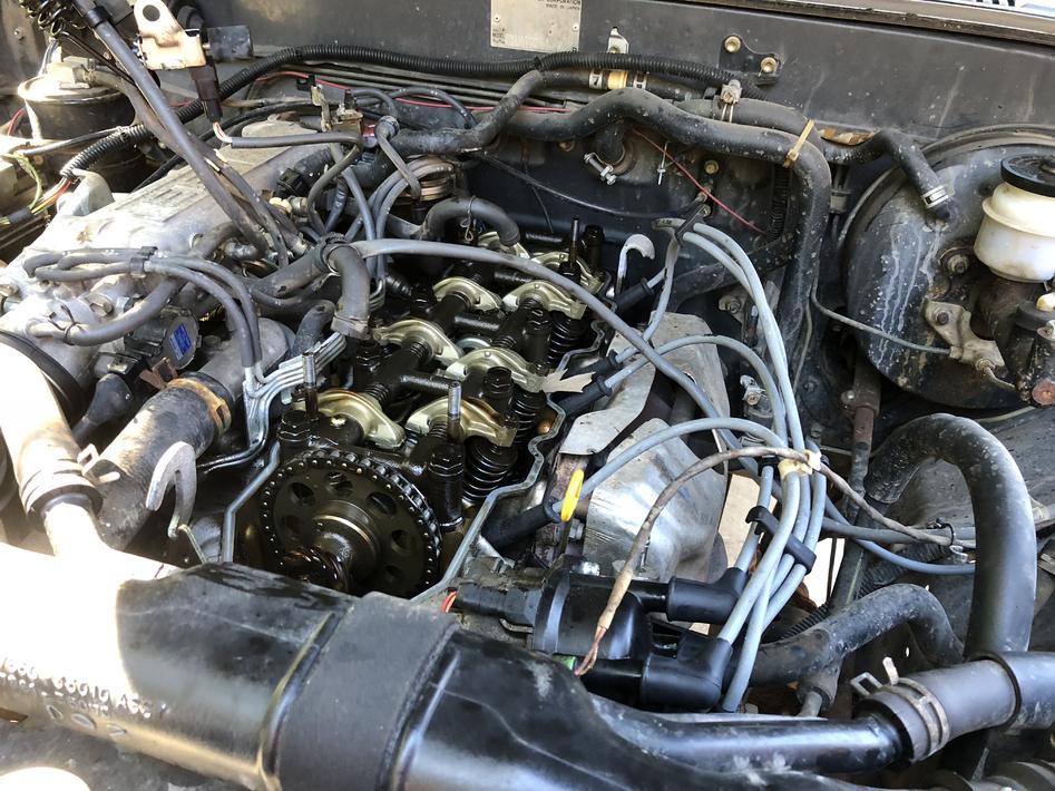

Replaced the valve cover gasket, grommets, and half moons as well as the PCV valve and grommet this morning. Also fixed the 22RE sticker haha

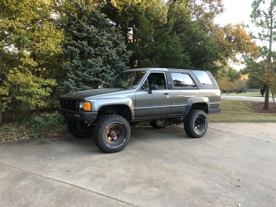

Went out the other evening and ripped around some gravel roads out in the middle of nowhere. New Bilstiens have it riding a lot better but it still rides like a truck with the leaf springs in the rear.

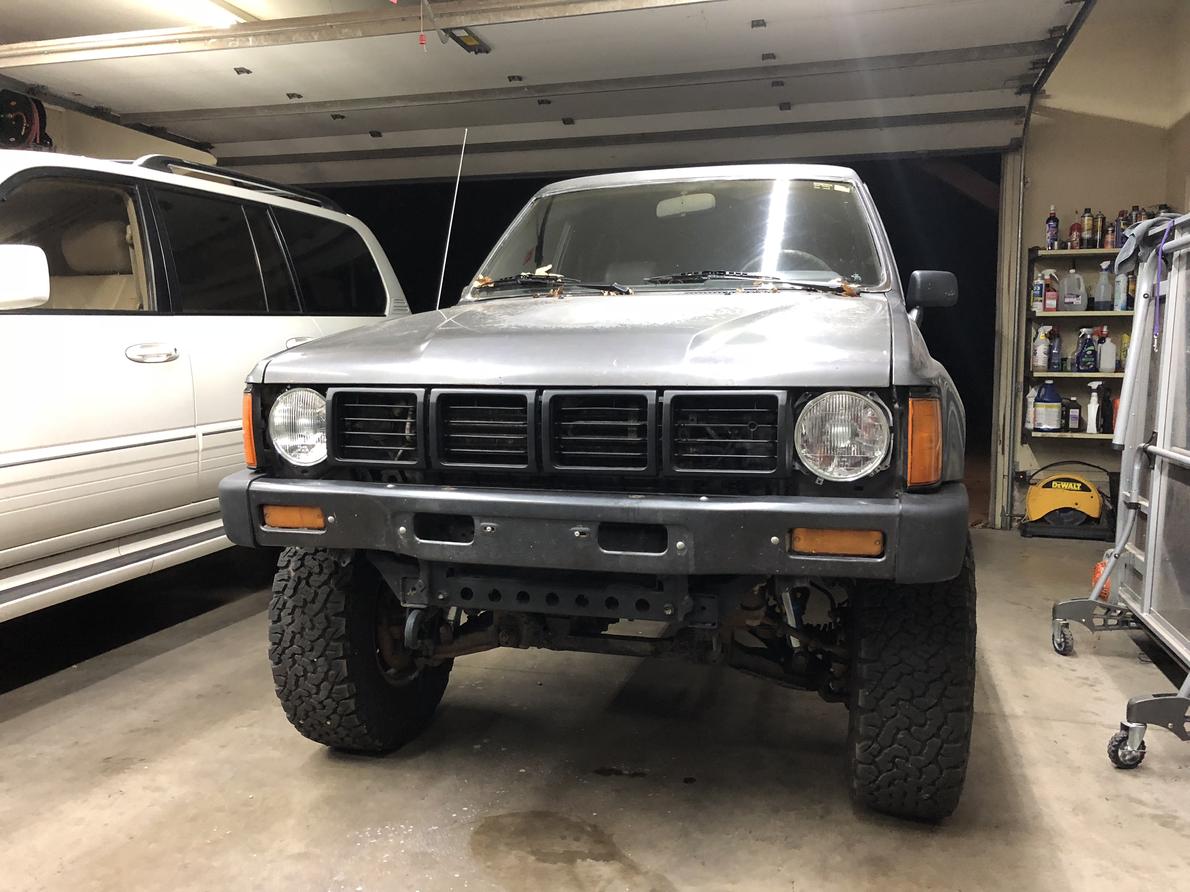

Also put on the round headlights last night and gained a tremendous improvement in light output.

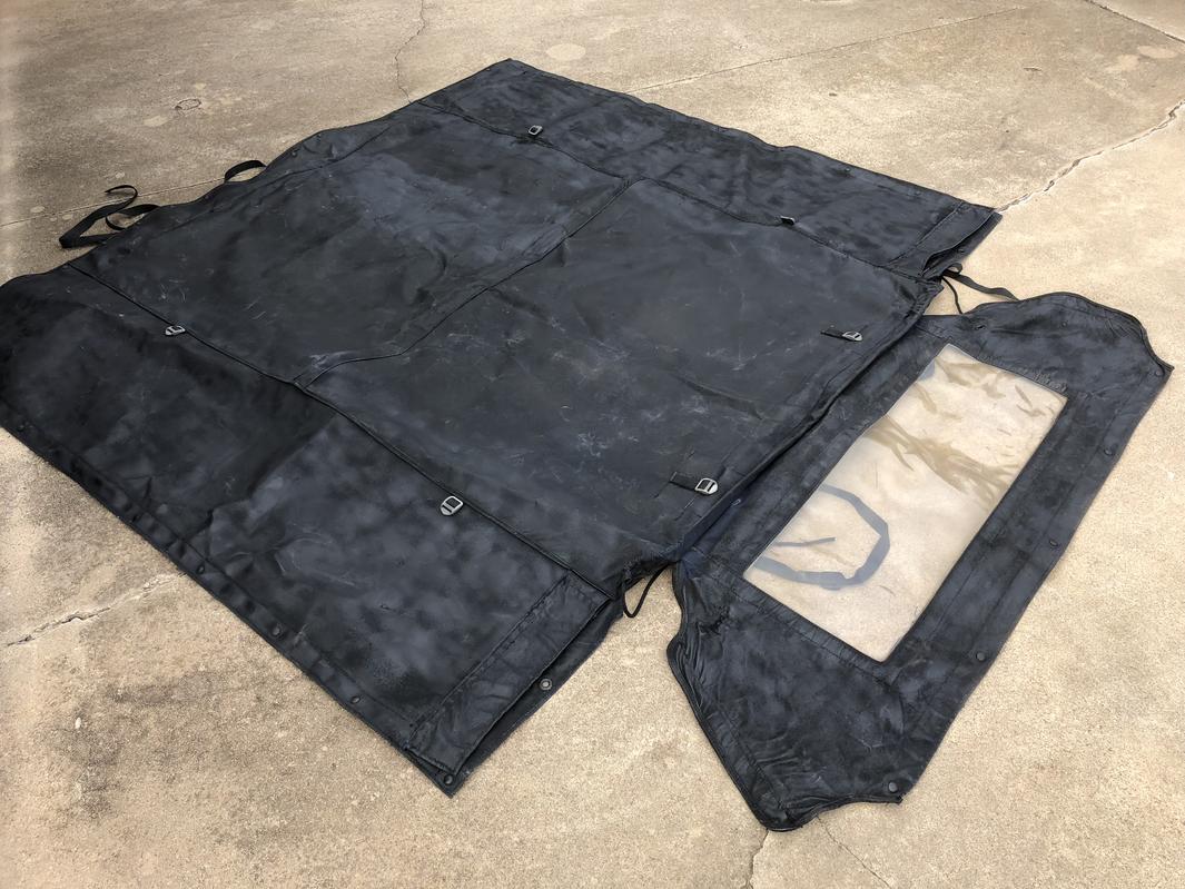

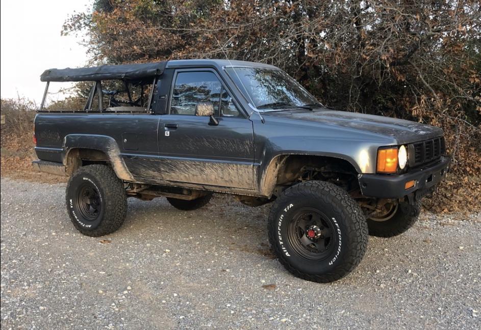

Put my $50 soft top on. Figured out it is a canback so pretty stoked on that. I also cleaned out my AC/heater blower fan.
Been awhile since I updated here since image uploading is such a hassle compared to ExPo.

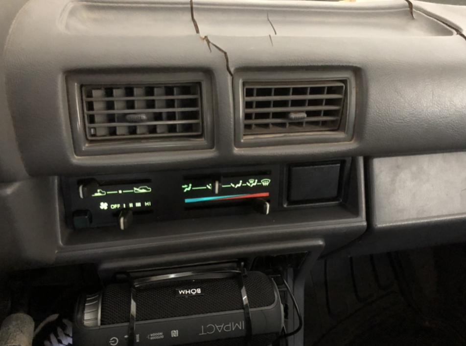

new ac control panel

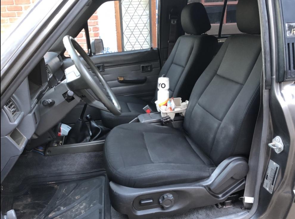

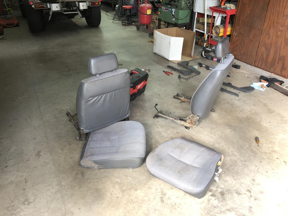

2016 Ford Police Interceptor sedan seat install
-driver's has an electric 6 way adjustable base, lumbar, tilt
-passenger's is manual, and I have spent about 15 hours so far working
remounting the oem sliding base to this seat. A little bit more work to
get it sliding and tilting with just the side lever will be necessary.
RX300 head rests for rear seats
RX300 heated seat switches (Will install heating elements with new interior)
