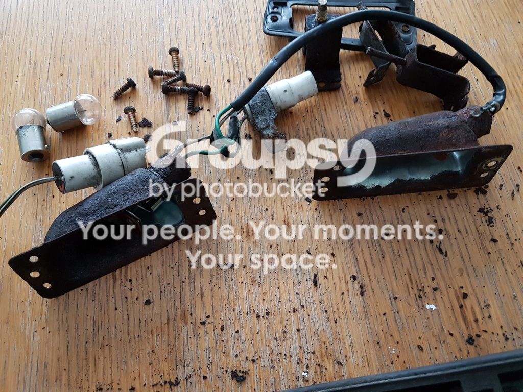

We restored the license plate light bar.
Before:
After:
The PO had those plugs disconnected, maybe because he was having problems with the rust?.

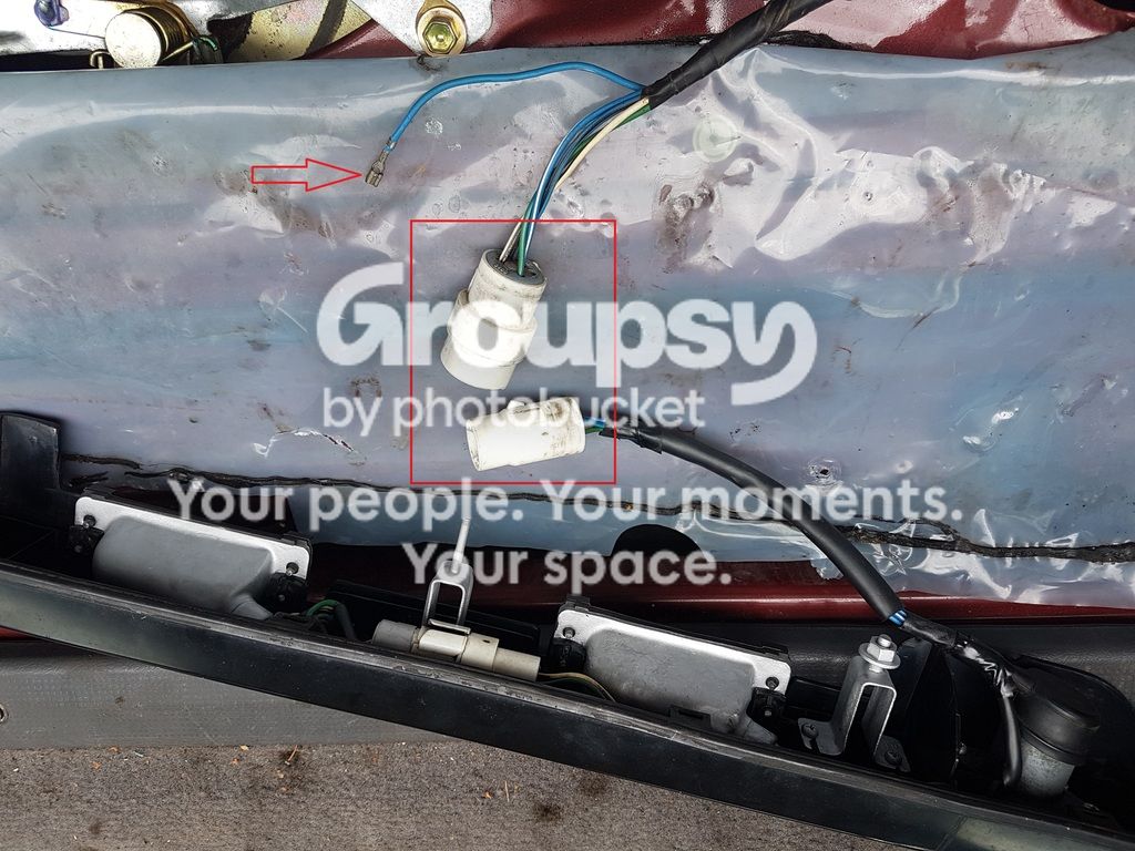

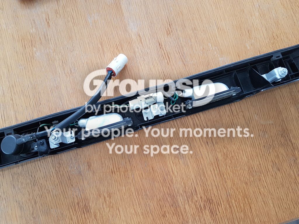

the lights work after the restoration, but I can't find what to do with that connector pointed with the red arrow.
Beside that, I can't roll up/down the tail gate window from outside using the key (but it works with the center console switch). Maybe it's related with that little connector?

I didn't open the key cylinder yet because I think my problem's another modification the PO did. You can see that connector pointed with a red arrow (my first post, third photo), I really don't know what to do with it.

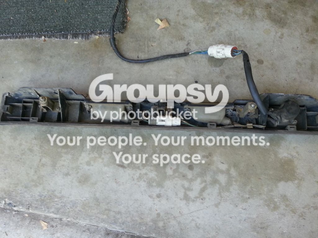

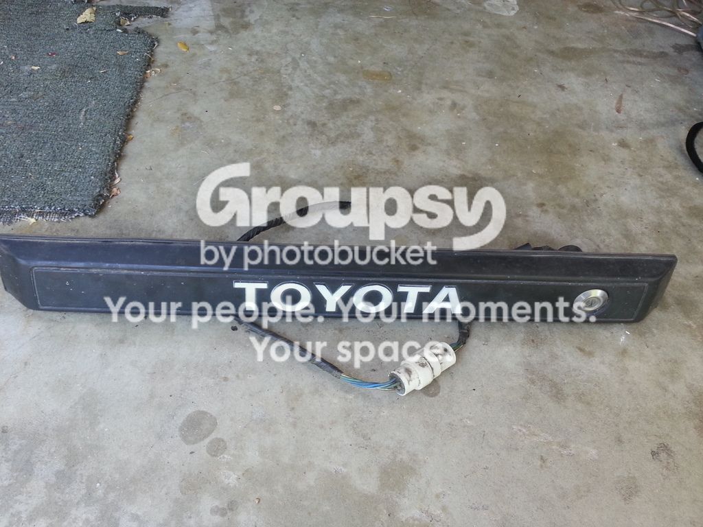

Looking at photos of other licence plate harnesses, I just noticed that they don't have that connector. So my question's why the PO did this mod. I guess I have to undo what he did and try again. Suggestion?
These're photos of a license plate of other 4R, not mine, you can notice the difference:

Update:
I reconnected that blue wire pointed with an arrow you can see in one of the photos above. I try the key in the rear gate and the window rolled down a few cm and stopped. After that I checked the terminals inside the connectors and they were rusted/corroded. I removed one by one, cleaned and installed them again. The window rolls up/down perfectly now.
I still don't know why the PO disconnected that wire...
