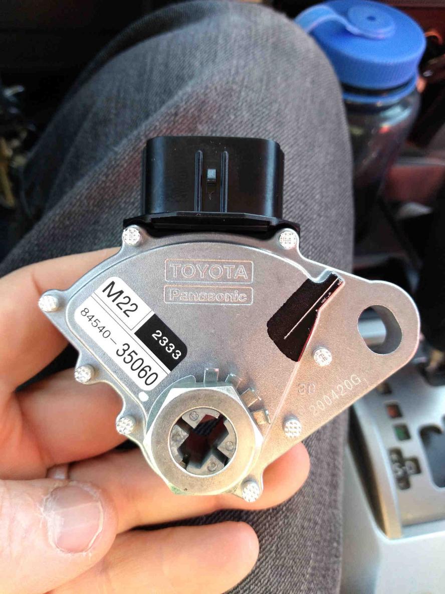

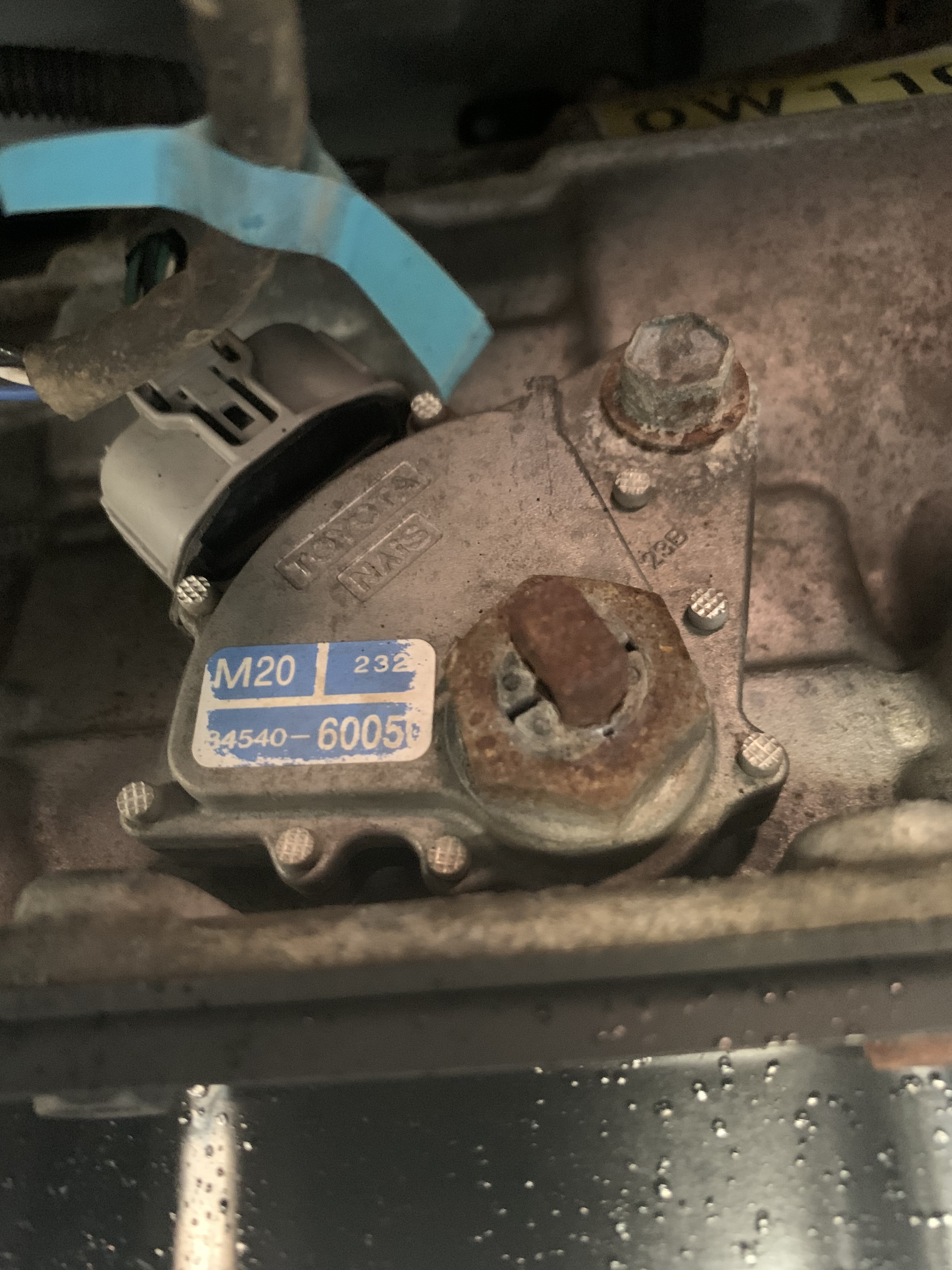

I ordered the 84540-35060 version even though some sites said the 84540-60050 fit my year. The 84540-35060 works great. Here are some photos and notes from the swap.
7 years of new england winters left the shaft highly corroded.

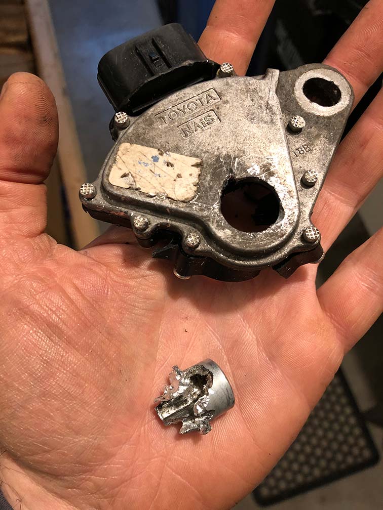

The bolt and the nut came off easily, but the shaft and the switch had completely fused. I couldn't separate them using penetrating oil, heat, and a crank puller. It took over an hour of carefully drilling away the switch with a dremel tool. I don't know how much the dealership would have charged, but for me it would have been worth it to have them deal with the replacement.
AF1QipPFJ9V-Jz5Fdb-MG0z7SrcxBdX6YlSHxeKSPuXsSTTg6cC-yF8IUUQ-przpUw3WRg
When the switch came loose, I had to sand away all the corrosion on the shaft before the new switch would fit. A healthy layer of anti-seize between the two will hopefully prevent this level of effort the next time around.

Toyota Canada Part number for the NSS is 84540-35060.

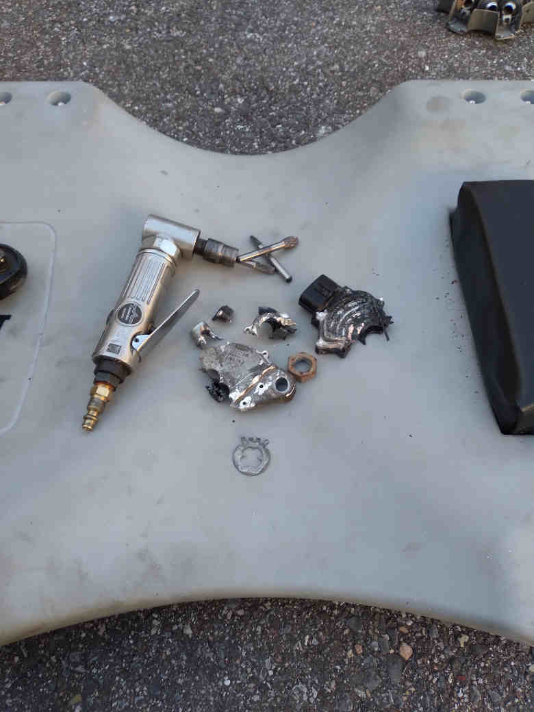

Here's mine after sanding the crap out of the shaft and breaking one of the ears off while giving them a good ping with a punch. I ended up breaking all the ears off to make it easier to free.
145k miles on a 2012. 5-6 hour ordeal, start to finish. Real pain getting it to move just a little that first time. After that, it was still almost another hour until it was completely off.
The boss for the lower trans line unfortunately was the best prying point. It's all good now though.

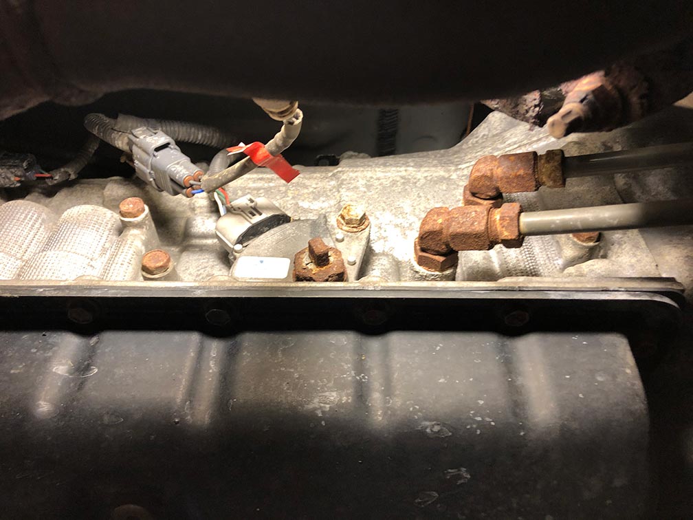

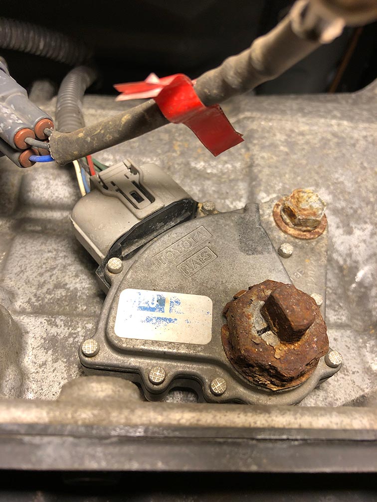

Took some photos of the switch on my rig:
I shot some penetrating oil on it today in hopes that will loosen it up a bit, maybe it'll make it through the winter.

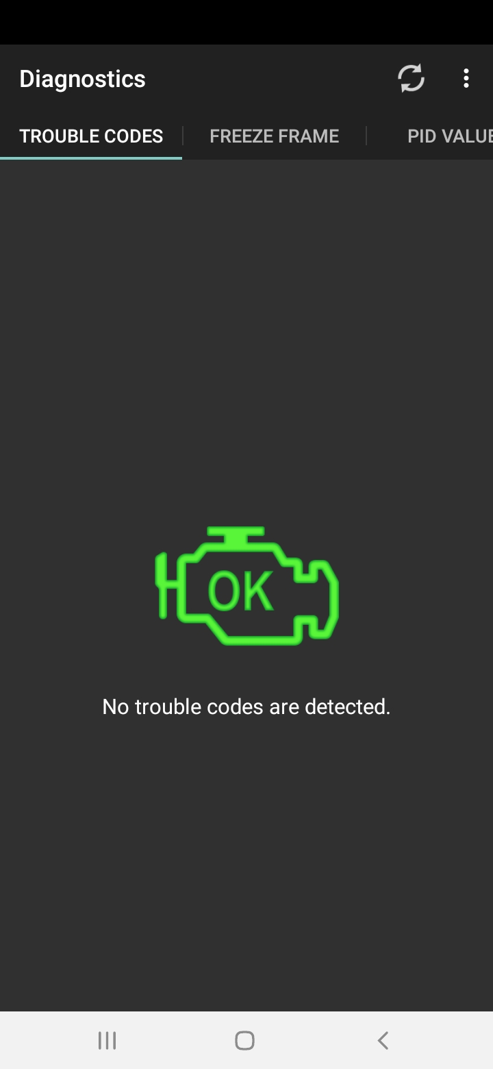

Similar story here. Didn't notice any difficulty shifting but got a CEL and the slip indicator illuminated. The code was P0705 (Transmission Range Sensor Circuit (PRNDL Input) )- i.e Neutral Safety Switch. The part ran $ 170.54. I ordered part number: 8454035060. I wasn't kind to the old part getting it off. After installing the new part, I was a skooch off in alignment. I could just push the gear shift a bit and then the correct gear would illuminate. So I had my son in the car while I adjusted it until "R" and "D" illuminated when in "R" and "D". After driving back and forth to work the permanent codes were cleared and have stayed clear.

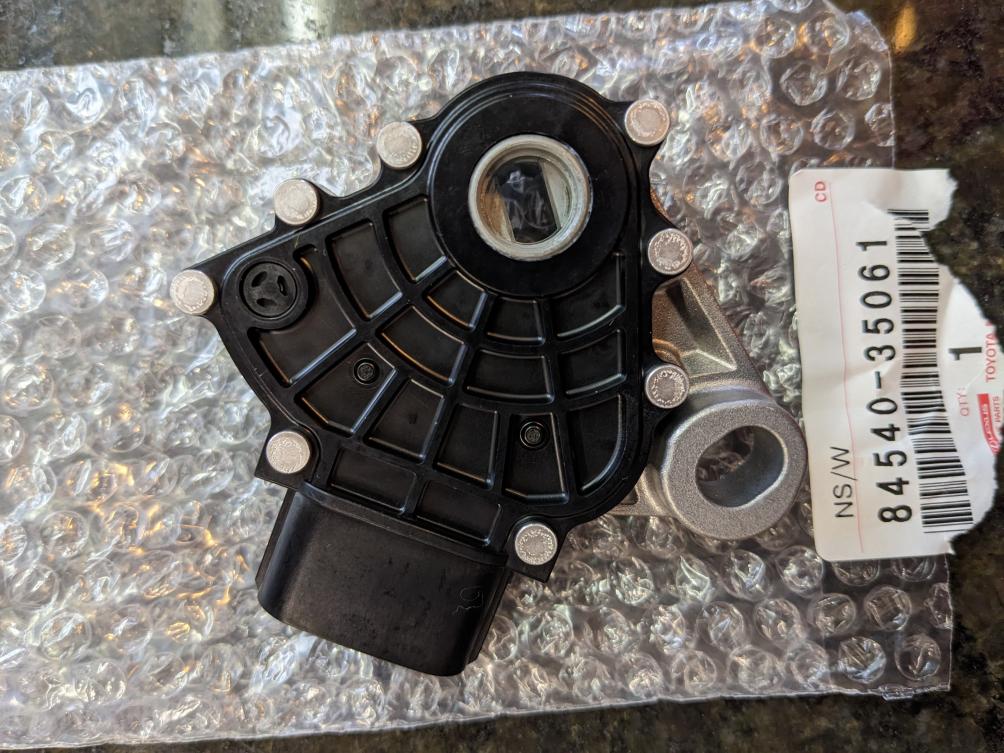

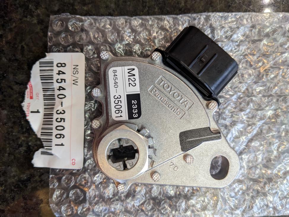

The part number from Toyota parts direct is now 8454035061. Picture of the new part is attached. Other than the casting number on the front, it looks identical to the previous replacement switch.
With tax and shipping to Ontario the switch was $257 CAD. This is quite a bit less expensive then from the local dealership.
