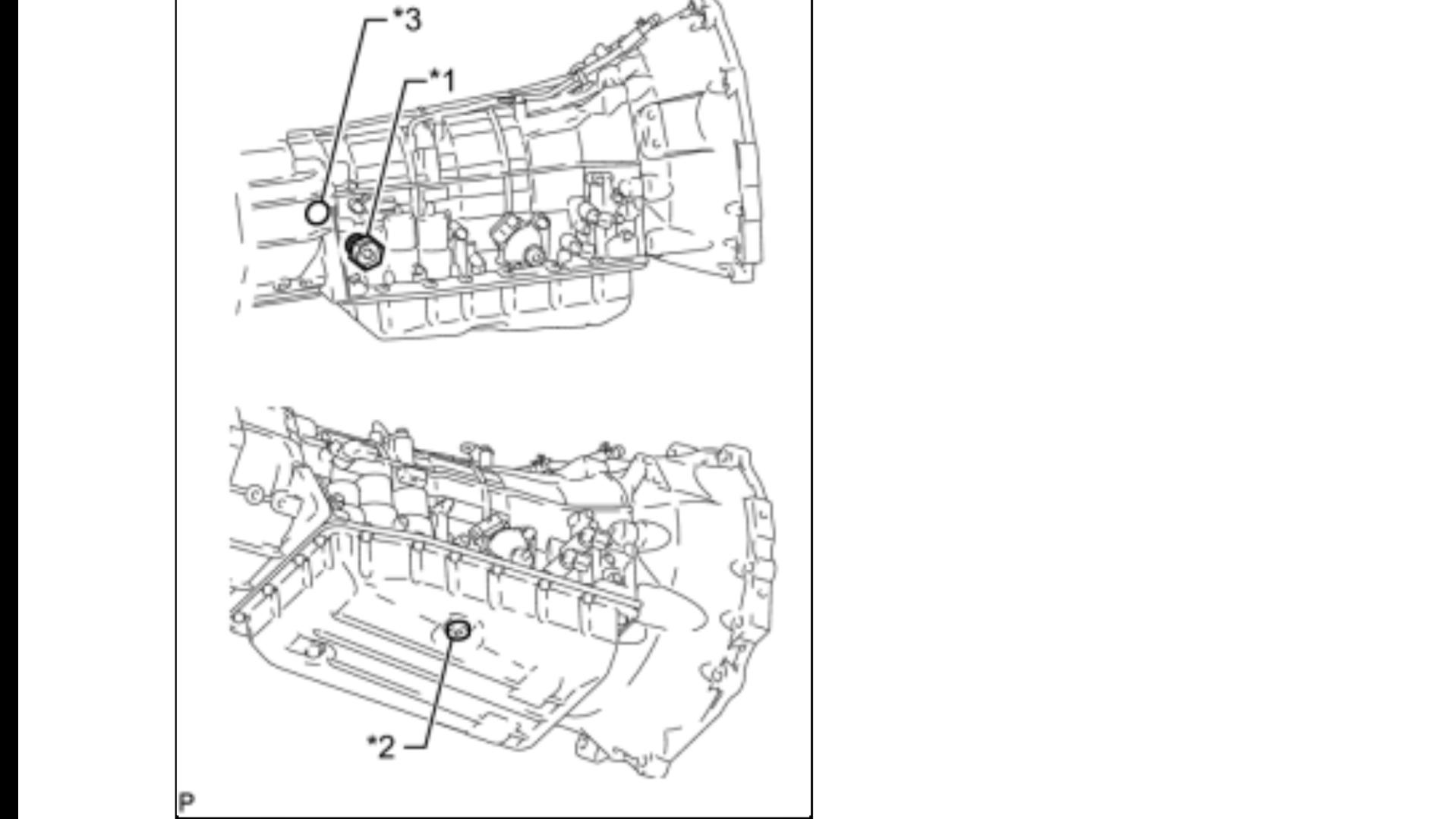

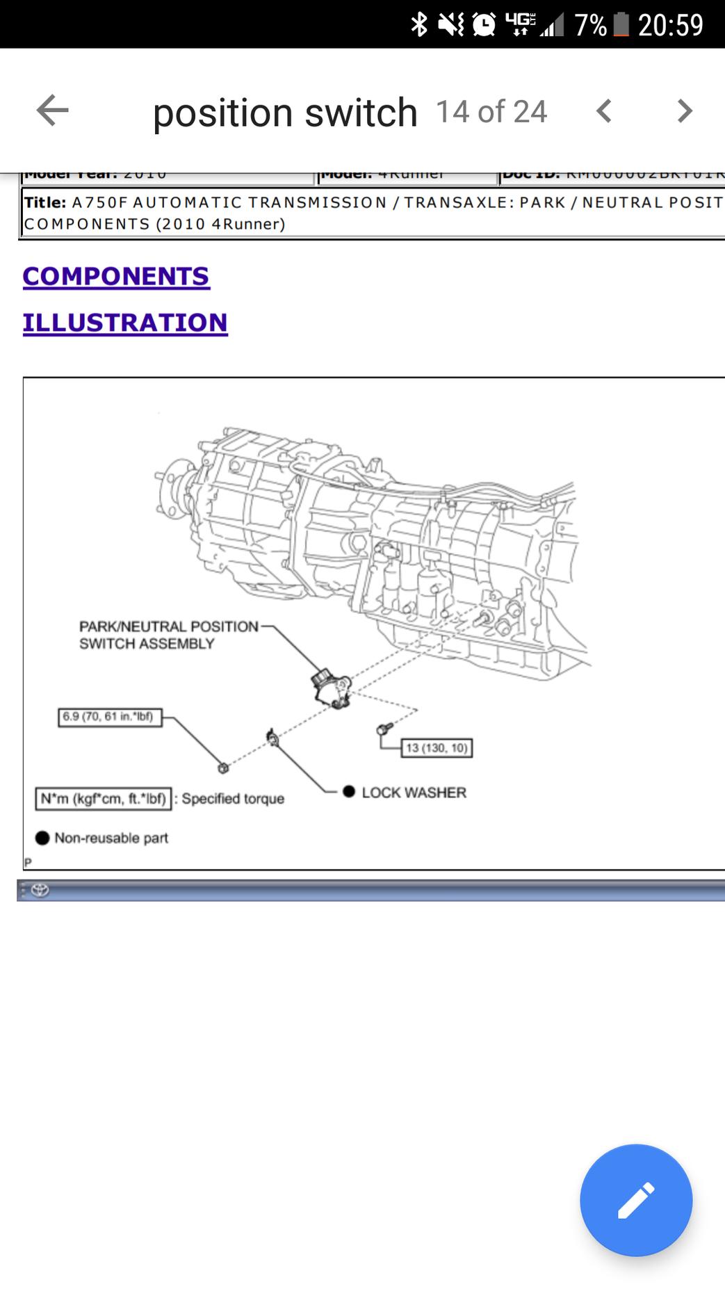

If you have the 750 transmission then here are 2 diagrams
The second diagram is for a different part, but still shows the switch.
Yes, thats the correct picture. The one in alldata is incorrect.

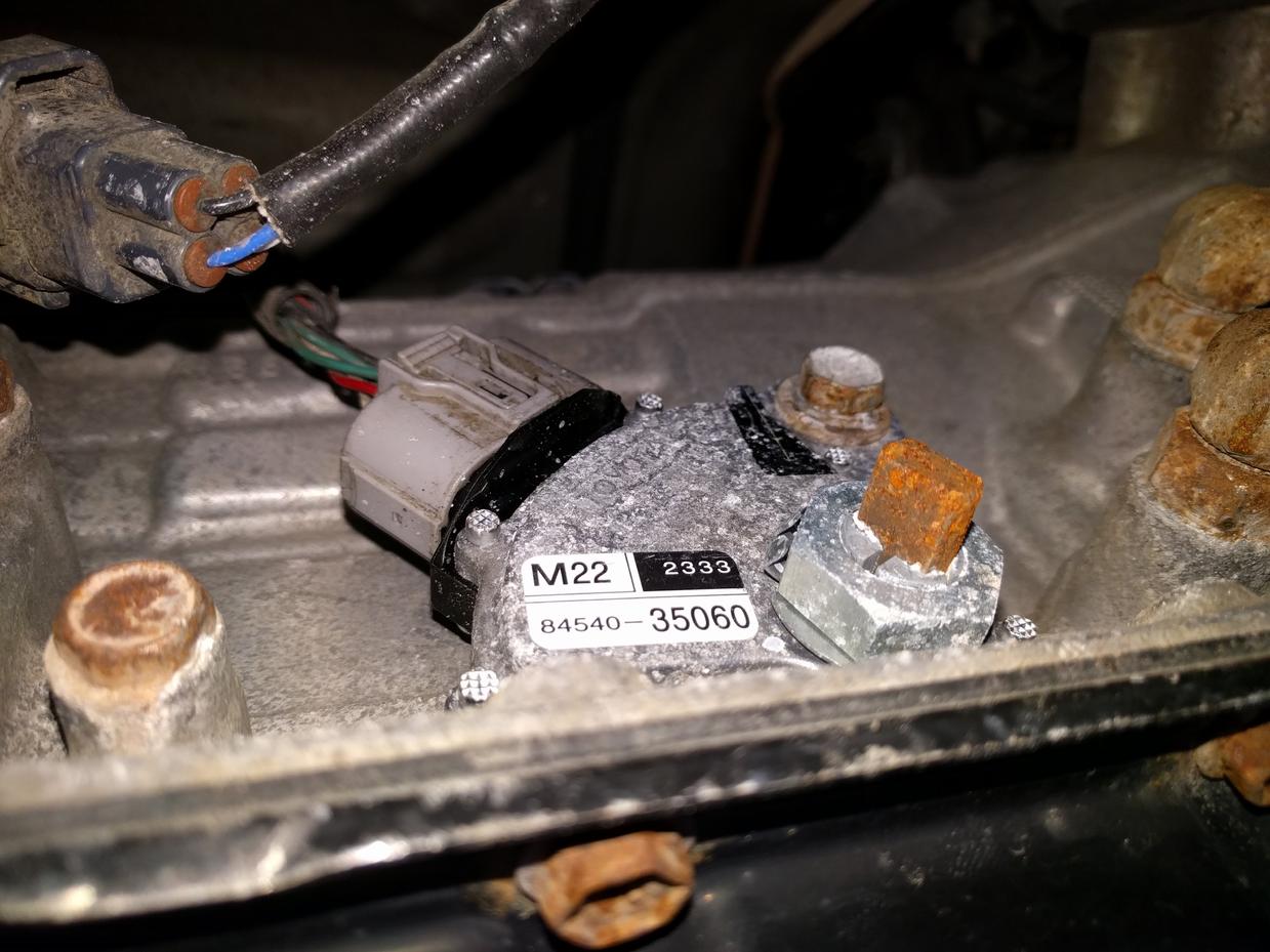

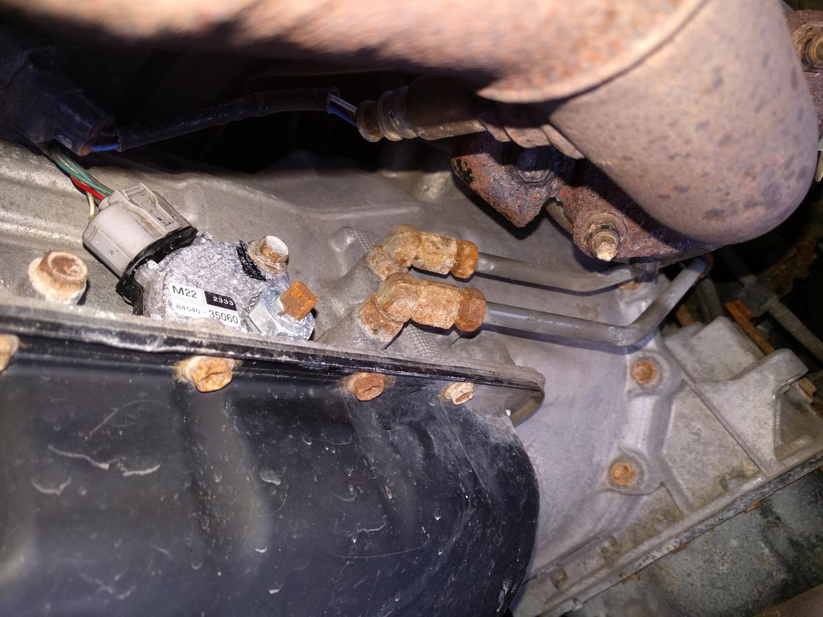

The park neutral safety position switch on this truck is on the passenger side, NOT the drivers side like all the forum posts I have seen.
Its a 12mm nut on top, and a 22mm nut in the middle. Theres a lock washer with 4 tabs that need to be pried to 90 degrees, before the 22mm nut is removed.
A regular length box end wrench fits to remove both nuts, and is what I used. A socket wrench is probably easier to use.
There is no shift cable to remove, as the shift cable is on the drivers side.
You access the switch from under the passenger side of the truck. It can be reached without lifting the vehicle if you are 'slight'. Its located basically just behind the front tire line, just past the bend of the exhaust down pipe on the passenger side.

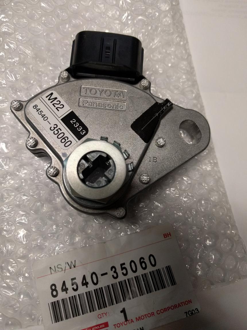

There's 2 replacement parts available. The old part number is 84540-60050, and the replacement new part number is 84540-35060. The new one is about $30 more at toyotapartsdirect. Both look to be available, and now waiting to hear back from them if there's any difference they know about.
The old part number is only available in the US. The new part number 84540-35060 is whats available in Canada now. Ordered and waiting a couple days for it to get here. Its a warehouse stocked part at least, so it should take only a couple days to arrive.

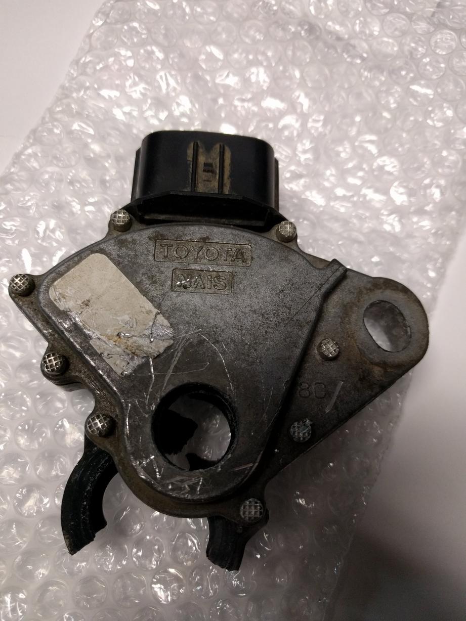

I attached pictures of the front and back of the old and new switches.

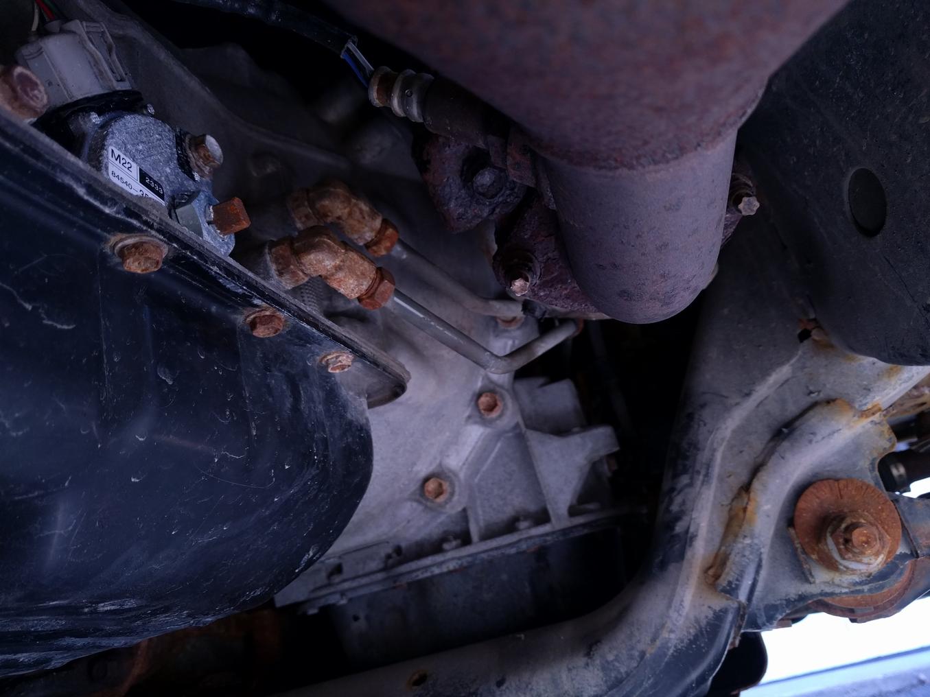

Its freezing and I spent too much time already messing with this. Maybe I'll take a picture of where the switch is under the truck tomorrow.

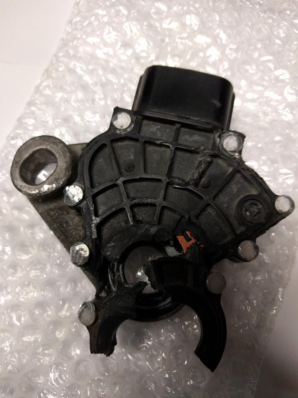

Front of the old switch:
Back of the old switch:

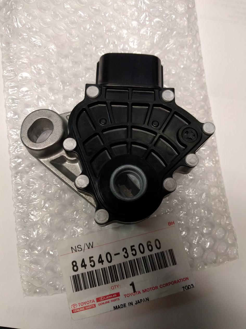

Front of the new switch:
Back of the new switch:

Here's how the new switch looks installed on the truck after a couple weeks of Canadian winter.
Note again its on the passenger side, not the drivers side where the alldatadiy picture and other howto's show.

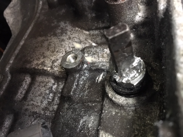

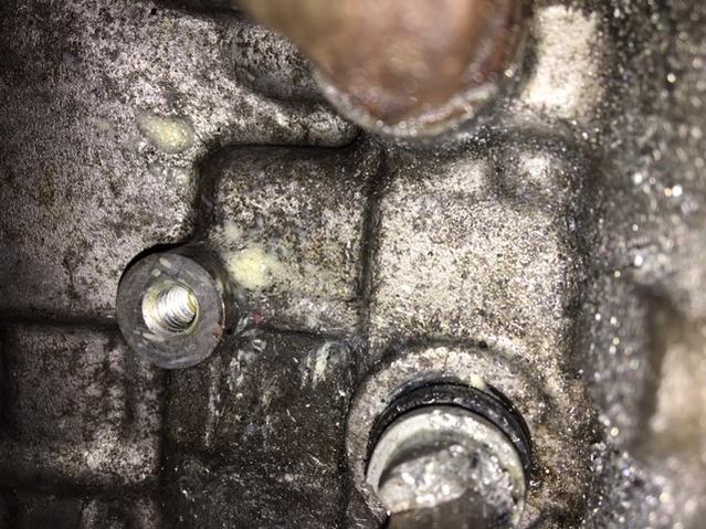

Toycan - Do you recall a black rubber washer between the range sensor and the transmission casing? I think the black washer slipped out the old range sensor when I pulled it off, but I could be wrong.
Just to be sure, I changed the neutral safety switch, and your pictures look like the same part. But your message said range selector switch, which I think is a different part. Just making sure we are taking about the same thing.
I'm quite sure mine did not have anything between the neutral safety switch back, and the gear selection stub on the right side of the transmission.
The new part did not have a black washer. The new part only had the switch, a nut and locking washer for under the nut on top of the switch.
The back of the switch where it faces the transmission is black. I had to destroy the switch to get it off the truck. One of my pictures shows the back black plastic casing all ripped apart after removal. I can see how there could be black bits that might look like parts of a washer.
