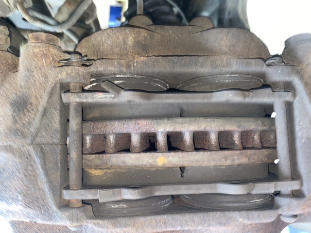

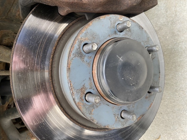

Had my 07 for about a year now and can tell those front pads are thinning out. I’m going to give a shot and change them myself. I did an inspection this evening.
Noticed that the spring clip that holds the pads is missing. The caliper pins were also pretty rusty. Also looks like there are 2 small cracks in the pads themselves.
Should I just go ahead and replace the rotors and calipers?
Added some pictures if anyone is able to give insight. Thank you!

those brakes look new clean and lube the pins and get new clips for pads take pads out clean and lube the contact points on the caliper to pad, are the brakes pulsating or squeaking if not leave them alone.
Thanks for the feedback. I wanted to take out the pads and look at them, but ran out of daylight before I could get those pins out. The reason I am looking at changing them is they’re getting soft on braking especially downhill. Also I had a mechanic inspect when I first bought it and they said the pads had 30 percent left. Since then, I’ve driven nearly 14k miles. I went ahead and bought some powerstop pads a couple weeks back, so I may just change them out. I don’t have to remove the caliper for that do I?
Unless you are getting pulsing brakes, or pulling to one side, the pads are newer. Id put the wheel back on and drive it. Compare pad thickness to the other side. If its similar, you should be fine.
If the braking is not as good, the calipers are probably seizing and may be time to replace the calipers and pads.
If your braking feels soft is likely more out of a need to do a bleed & get fresh fluid in there. Those pads look almost new.
No pulsing or pulling that I can tell.
Actually braking seem more firm today after moving those pads around a bit last night.

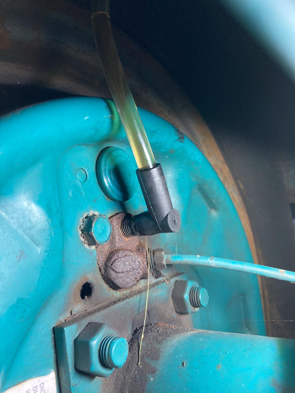

This works for me everytime. Front brakes: set your catch cup in place and put the hose on the bleeder valve with the hose going straight up. Then crack the bleeder open. Go to the drivers seat with engine off, slowly depress the brake pedal down to the floor and slowly let it rise up til it stops, do this 4-5 times and recheck master fluid level and volume in catch cup. Top off and empty as needed. If you need to empty the cup, close the valve so air does not enter caliper. Repeat again until fluid coming out is clean. Lock down bleeder and remove catch cup. Switch sides.
Rear brakes on 4runner: same as above but instead of pumping pedal, turn key to on and let booster run, turn key off and back on letting the booster cycle again. Check master and catch cup every two cycles. When the fluid is clean, lock down bleeder and move to next wheel.
By running the hose up from the bleeder valve it keeps air away from the bleeder valve opening even if flow reverses. Works like a charm every time. This picture is of my boat trailer brakes. Any air bubbles will naturally rise in the fluid line. Pumping brakes slowly lets the air bubbles escape far enough in the line and not get sucked back it,
*normally a full catch cup is enough to purge the entire brake line.
