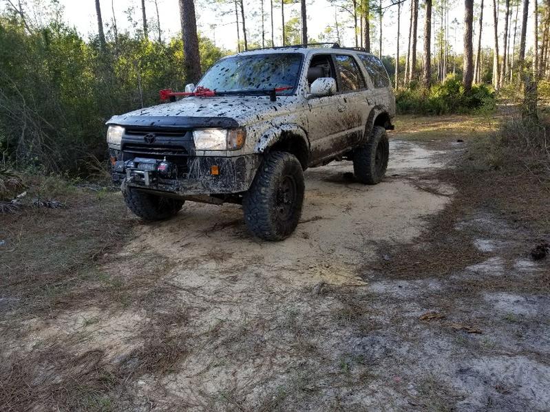

Literally all you have to do to disable the dethrottle capability is lock the center diff. Then, you can do all the donuts and mud spraying you want (see below). You will occasionally get the antilock brakes kicking in to keep the wheels spinning the same speed, but it has never stopped me from getting sideways when I want. If anything, the ABS occasionally kicking in to force powerto the slower wheels actually helps ensure both wheels on an axle are breaking lose, as opposed to a one-tire-fire.

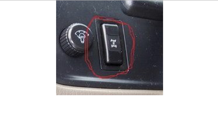

Sorry I completely missed your comment I apologize. The only buttons I have are skid control like the image attached
Or is my best the video below?

On 01/02's that is the Center Diff lock button (which also deactivates traction control)..... :cowboy:

That's your center diff lock button... if you are on truly loose terrain, that should be engaged/locked.
Otherwise, you are in 'AWD' mode, which is meant for mixed conditions on-road, mostly (snow/ice, etc.) where you want traction control.

Gotcha!! Believe I understand now. This is when clicked into 4wd only correct? So this button has no effect on 2wd mode. That’s actually what I was referring to if I wanted to stay in 2wd
