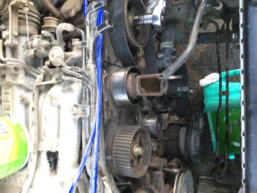

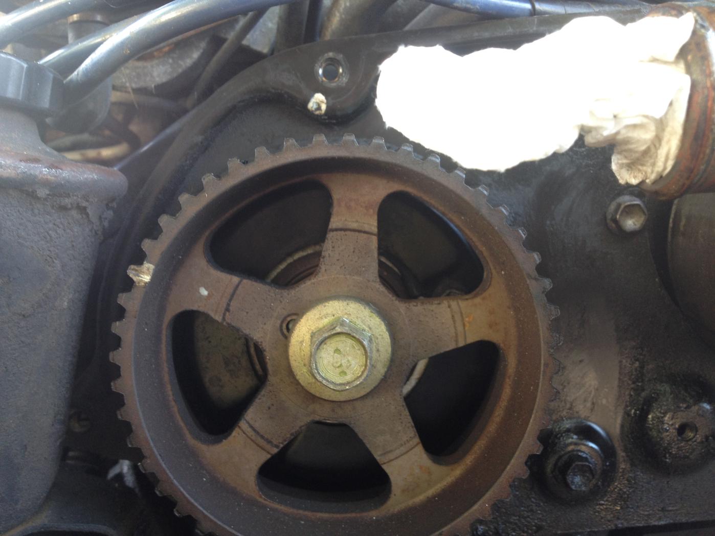

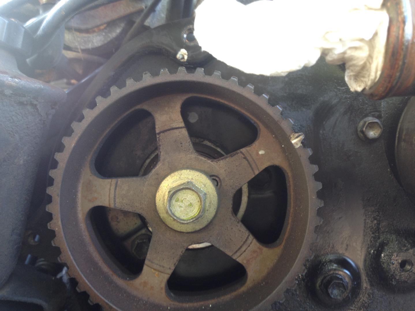

ok so im alining the cam shaft sprockets and the one on the left isn't even close to alined. iv did 2 full revolutions and still nothing. heres some pics that show hof fare away the white marks are. i can aline the marks and get it to stay but on the right side i can aline the marks when the spring releases and it automatically alines its self.

I'm no expert so maybe I'm not getting it but I believe your problem is you have slack on both sides of your belt when you're releasing the tensioner. You should line up all 3 marks, run your belt across both cams and under the top pulley with no slack. Then put it around your water pump and the crank again still with no slack. The belt should line up with the notches on the crank pulley. So from your left cam sprocket (looking at the front of the motor from in front of the motor), under the idler pulley, around the right cam sprocket, around the water pump and finally around the crank there should be no slack. All slack should be on the tensioner side between the left cam (again standing in front of the motor) to the crank. Slowly release the tensioner and viola!! Everything should be hunky dory.
Take a 17 mm socket and ratchet and bring both cams to the marks straight up and same with the crank mark Then put the belt on

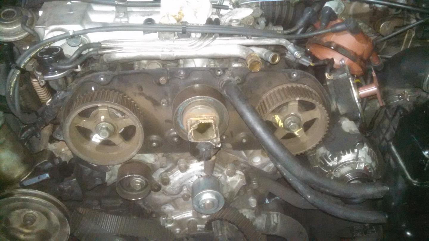

Quick question.. Does it matter which way the cam sprockets face when installing them? I am on middle of a timing belt change and noticed my sprockets facing different as you can see from the photo.
It does matter but I believe yours are wrong. Here's a picture of mine. Sorry it's sideways. What year is yours?

Its a 1991. I've seen them so many different ways I am not sure what's right. Even on the Haynes book they are different on a couple their pictures.
