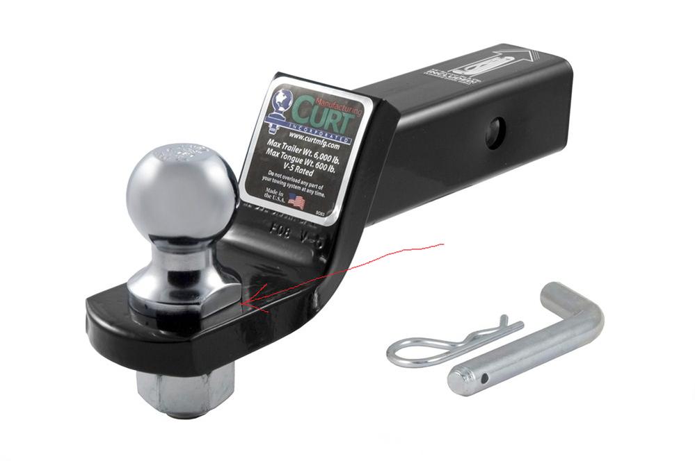

I will also be towing for the first time like OP. I just bought a trailer and I went to the passenger side compartment to open the Toyota ball mount for the first time and I noticed in the bag with the locking pin there was a metal ring what is this used for? I have to say The 4runner's features still surprise me after 10 years of ownership. Like it has electronic braking and is prewired all I need to do is install the controller.

What kinda of metal ring? Posting some pics might help
Both of you guys be sure to check the latch and ball system. Make sure it is secure and the latch is under the ball hitch. Double check after the Uhaul guy does his thing, you can never be to sure. Dont take it for granted that the Uhaul guy did it correcrly. Its your rig, your responsibility. Whenever you stop for fuel or food check your trailer. Towing is easy, you just have to remain aware and dont forget you are towing, it happens.
That ring is optional if you need it to make the ball fit snug in the hole..... :frisky: The smaller balls need it, your 2 inch ball will not. Grow up everyone....

Here is where the ring goes, if needed.

Thank you guys I am using 1 7/8" ball so I guess I will need to use the ring. Thanks again for the help.
Update: I Just tried to put the ring in between the tow ball and locking nut and now the ball spins around freely

A hitch will typically have either a 3/4" or 1" hole to accept the threaded shank of whatever ball you're installing (which will also be either 3/4" or 1"). Your metal ring is a spacer to let you install a 3/4" diameter shank into a hitch with a 1" hole. If the shank fits snugly into your hitch, you don't need the metal ring.
The ball size won't affect whether you need that ring or not, your 1 7/8" ball may or may not need it. It depends purely on the shank diameter. If the shank fits really loosely in the hitch, you need that ring installed.
