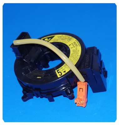

something that I am wondering is how the "firing" is determined, I swapped a 96 airbag (1st gen) into my '98, which I would assume had 2nd gen ones. I'm planning a steering wheel swap with steering wheel controls from the mid 00's toyotas, but am stumped at the airbag.
The 2003/04 tundras and sequoias used a single plug connector like this:
and the rest all use a dual plug one like this:
my question is if this dual plug one can be used (assuming i get the corresponding clockspring, they use the same wiring as the single plug (12 pin connector), only difference is that dual plug for the airbag) or if they're different somehow. Does anybody know?

I’ve been doing a lot of research for my 3rd Gen 4Runner, because I want to add steering wheel controls (swc) for audio. None of the 3rd gen’s have swc, so it requires finding a suitable later model steering wheel to substitute in. The problem is that swc and dual stage airbags started being installed at roughly the same time for the majority of Toyota models (2003-2004, with a few exceptions). You can’t (or at least shouldn’t) put a 4-wire dual stage airbag into a model whose wiring only accommodates a 2-wire single stage airbag. Long story short, I’ve learned that the dual stage airbags the OP is asking about started in 2003 for 4Runnners…aka 4th Gen’s.

Dual stage airbag inflators were added in 1998MY. This means anything built 8/97 and beyond. This is when the PN changed. I've seen people swap a 1998 airbag into a 1996/1997. I would highly recommend looking into whether controllers and sensors are the same in earlier systems and if the changes are only to the airbag assembly itself. I can tell you the seatbelts in a 1998 are different as well. Without knowing this you don't really know how the airbag will inflate until you crash.
