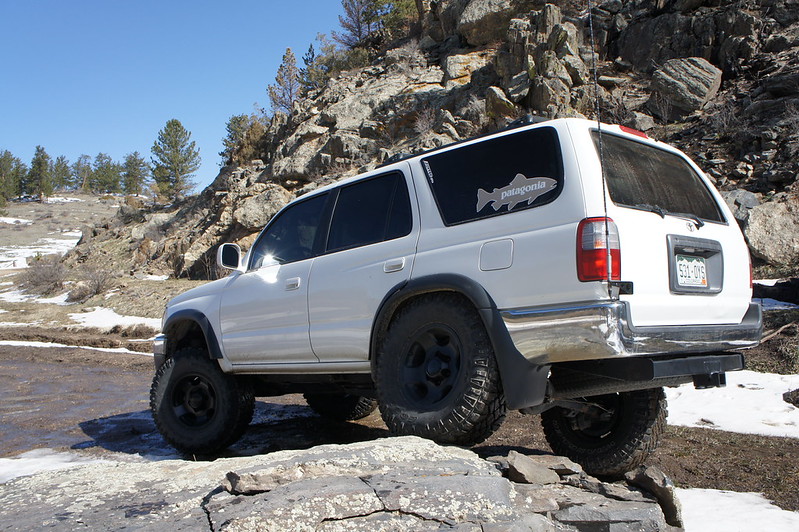

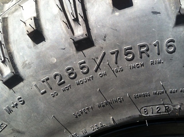

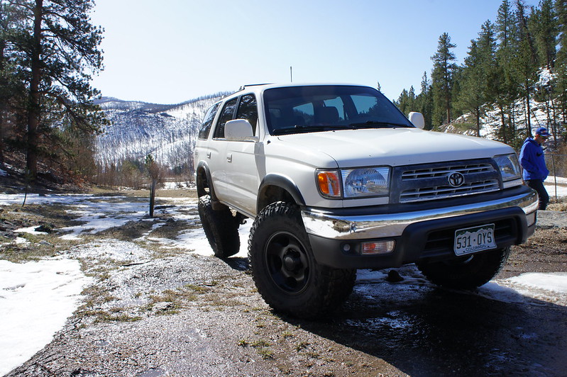

Found a good deal on some 285/75/16 duratracs with similar tread depth to my 265s, so I jumped on the deal. [MENTION=82211]TCMach[/MENTION] tempted me with his MTZs since he wants to step up to 35s, but the duratracs suit my needs well so I went with them. I'm trying to find a single FZJ80 wheel so I can pick up a used M/T for a full-size spare on trails or road trips.
Anyways, couple poser shots from the weekend. I took the 4runner up into the hills to do some research for a school project. Found this rock conveniently where we needed to park I wanted to see how the 285s stuffed into the wheel wells, so naturally I had to park hard.

I'm also in the process of repainting my grill. I was going to buy an aftermarket paint-to-match and have it sprayed by a pro in hopes that it would hold up to chipping better, but I don't want to spend the money on that right now. It will just be painted black since I have some paint sitting around.
Tires look damn good man. I'm only a little hurt you took those over my MTZs :tsk: haha. Oh well, lets get another wheeling trip in before school lets out, we will try and do something besides sevenmile :cheers:

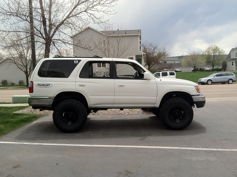

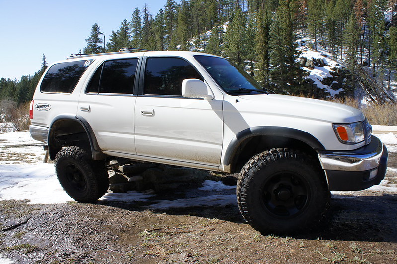

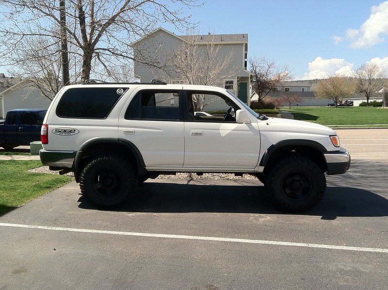

Completed a few more things over the last week - new lower ball joints and inner/outer tie rods with some wrenching help from [MENTION=82211]TCMach[/MENTION]. Wasn't planning on the tie rods, but we got the LBJs swapped and the tie rods were looking worn, so went to Napa for parts and did the whole deal.
Also swapped some my OME 890s for LX coils I bought from [MENTION=89400]MrHentoni[/MENTION]. Blue/yellow/white on the driver side and green/yellow/white on the passenger side.
Before:
Ground to fender height was 38.5" all around with the 285s.
Untitled by FR4R, on Flickr
After:
Front: 38.5"
Rear: 40.5"
I'm not sold on the 2" rake, but it's growing on me. I may crank the coilovers up 1/2" or so, still undecided on that. However I really like how the LX coils ride around town so far. Now it's time for longer shocks, longer swaybar end-links, and some extended bumps.
