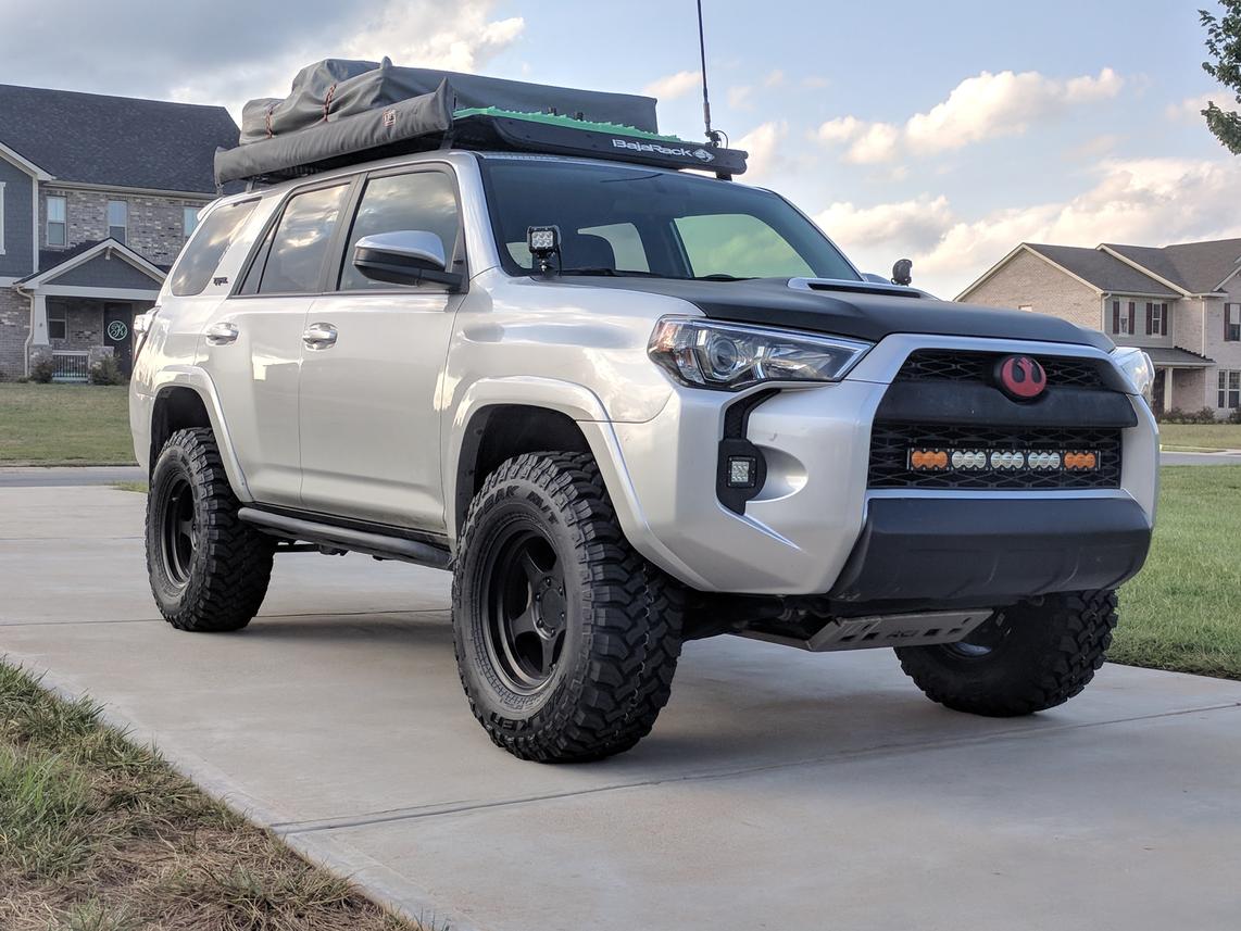

Hey guys!
I’m running some 295/70/17 Toyo R/Ts with SCS SR8 which have a -10mm offset.
Trimmed my front bumper at least an 1.5 in while moving the liner forward as well. Trimmed my front mud flap for clearance.
Hey guys!
What UCA's and lift height? I have SPC UPCs and a 3" Toytec Boss lift. I had to remove my mudflaps but no BMC. I would suspect 295's would require a BMC. I did also move the fender wells in and cut a small piece of front bumper.
Regarding 295's, I think 4.56 gearing would probably be a good idea although probably not a requirement. 305's you probably would want 4.56.
