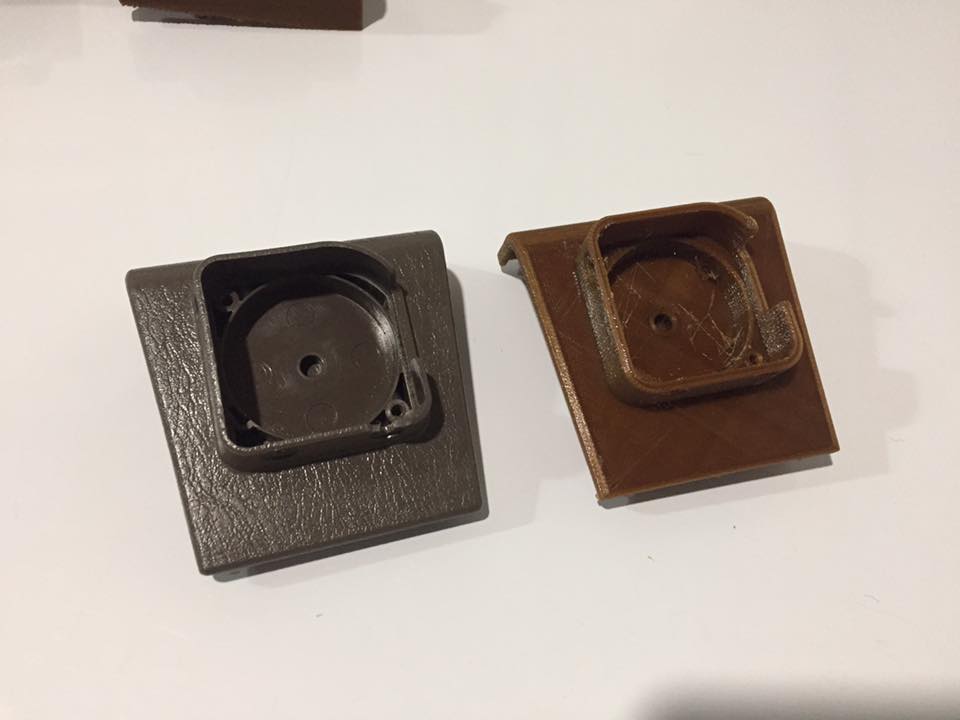

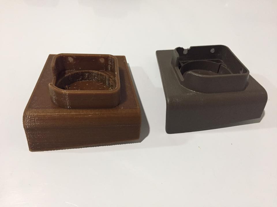

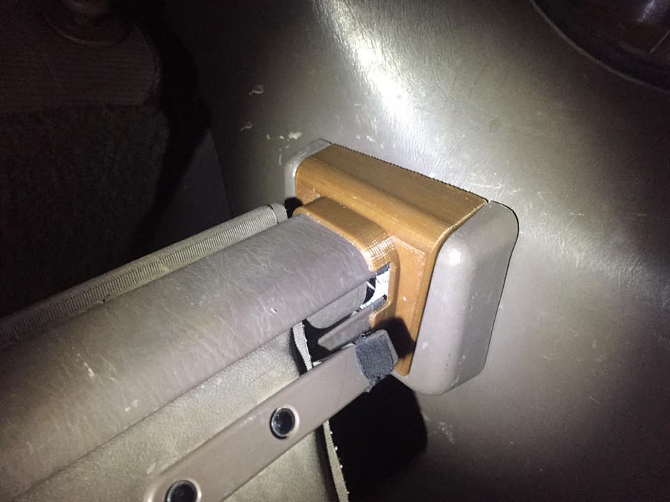

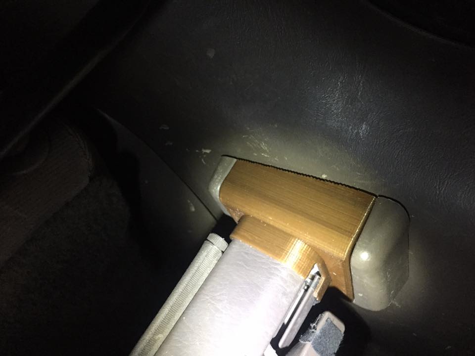

Decided to do something about my broken cargo cover ends. These things are apparently worth gold on eBay and broken stuff bothers me, so I set out to fix mine! You can't buy just the ends... I've tried!
I measured my good side up (was also chipped) and loaded some brown filament into my 3D printer. Took a couple tries to get the supports right as it's a complex print, but one 10 hour printing session later and voila!
Loading the spring sucked... safety glasses are a must! I reamed the pin hole as well and used some Teflon dry lube. Retracts as nice as the original!
I have some good plastic primer and SEM color match oak paint from Vinyl Pro. I'll prime and paint for an OEM finish when it warms up outside in a few weeks.
I'm pretty stoked. I just mirrored the print and am making the other side now.
Just thought I'd share!
