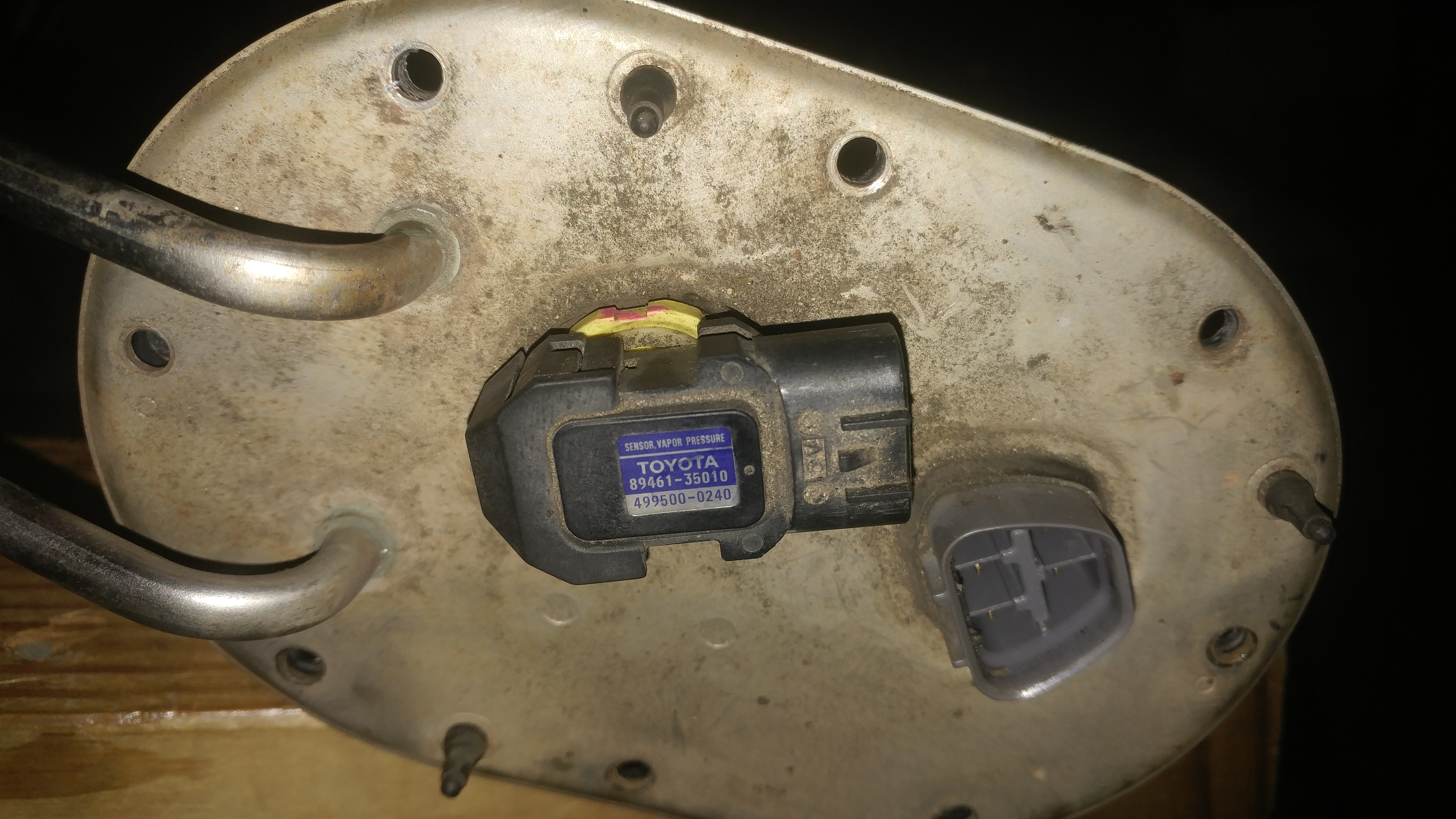

One thing to note! The Evap Sensor that is connected to the Fuel Suction Tube:
Is $200 from Toyota! BUT BUT BUT! If you buy the ENTIRE fuel suction assembly, you get it as part of the assembly!
So by buying the fuel suction assembly for $94, you get not just the metal structural piece but also:
NEW Evap sensor.
NEW Evap sensor gasket and yellow clip.
NEW electrical connection and gasket for the pump and sender connection.
NEW plastic fuel hoses and red clip.
NEW Fuel Suction Assembly Gasket.
IMHO, totally worth the $94.

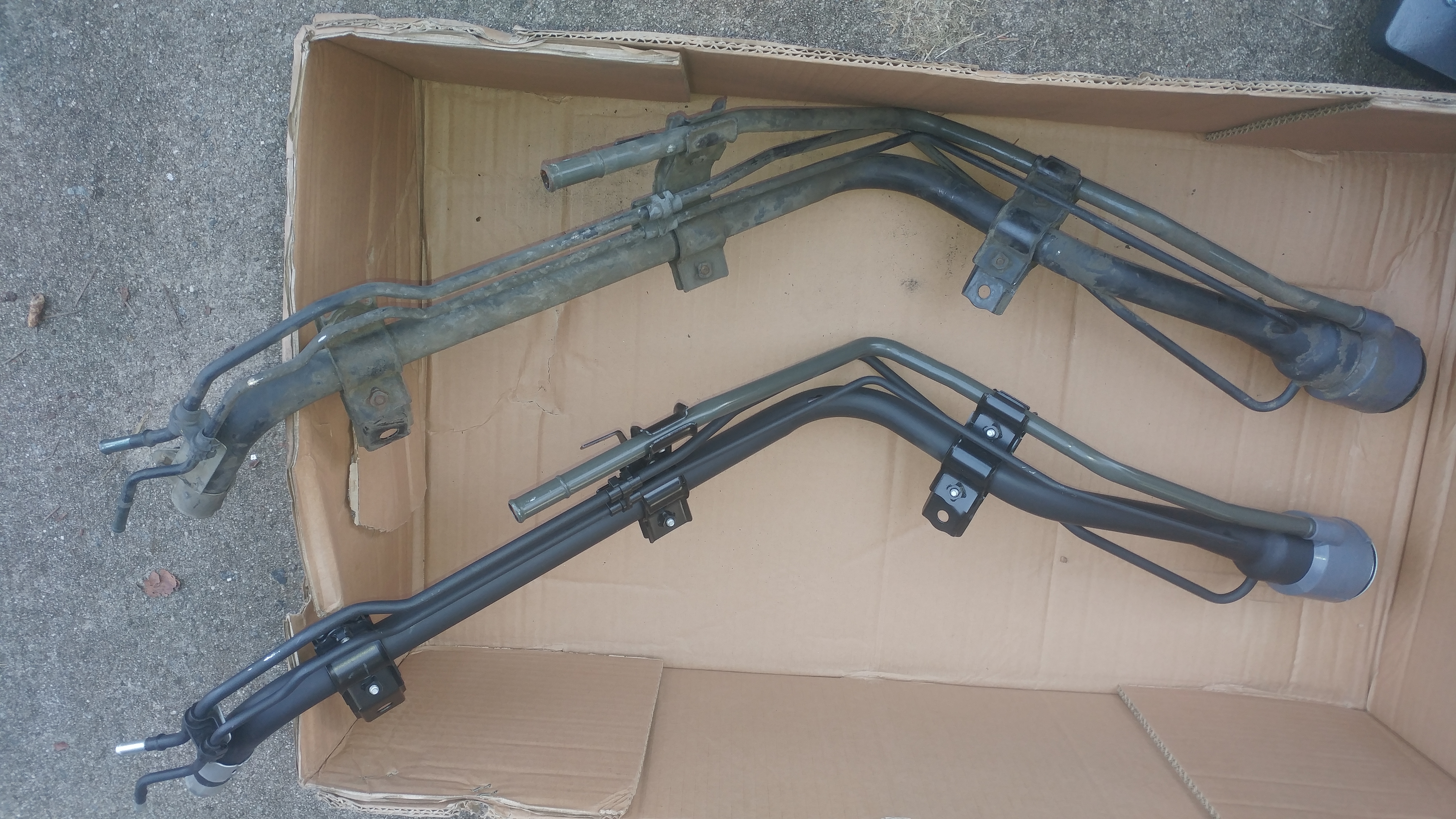

The filler tube was a different story.
It is mostly metal except for one piece near where the gas cap goes. I can't see it going bad, but maybe there could be some leakage where the green tube is pushed into the grey plastic (see picture). I would remove this unit from the car, inspect it for issues. Then remove that green tube, grease it with vacuum grease and reinsert. This is not super hard to change out if it winds up being the issue. Older 4runners I don't think have this or at least they have a few less tubes.
The other parts I bought that I didn't need was the fuel pocket and its two metal rings that hold it in place. Oh well. I thought it may need to seal something. The fuel pocket with new gas cap looks awesome though!
