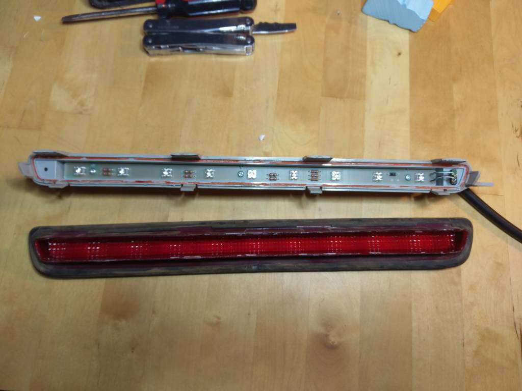

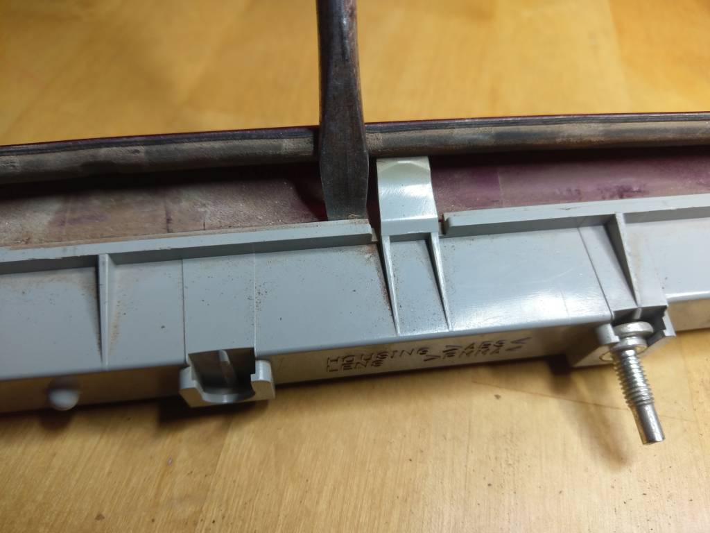

5) The hardest part of this repair is cracking open the light assembly without breaking the plastic. You have to separate the red transparent part from the grey base. I used a large flat head screwdriver to gently crack it open (just use the screw driver as a lever, no need to actually put it in the crack).

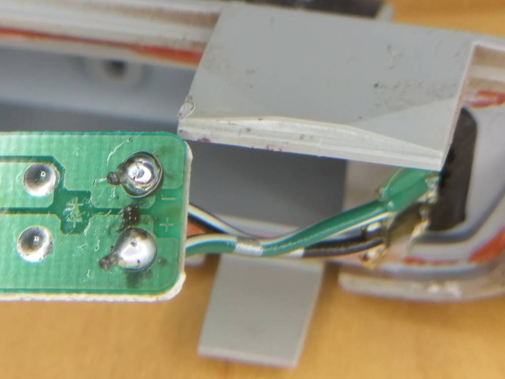

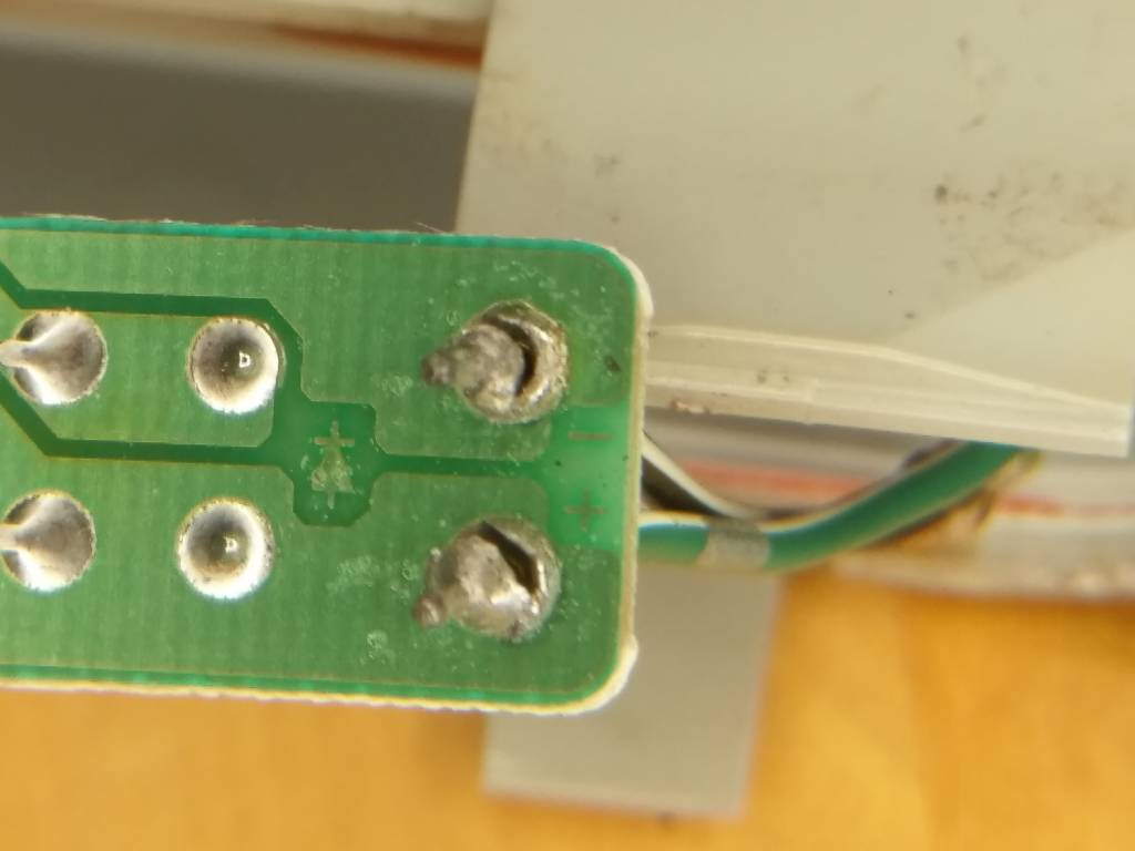

6) With the housing open take out the PCB with the LED lights. In my case both solder joints for the power cable were broken. I soldered them back on with some new solder.
7) Re-assemble the housing. I used superglue to glue it back together (probably won't be able to open it again, but I hope I don't have to)
