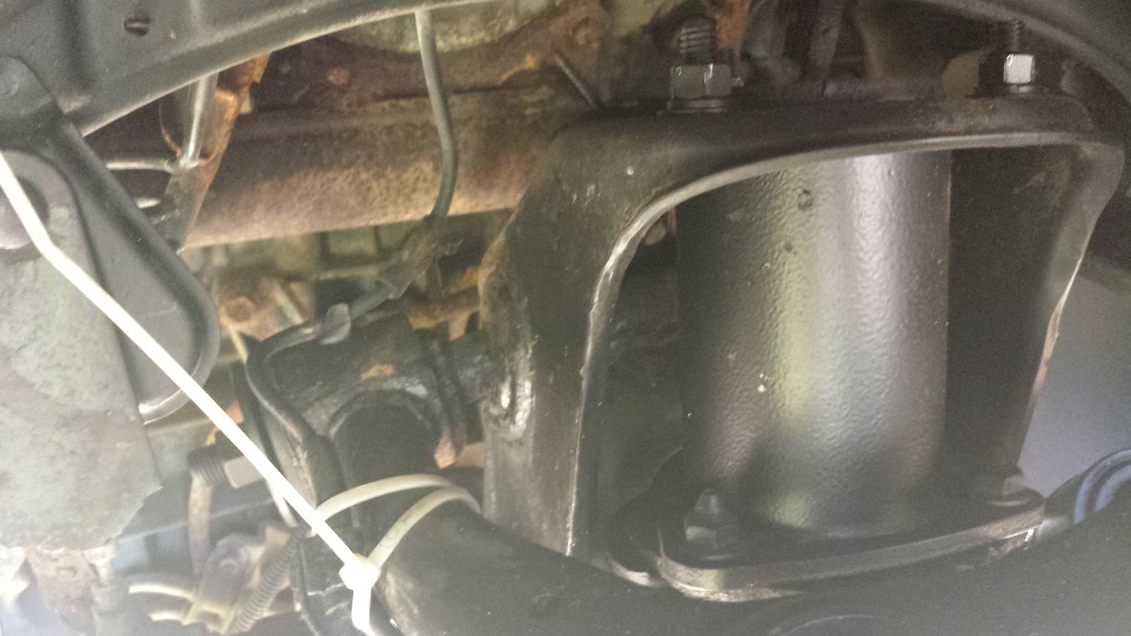

if you get a chance can you post a pic of the 6" spacer up front?
If you go on rough countrys site and search part number 770s there is a picture of the actual kit and you can downoad the instructions and see its a really simple install only trimming needed is the usual body mount and some minor fender and bumper trimming
20131015_164626.jpgthis is the spacer on top of the pass side strut veiw from on top of and behind tire looking toward the front

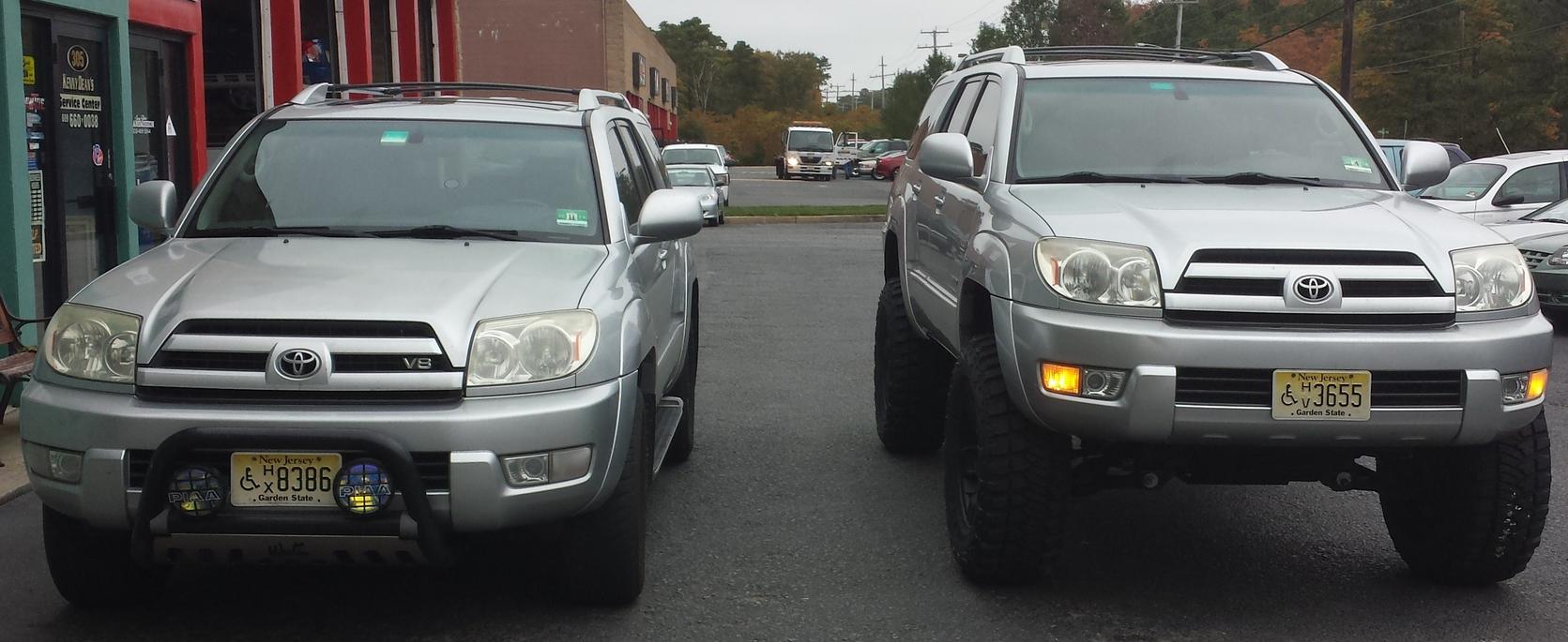

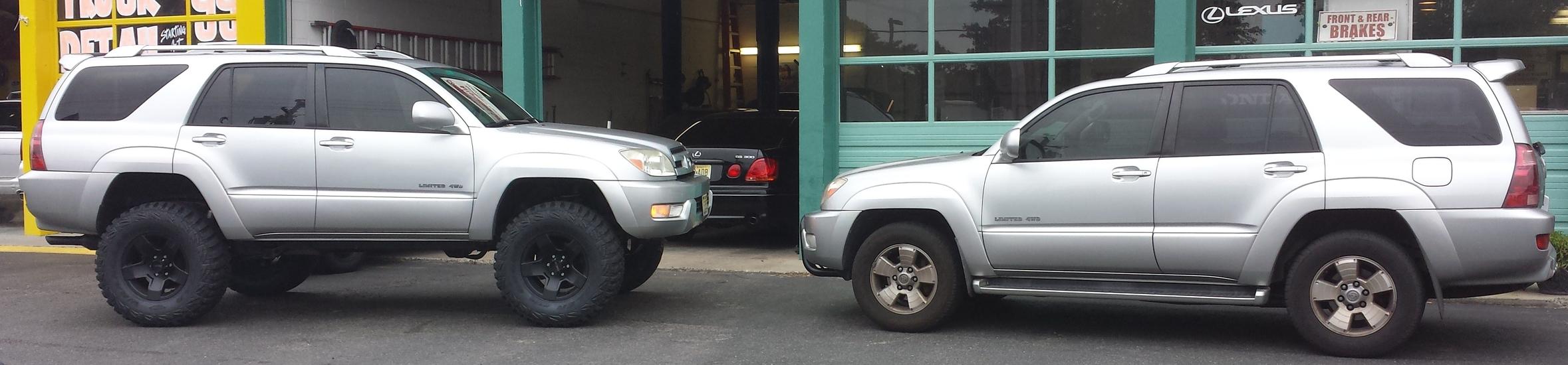

Itll see dirt for sure but we got no rocks or tough trails here in the pines and its my daily driver so she wont see too much whoopin. Def not a tar queen or a mcdonalds cruiser
[/ATTACH] my truck next to my wifes 03 v8 limited
