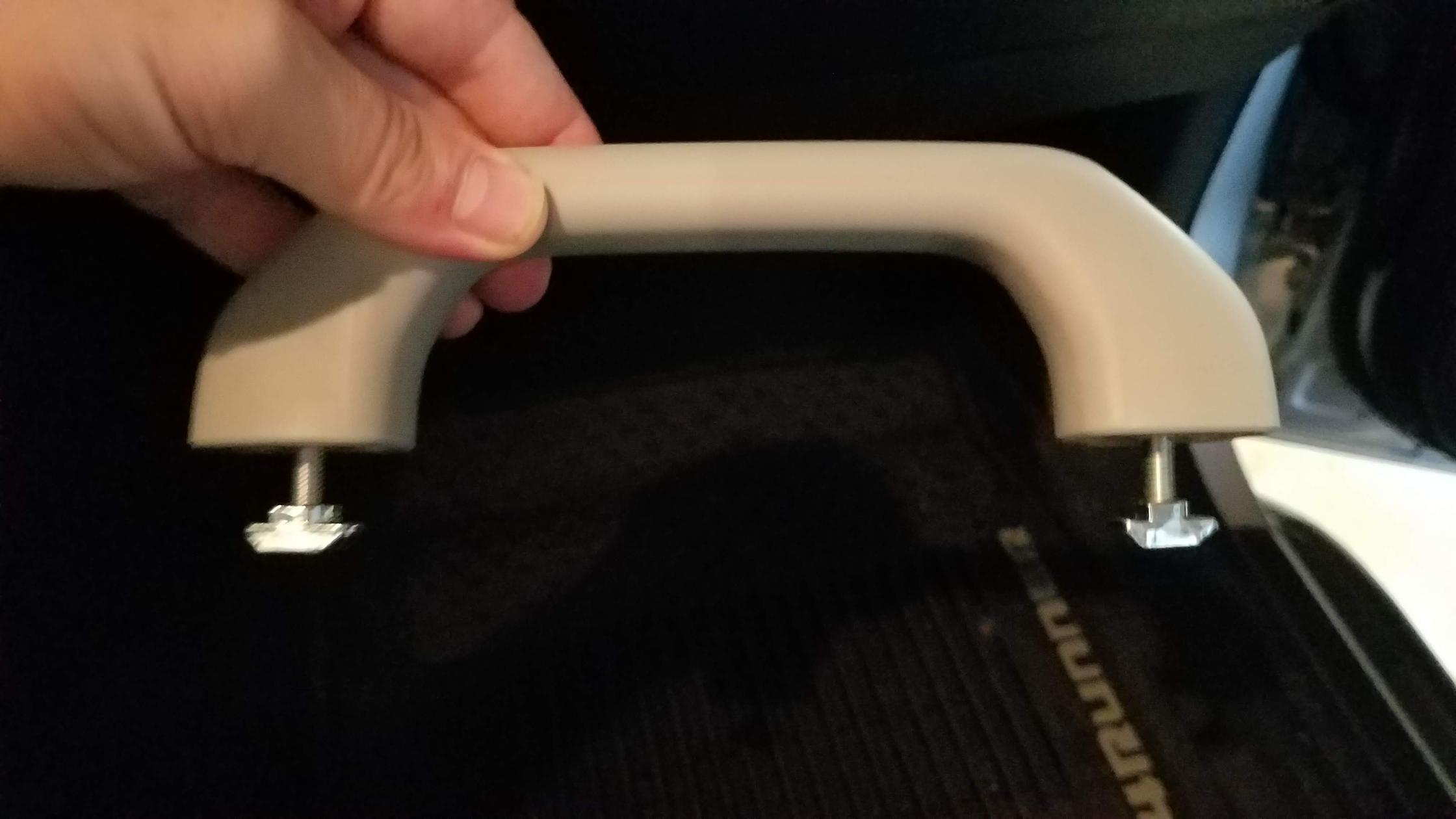

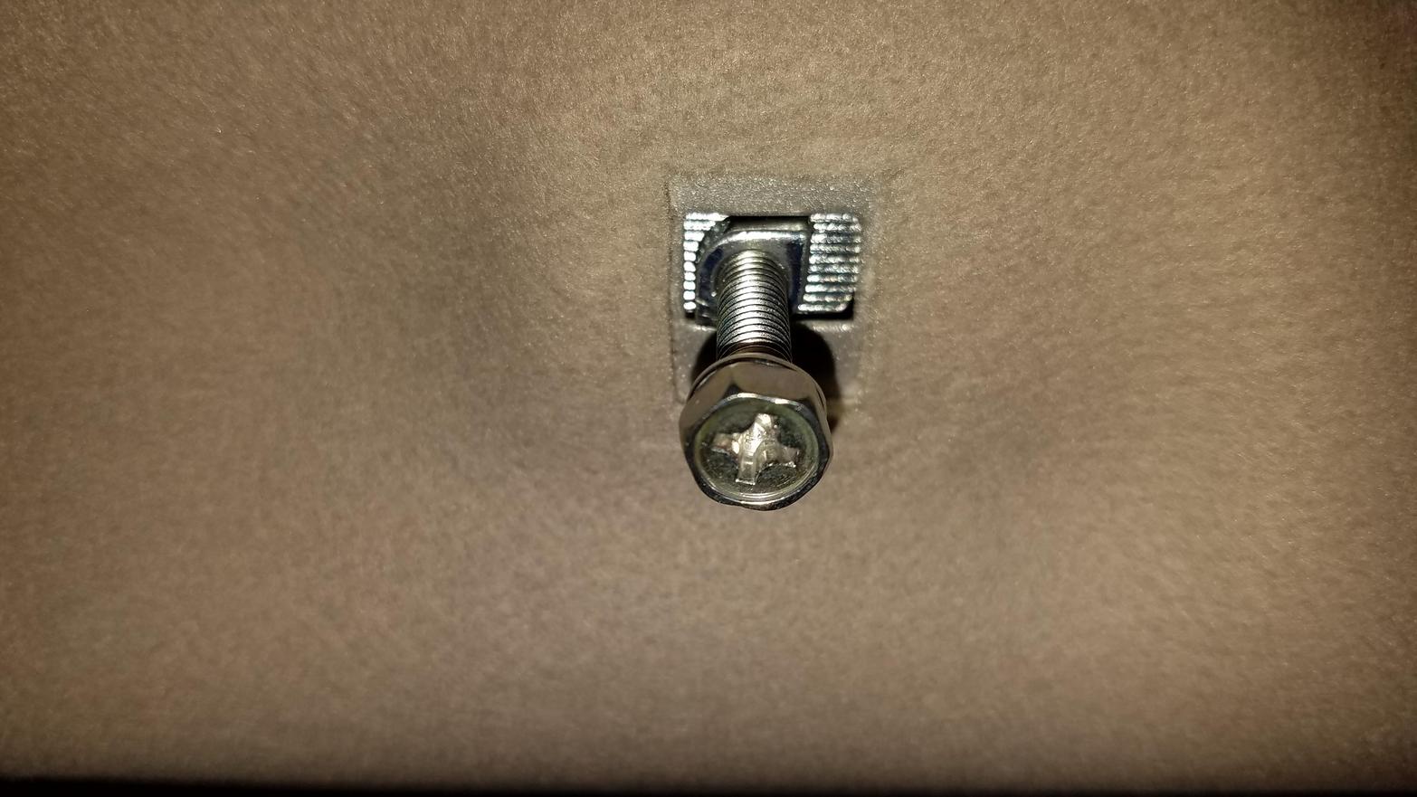

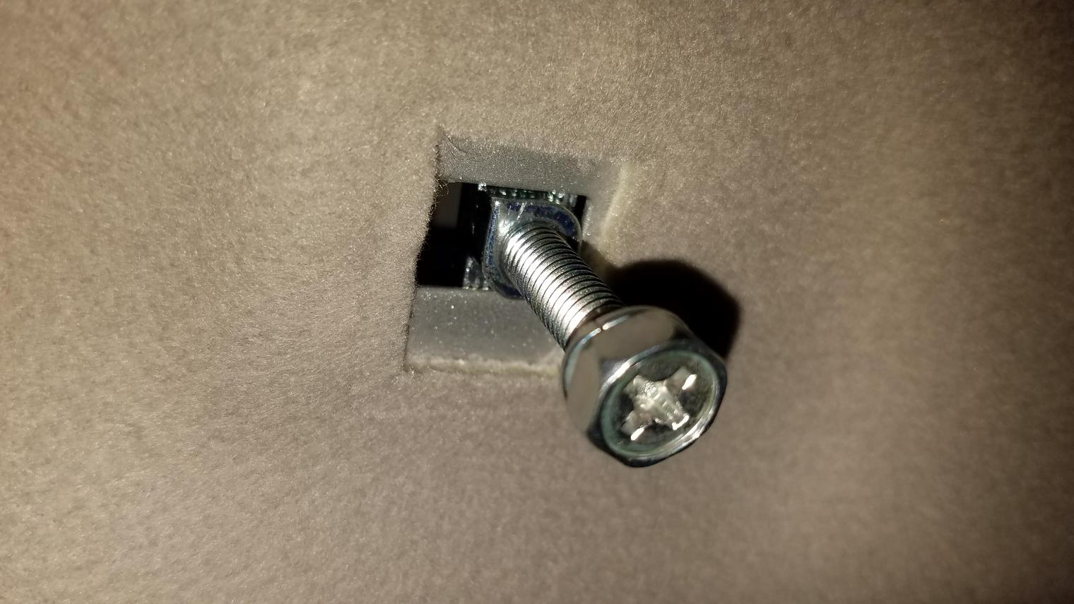

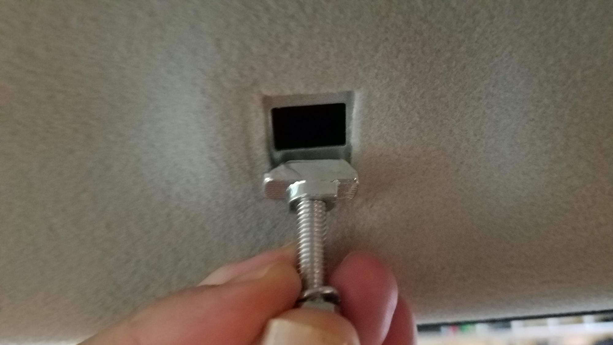

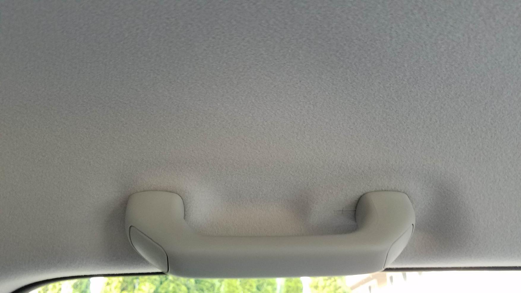

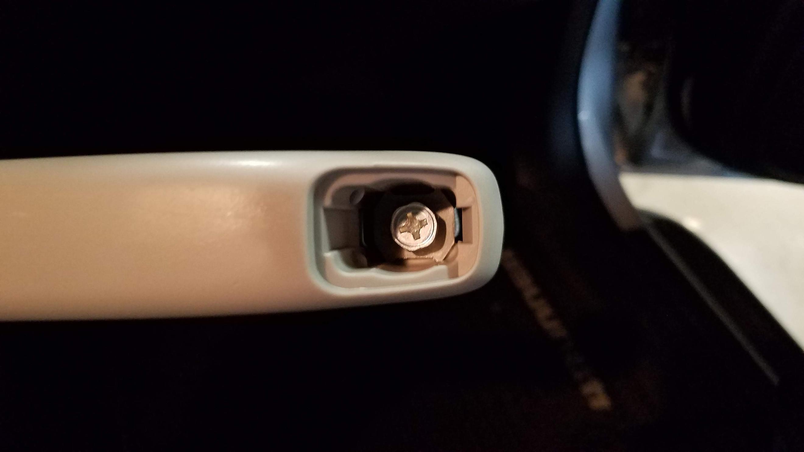

Thanks to [MENTION=103267]Saker[/MENTION] for coming up with this mod and sharing his work. I wanted to share my variation on the attachment method. I don't think it's any better or worse than saker's but gives an alternative especially if you don't have a rivnut gun.
When I removed the OEM t4r handles and test fit a rivnut in the square opening it hit me an 80/20 t-slot nut may fit. Tried a 45 series 8mm nut and it fit well. 8mm thread is too large to fit the bolt hole in the handle so I ordered 6mm 45 series t-slot nuts. 1/4 - 20 works too but the fj cruiser handles came w 6mm bolts. I like keeping it metric where possible.
The pics are mostly self explanatory how this goes together and how the t-slot nuts turn to lock in the square opening. It's a little finnicky getting both nuts into the square openings with the handle and bolts attached. Have patience and make sure you have a couple turns on the nuts so they don't back off and fall into the roof cavity. Keep tension on the bolt/nut by pulling down on the handle while you screw it in. Finish torquing with a 10mm deep well. I didn't get crazy... maybe 20 ft lbs. I used blue thread lock as well.
Some advantages to this method... 1. It's easily reversible if you want to go back to oem t4r handles- rivnut method would require you to remove rivnuts 2. You can adjust side to side placement of the handle during install.
Result? Seemingly strong but they need some miles and usage before proven out.

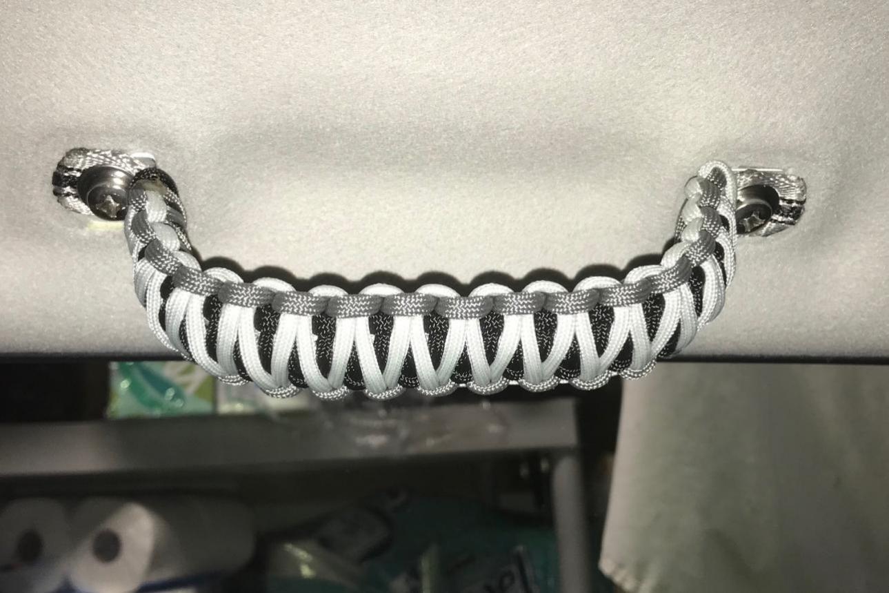

Does anyone have problems hitting head on these ?? ...as they stick out further than oem fold handles.
Yep. I loved the mod but since I set my driver seat at the highest position I kept bumping my head when looking out the window. So I made a paracord grab handle to soften the blow. I posted about it here:
https://www.toyota-4runner.org/3333091-post39358.html
The passenger side one is not a problem. I’m planning on modding the two rear handles with the Saker mod next.

[MENTION=103267]Saker[/MENTION]: Thanks for this post. I will definitely perform this modification. Trying to decide between the rivnut and t-nut methods. I raised an eyebrow at the idea of rivnuts set in square holes. But I’m also not enthusiastic about losing a t-nut in the body channel and having it rattling around for the next 10 years.
Would you say the rivnuts have remained tight and sturdy over time?
On my 2014 I used rivnuts as described.
It was more of a task than using TNuts.
The rivnuts stayed secure until I totaled my 2024 T4R.
So on my 2022, I decided to use the TNut method.
IIRC, one can place the bolt thru the handle and the TNut on the bolt, turn the TNut so it can be inserted thru the opening, turn TNut to the desired position and tighten bolt.
