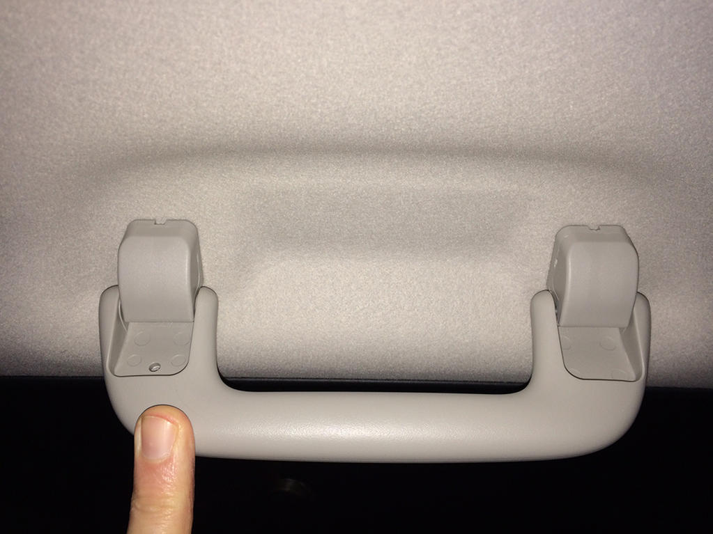

The closest measurement I can get from the Grip handles on my 14 T4R is 6 1/4".
Also, since there is an indentation of the headliner there, wondering if this will be an issue if the bolt pattern is correct.

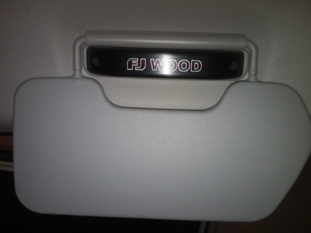

Second pic... found on the net of FJ with the visor down, appears the location is higher on the FJ as well...
Someone with a FJ that has them, can you take a quick measurement center to center of the bolts that hold your side grip handles on?
I popped the caps of and did a rough measurement, did not remove the handle/shade assembly. It is approximately 6.25 inches. Same as your measurement.

The visors are here. I'll take some pics later. My first impressions are:
They are larger than I expected. Since there is no indentation in the headliner, they take precious headroom. This might be overcome with a heat gun.
There is a gap at the top of the visor, probably for some kind of clearance. This makes them useless at my eye level.
They did not come with the grab bars, but the holes line up fine. Two alignment tabs in the back of the mounting plate will need to be cut off.
