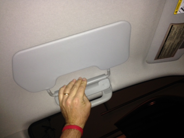

The first pic demonstrates that the holes line up.

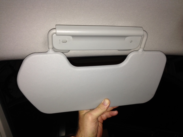

The second pic demonstrates the large gap, for viewing the sun.

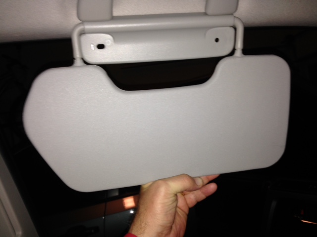

The third pic shows it "stowed". May be fine if headroom is no issue, and you don't have a sunroof.
My first mod. Fail. Going to FJ website to sell these soon.

Rejected

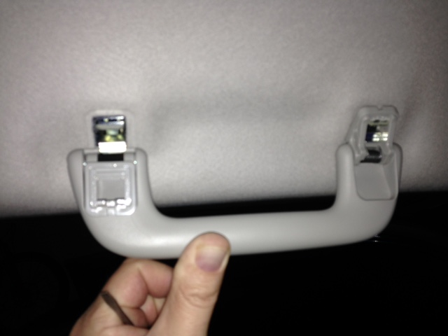

I figured I would just mount one to see. Did not work.
The sissy bar mounting holes line up fine. But the grip mounts with clips, not bolts. It may work with the visor OR the grip, but not both.
So, back in bush, when you're hanging on tight, try not to remember the clips. They are forshit.

If you flip just the visor and not the whole thing, does it then cover the gap? And is it low enough still to work.
Seems workable but I'm only looking at pics of course :)
Good effort, OP. Too bad it didn't work out. Would've been a neat mod. I didn't even consider the headroom angle, and the fact that the FJ's headliner is probably molded so these will fit.
Never mind my question... I just saw how these work and you can't just flip the visor down, the whole assembly is one piece.
I was able to remove the side grip handle on my T4R today and found there is no nut fixture as is on the FJ Cruisers to attach the FJ handles.
If there were nuts behind the clips, we could use the FJ handles and visors.....
So this is definitely a no go.

Yes, I have. When the stock handle is removed, all that is left is two square holes in the headliner and the body.
Correct, I haven't installed either. At the time, I though the old grey gx470/4Runner overhead handles where a better match than the FJ ones so I didn't even measure the FJ handles.
