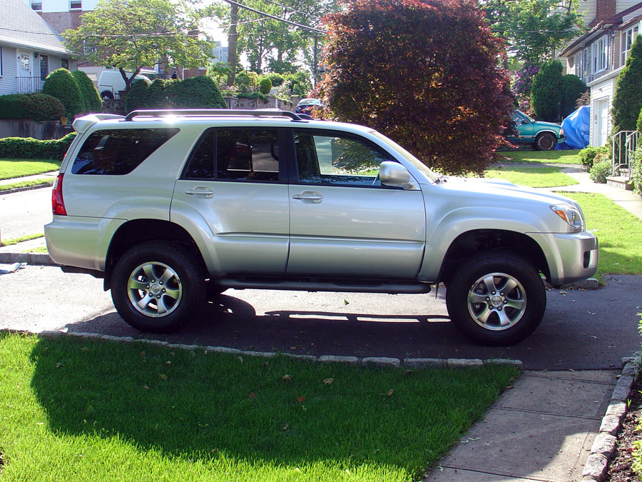

Well I finally had a chance to work on my FJ Swap as I picked up a set of 4 springs about 6 months ago. I also picked up a 10mm OME trim packer to try to level out the 1/2" lean on the driver side.
Rear installation went very smooth. One hour per side. Gained just about 3/4" lift on top of the 1.5" from my DS Spacers. The trim packer did not reduce the side to side variance at all for some reason.

Here is a quick pic of the rear only install. Updated write up on my site.

On the rear spacer, it actually lifts both sides since the coils are near the center of the axle and not out by the tires. People are using a single 1.5" spacer on the driver side and it comes out very close. A larger spacer will be required to correct the lean.

Re: the rear spacer...understood, thanks. Looks like I will have to live with the lean.
