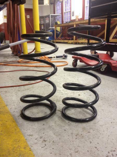

Side by Side
5th Gen vs. FJ TT
Rear spring comparison shot... Stock material is thicker by 1/32 of an inch, slightly taller with an extra coil netting 1" lift height and stiffer Kn.

5th Gen vs. FJ TT
Weird. I guess the 5th gen is supposed to be on the left? What years were involved there?
This is a pic of 2013 5th gen SR5 rear springs. An extra coil compared to the 5th gen springs in your pic, just like the FJ springs.

Just confirming that the FJ are slightly thicker and taller than the 5th gen rear springs.

I'm trading in my 4runner. Don't worry, I'm getting another. Don't ask why, I'm silly. But regardless, I'm pulling my mods off and getting her as close to stock as make sense. So I did the FJ spring swap maybe 7k mi ago. I also had a 3/4 in spacer in the rear so I decided to pull that and my FJ springs to bring over to my new 4runner when I get it. I couldn't find any stock springs, but got a stock set of rear coils from a 2016 TEP. I was going to swap in the 5th gen springs and keep the FJ, because the data isn't really there on the FJ springs.
Well, much to my surprise, the 5th Gen springs are taller. I know that may be deceiving over performance.But regardless, I ended up leaving the FJ springs in there and keeping the 5th Gen Springs. Thought I would share since I was so surprised.
FJ is on the L, 5th Gen on the right. Cleaner one is the 5th Gen

JB, did you put 5th gen springs front and back? I put FJ springs, although I can't guarantee they were FJ springs, on one of my 2007 4Runners and I got a little lift from them. Can't remember exactly how much. Maybe 3/4 of an inch. I also replaced all four shocks with KYB OEM style shocks. This one rides a hair stiffer, but in a good way, than my other 2007 4Runner with stock springs and the same KYB shocks.
Yes, front and back. Got between 3/4 and 1inch of lift in front, and between 1/2 and 3/4 in the back. Old springs had 115,000 very hard miles on them.
