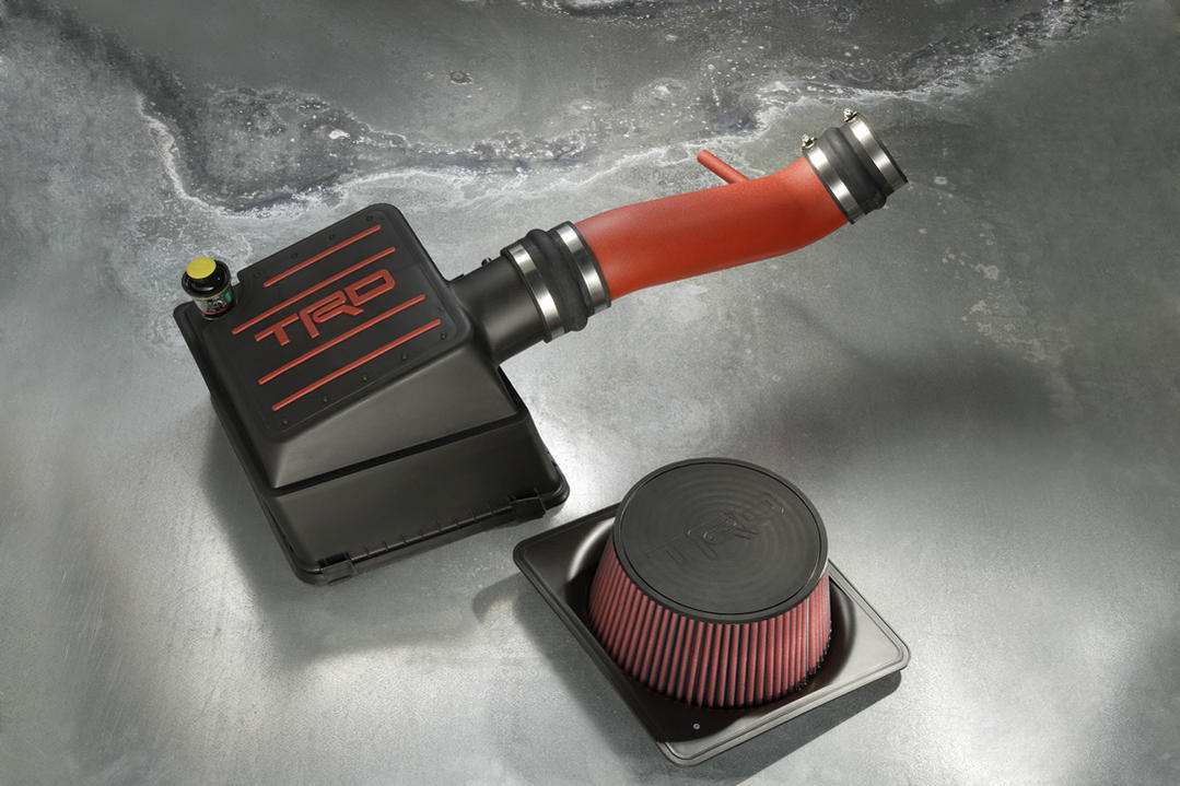

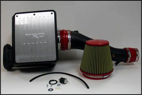

What kind of trd intake is it? is it the gen 1 with the conical filter or the one that has the GM style filter? if its a gen 1 it'll fit with no problem if its a gen 2 I wouldn't even consider it. for some reason it causes the MAF to be way off and cause lean engine codes. if your really looking for an intake get the afe intake or a gen 1 trd intake.
Really? Thanks for the info, thats good to know that they made a TRD intake that throws codes ha ha.
As far as which intake it is i'm not sure, i havent seen it yet. Do both generations have the airbox covering the filter or is that only the 2nd gen one?
I really think it was stupid of TRD to make the new design. the only difference is that the gen 2 is CARB approved while the gen 1 isn't. If you want to know more I would talk to Gadget at URD. He really knows his toyota stuff. The one with the silver top is the gen 1 and is the one you want. the black one is the gen 2 and is the one you DONT want. Even techs at some toyota dealers are having problems with the new intake.

Gen 1 looks a lot nicer too, thanks guys for the pics and info, i will let you know what i find out for sure.
