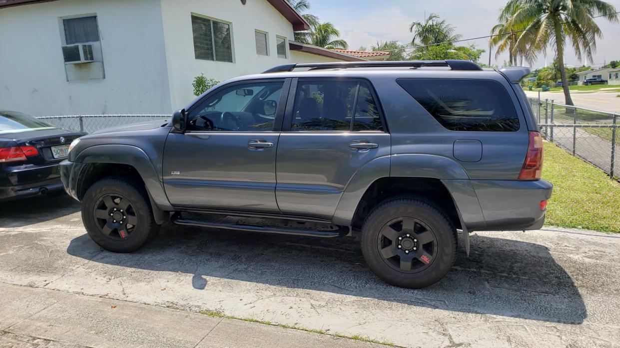

I have a 05, SR5 2wd, with FJ Cruiser TRD wheels and the tracking, handling, steering feels unstable, I've had it aligned twice and it still doesnt feel centered, i have new struts and rear shocks, installed and it sometimes pulls left, sometimes right, just feels a bit squirrely
Tires 265/65/17
Any advice or suggestions would be gladly appreciated

Did they happen to provide the alignment numbers? Not all shops are created equal.
