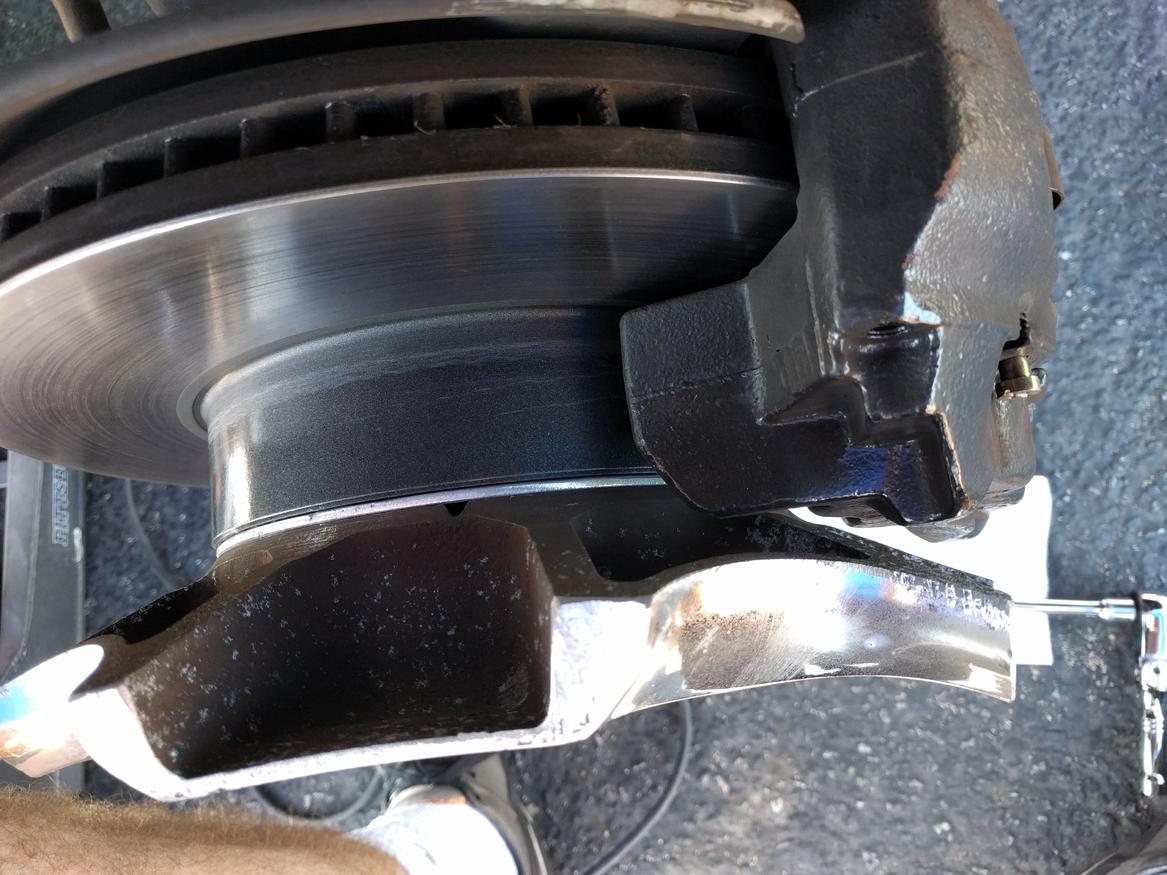

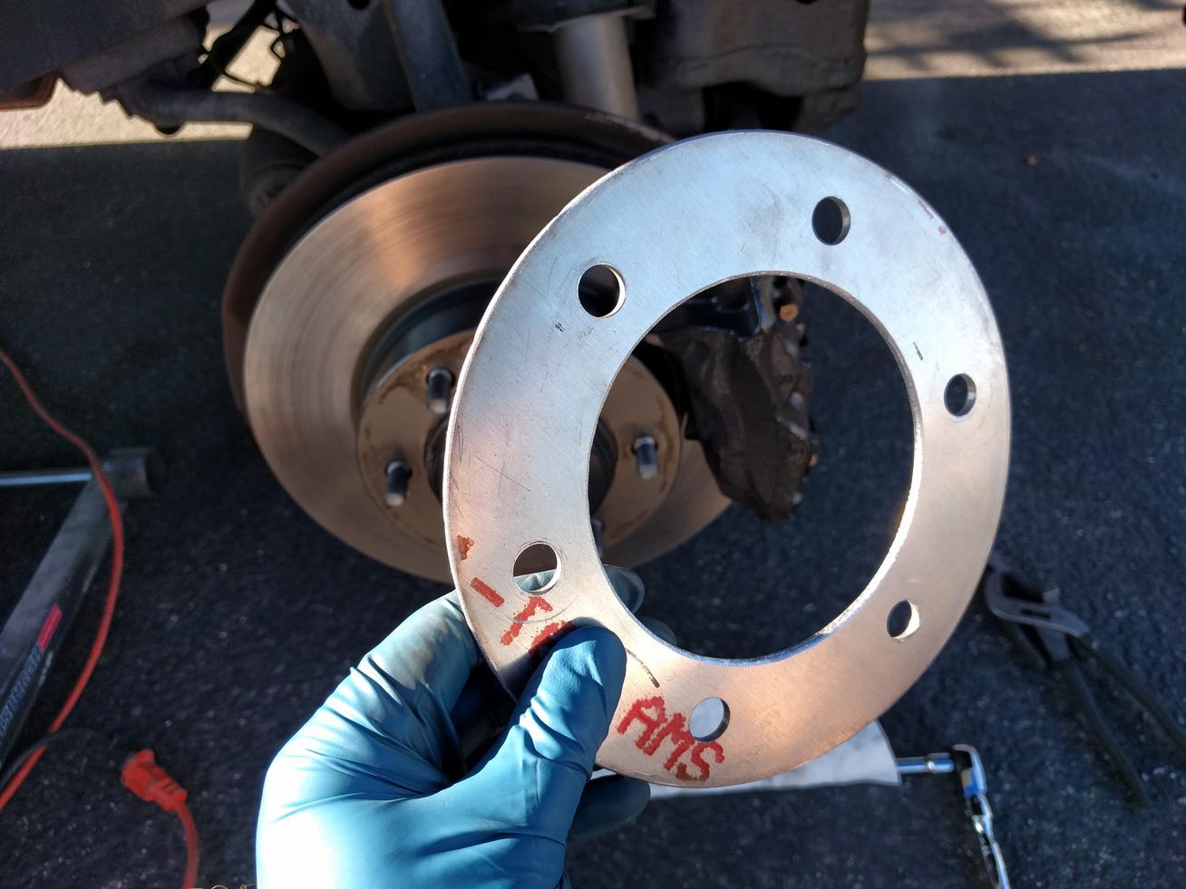

Bumping an old thread, but this might help somebody. I've got the 199mm Tundra brakes and had to make my own 1/8" spacers to make it work. Had a bent FJ-80 wheel, and cut off the hoop to check the clearance. The 1/8" spacer was enough to clear the piston pots, but I still had to grind a bit off the stone deflector fin. Definitely do NOT grind the pots, that's nuts IMHO.
