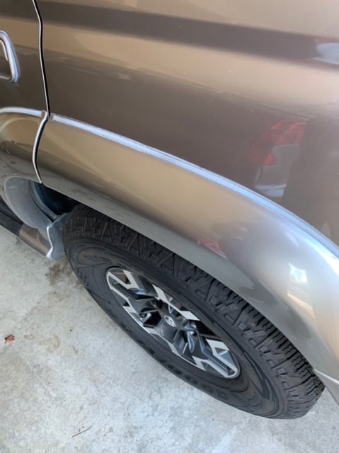

Do the fender flares need to come off in order to replace the trim strip? Parts fiche calls them "flare pads."
Thanks. So...I'll also need to order a bunch of clips if I pull the flares...? The clips are prone to breaking I suppose.
For sure you'll break some, much easier not worrying about it.
I bought mine from .clipsandfasteners.com much cheaper than dealer.
Would you happen to know the part number or description from their site?
Red 90904-67037
Blue 90904-67036 label said for 2001 and later check if correct for your MY.
Both numbers are Toyota numbers in Clips and Fasteners description of part.
What I do is look at Toyota web site for number then go to C&F site.
