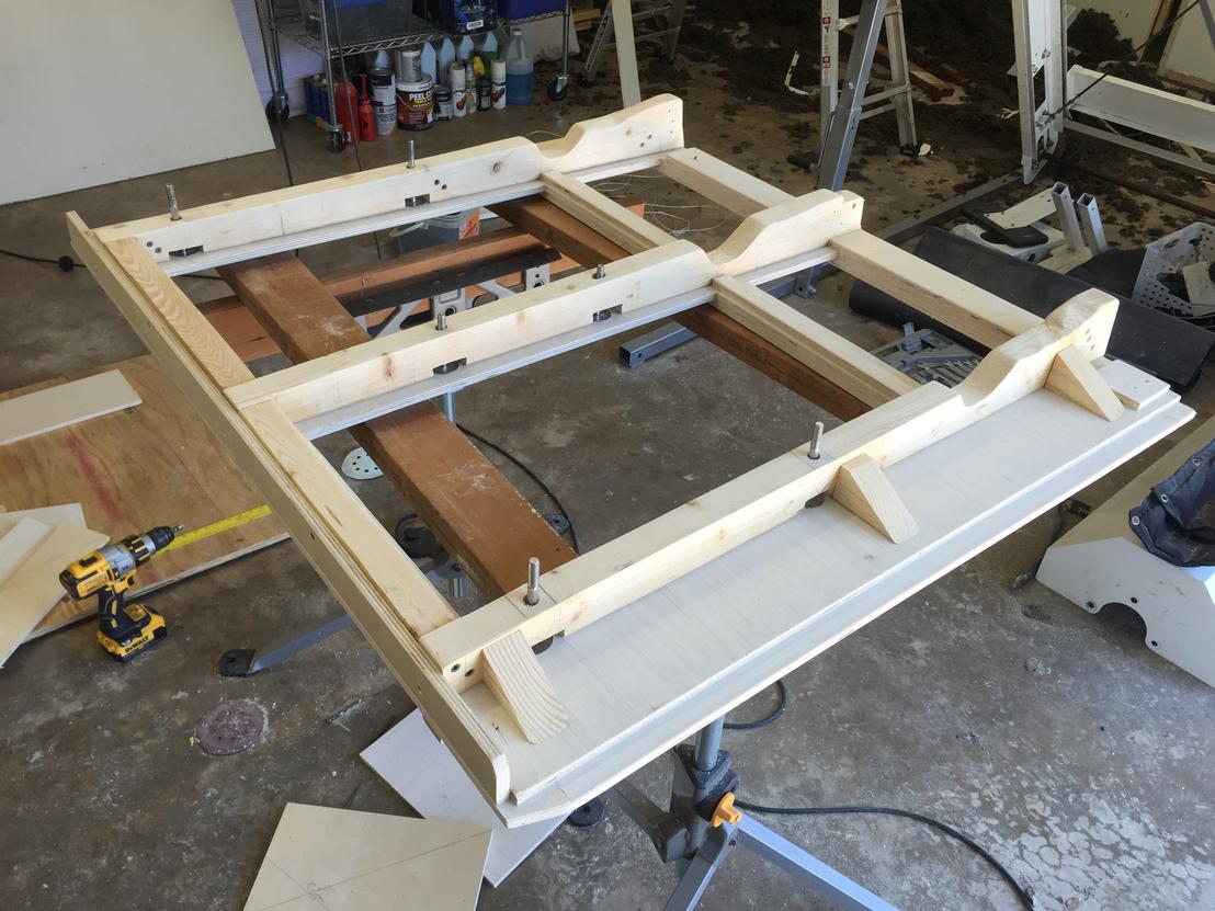

if you look closely in this image
you can see that there are two layers of ply. So there are the 2x4 that are through bolted to the truck body. On top of that there is a plywood base that is almost a half sheet of plywood with the holes for the doors cut out. Then there is a second layer of ply on top of that that is the doors and the material surrounding the doors. The tie down alumininum rails are screwed through 1 layer of ply and the 2x4.

No problem. I did hate to give up that space on the side. I placed the 2x4 over the body reinforcement plates for secure bolting. I originally planned to have them at the far edges of the area but felt 1 layer of sheet metal might tear out in a crash. With my placement of the 2x4 it made the usable space on the sides minimal since it starts to roll up toward the wheel well.
